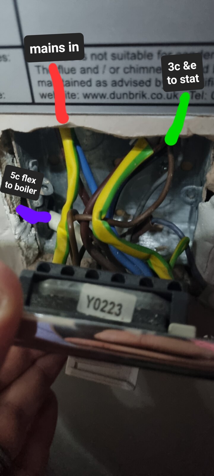

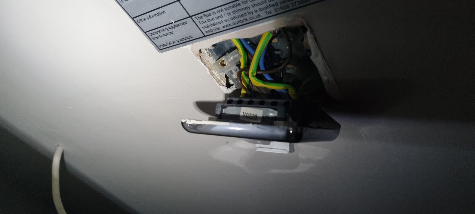

So quick update, had a gander behind the stat (again) and the fused spur.
S***t show of cabling but I've got a good handle on what's where now.
Stat - has 3c & e from fused spur, where behind the wall socket it picks up the t3 and t4 connections on boiler side.
Fused Spur - mains in top left, boiler out bottom left and stat 3c&e top right.
Plan currently would be
1. disconnect the grey/black from 5c from boiler from the term blocks and the 3c&e to stat completely from the spur, therefore enabling me to remove stat with no live down in the junction.
2. Trim grey/black back to white cover boiler side and also in the spur wall cavity as cables now redundant.
3. New 5c flex from boiler L,N,E & t3,t4 out to Hive receiver.
This would enable fused spur to kill boiler and hive if ever sliced/cut by accident.
Thoughts on that approach? @CBW @ianmcd

Hive all installed on wall with fresh piece of 5C cable.
Just waiting for next opportunity for power off to wire into boiler and also adapt the fused spur as above.
