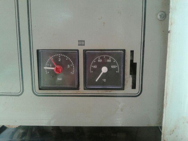

I have a vaillant bolier about 15 years old it currently is giving out intermittent hot water. There is a pressure and temp gauge see picture attached....does this hight a problem.
Would be grateful or any advice or comments
Many thanks for your help and time
Regards
Mike
Boiler should still work ok with that pressure.
Problem more ikely to be with the water section diaphragm....do a search.
