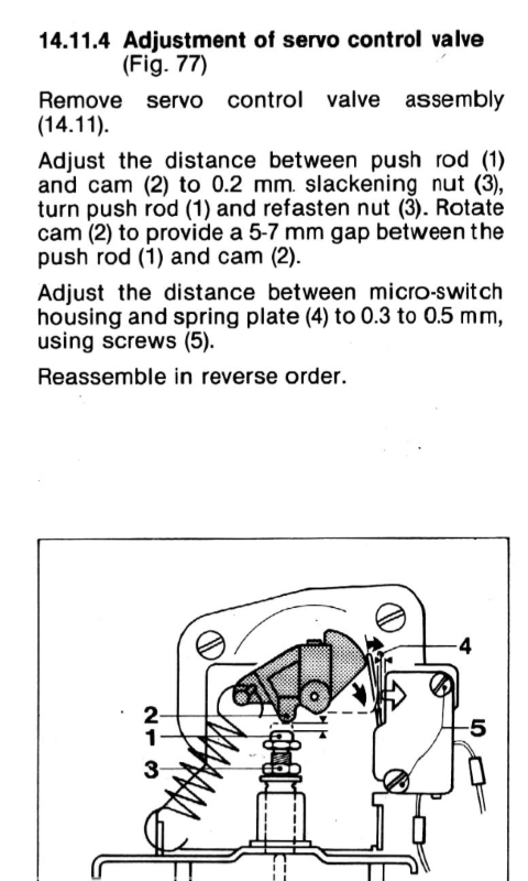

While I am waiting for the diaphragm, I thought I would check the operation and adjustment of the pushrod. Now, I may be a bit dense, but I don't get these instructions in the manual. (See screenshot). The first part is fine, about adjusting the push rod gap by slackening the nut. It's the second bit about rotating the cam to provide a 5-7mm gap I don't get. If you rotate the cam it just gets pulled back by the spring! Is there something I'm missing??

1. With cam at rest (parking position) set push rod gap at 0.2"mm then fasten rod locknut.
2. Slacken screws (5) so that micro-switch is slightly loosened.
3. Now turn cam clockwise (per diagram) so that the 0.2mm gap that you have just set becomes wider to between 5-7mm gap (hold it in this position) then...
4. Gently turn the micro-switch body until the gap between the body and switch plate is about 0.4mm and secure the micro-switch in this, which will now be the activated position when ever the diaphragm lifts.
5. You can now re-check the operation of the spindle movement by pushing the spindle from below and confirm measurements.
Good luck
Thanks, that is much clearer than the manual. You should have written it!
