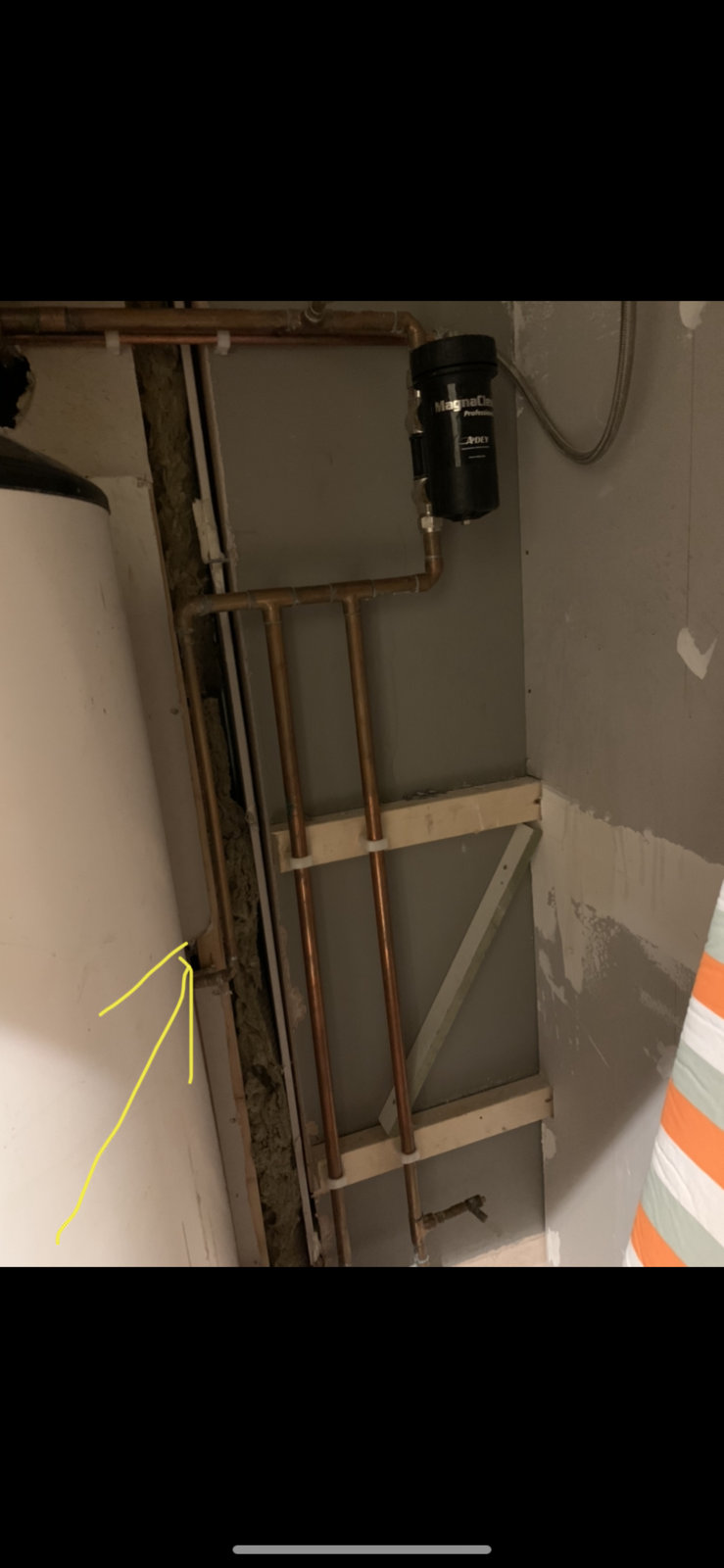

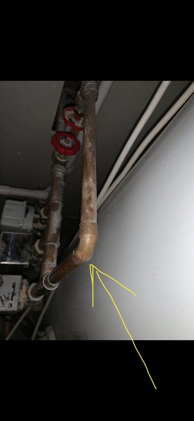

On my boiler the hot water comes out of the boiler and goes to the top of my zone valves/actuators that feed the following
1) downstairs heating
2) Upstairs heating
3) Hotwater
But there is also what I would say is a bypass line that goes back to the inlet of the magnaclean on the boiler return. So when the zone valves are closed the water has somewhere to go.
But is this in the correct place?
To me that pipe will always have 75 degrees water going back on to the return of the boiler. Only when the zone valves open up will the supply water go to the radiators and the tank and then come back up the return to the magnaclean and mix with the bypass line (that is already 75'C) but this doesn't seem correct to me because this pipework coming from the top of the zone valves is from the supply so will be giving it a false load/reading on the return
To me I can understand this bypass line being there when the zone valves are shut but when they are open, you would want the boiler to sense the water coming back from the radiators so that it can ramp up the pump or increase the flame but will the supply going directly into the return something just doesn't add up.
Can anyone advise?
Get some photos and post them up. a bypass line would have a bypass valve on it which stops the water "bypassing" when the zone valves are open

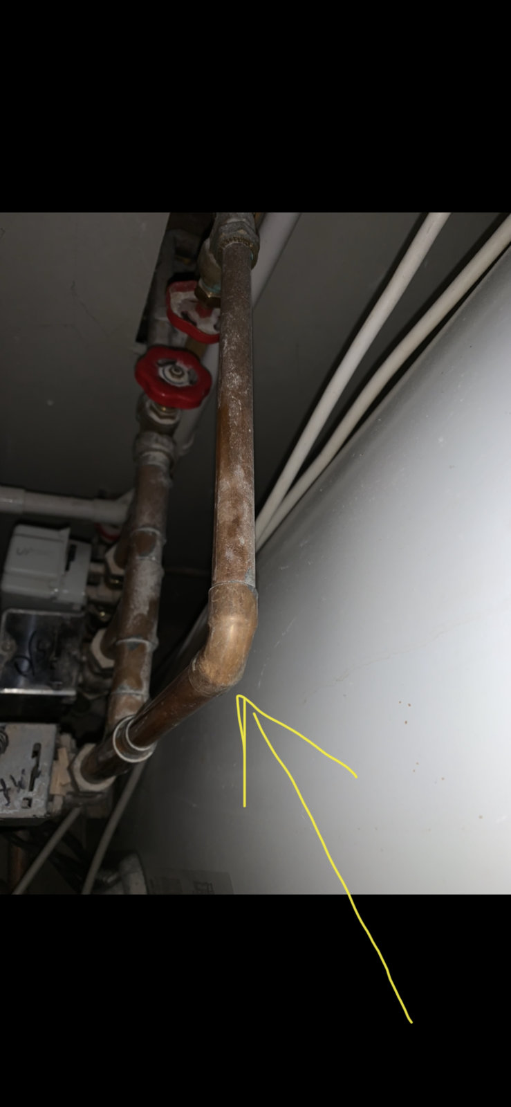

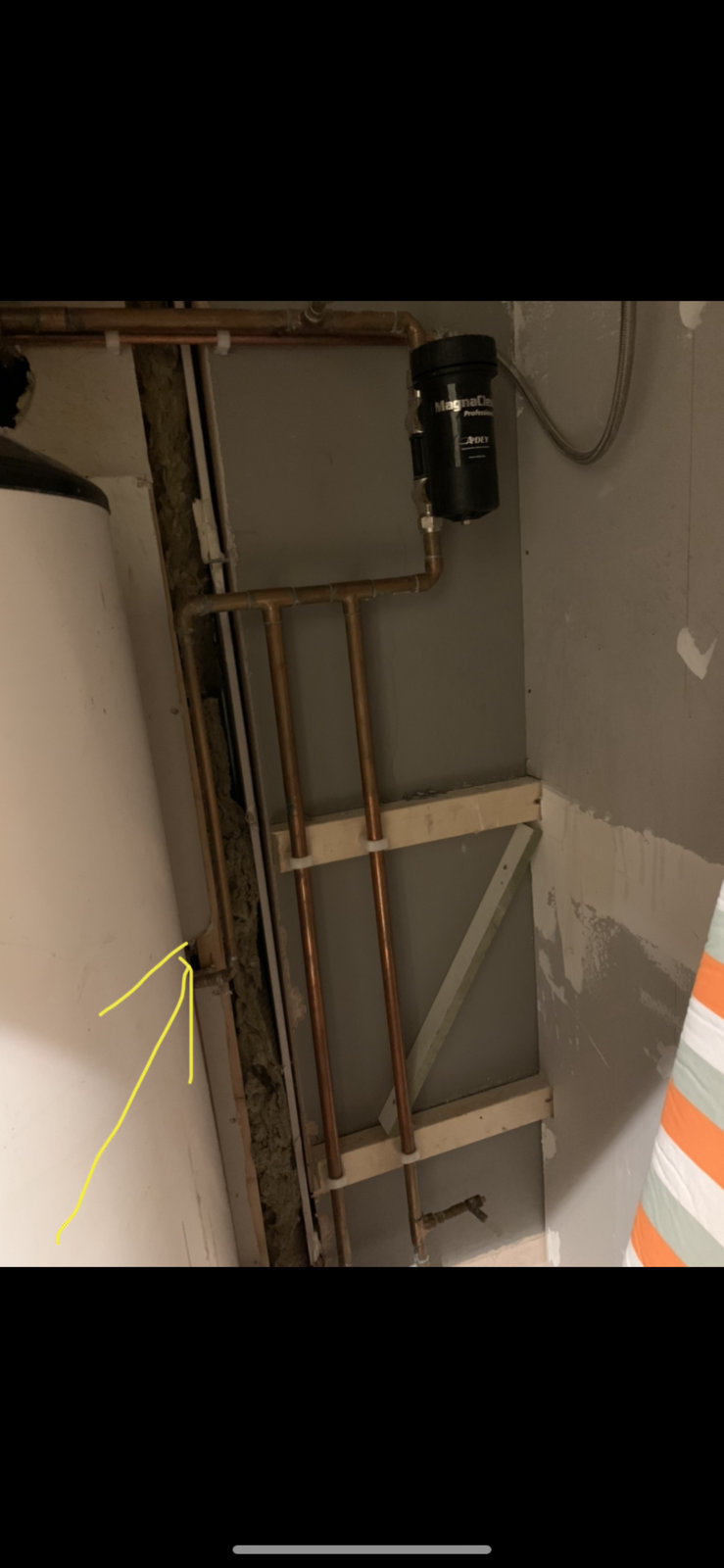

Ive attached 2 images.
So on the image that shows the zone valve, the 22mm going onto the top of the valves is the supply from the boiler.
On this photo you will also see the other pipe the 'bypass' (marked with a yellow arrow) this has a gate valve on it that is fully open and goes back to the inlet of the magnaclean on the return as per the second pic.
There will always be 75'C going onto the magnaclean return to the boiler as far as I can tell unless i'm missing something?
The other 2 pipes going onto the magnaclean return are the upstairs and downstairs radiator circuits.

it shouldnt be there in the first place. Might find that will help the circulation round the system a tad :D;)
Yes that was my thinking but if I close the gate valve and the boiler is on. Where will the water go? Or would it trip on a high pressure fault?
Where its supposed to "the radiators"
Boilers got a built in bypass (and a good one on these boilers) it wont over heat or damage its self)

Close the gate valve fully, that pipe is not supposed to be there in the first place if its linking the flow and return pipes
Appreciate the help. I'll try closing it and see what effect it has on the radiators. The temps have never gotten above 48'C so far.
So ive closed the valve on the 'bypass line' and just had zone valve 1 open - which is for the downstairs rads only.
The temps is about 10% better but the rads are still only about 51'C max, with a flow temp of 75'C.
