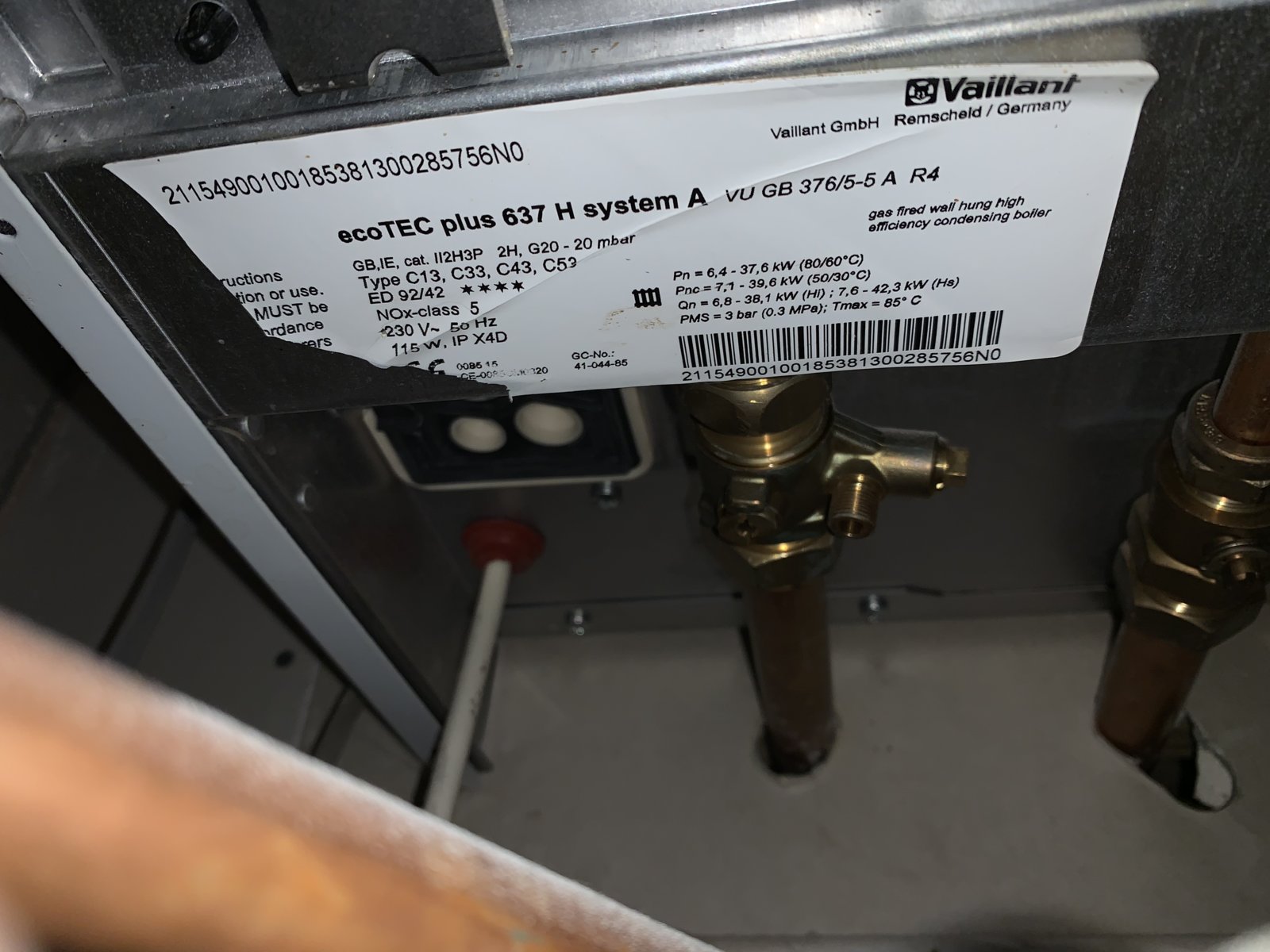

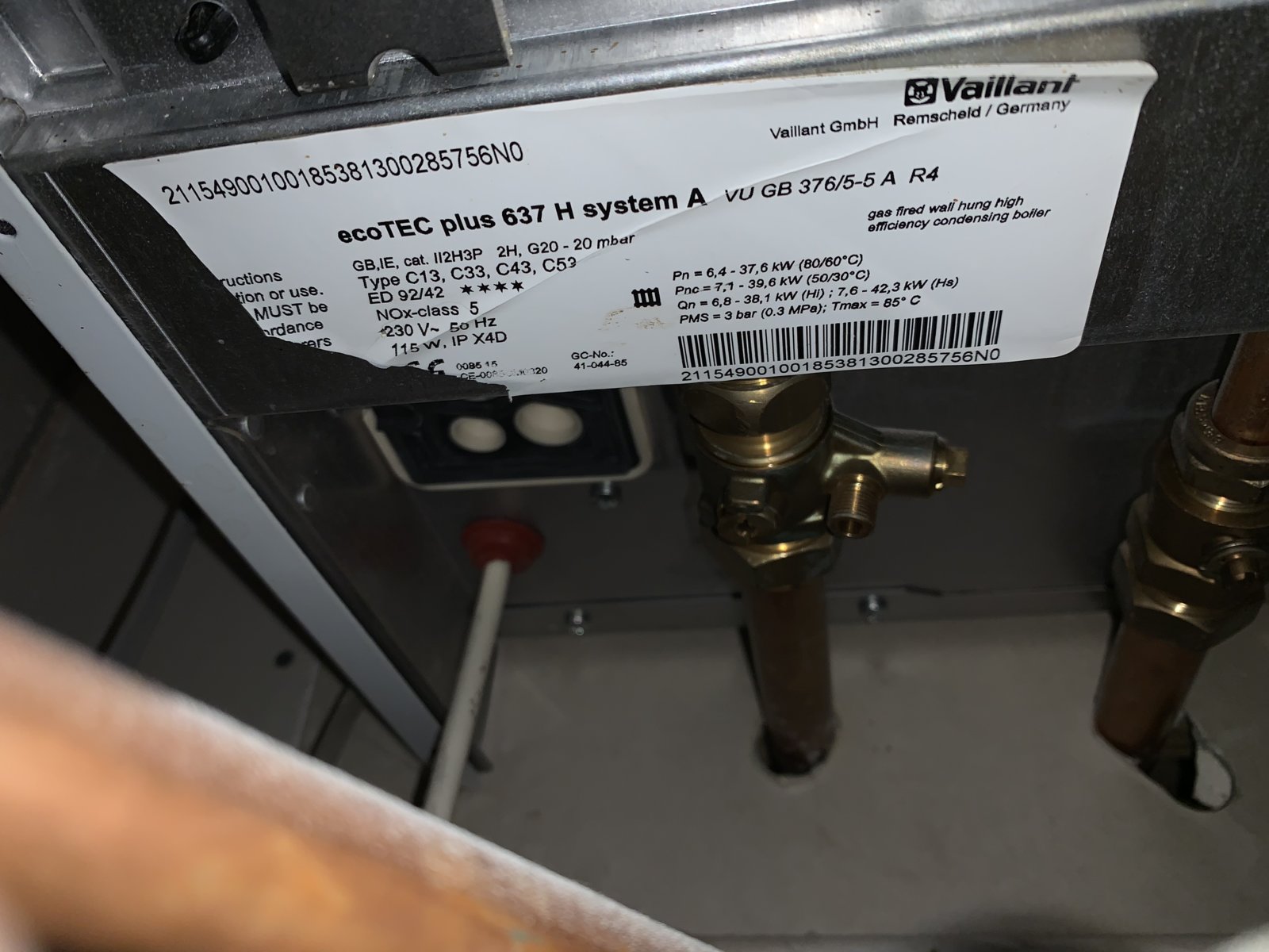

Post a pic of the boiler data plate underneath.

Image attached of the data plate.

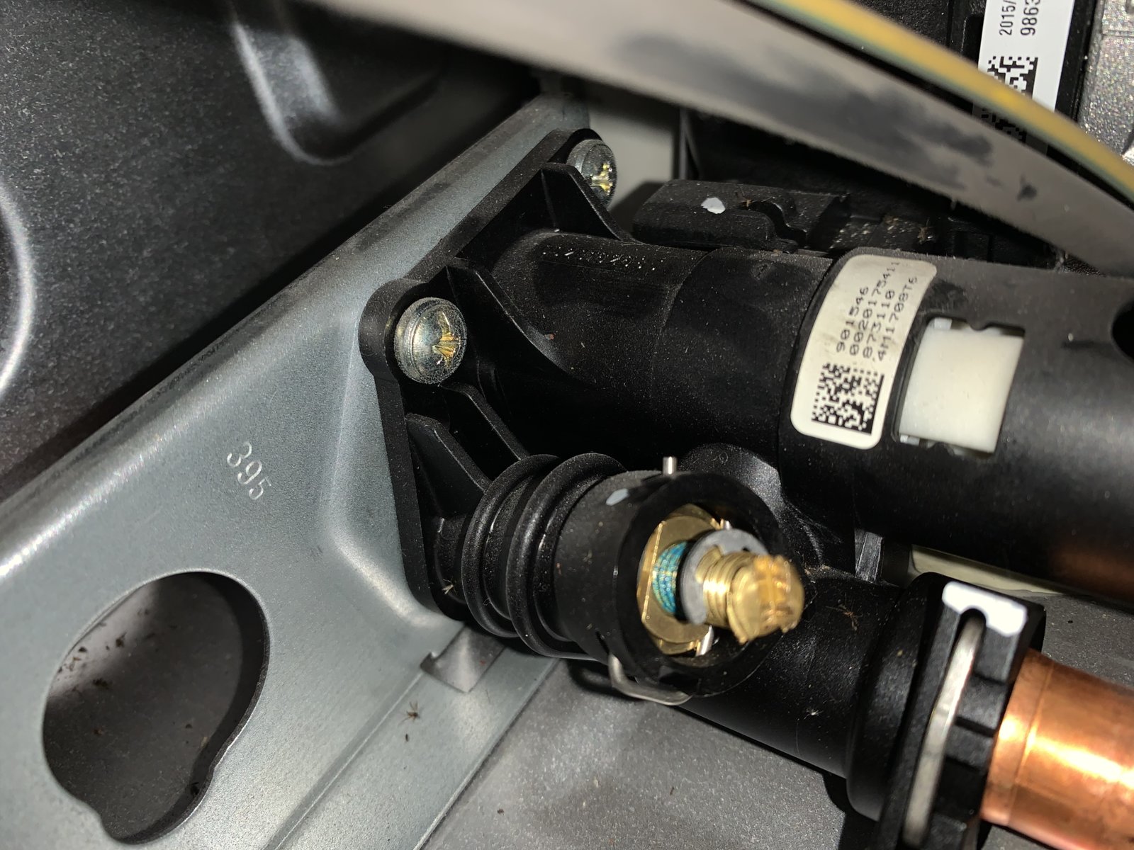

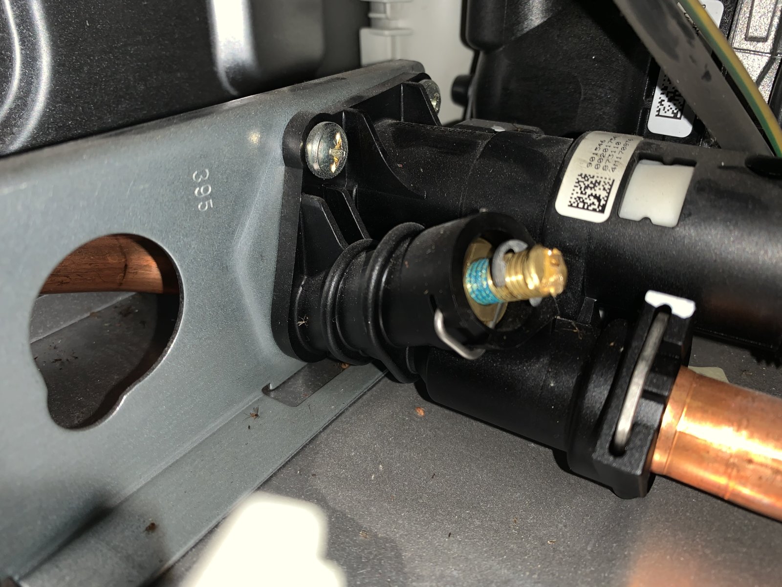

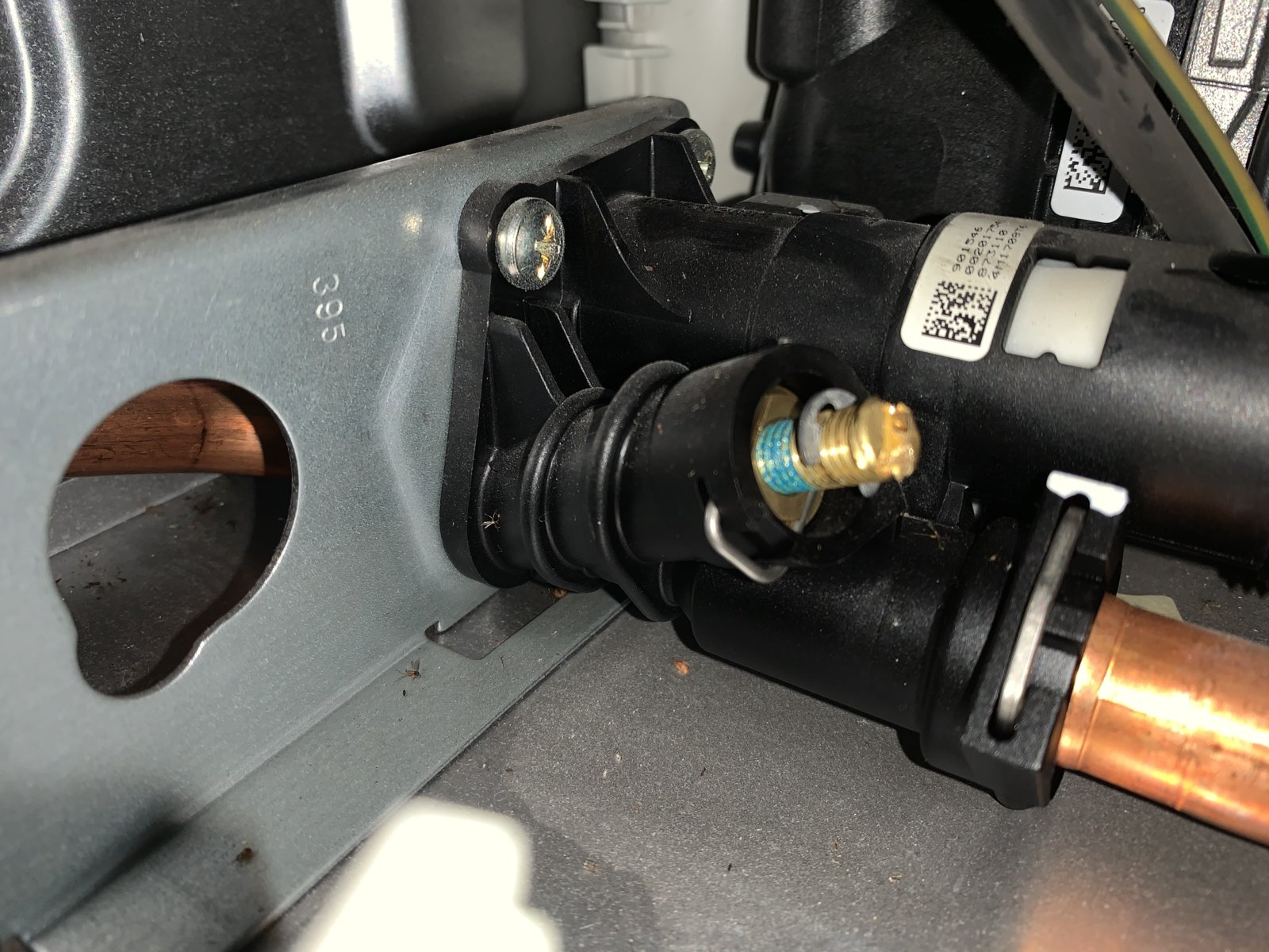

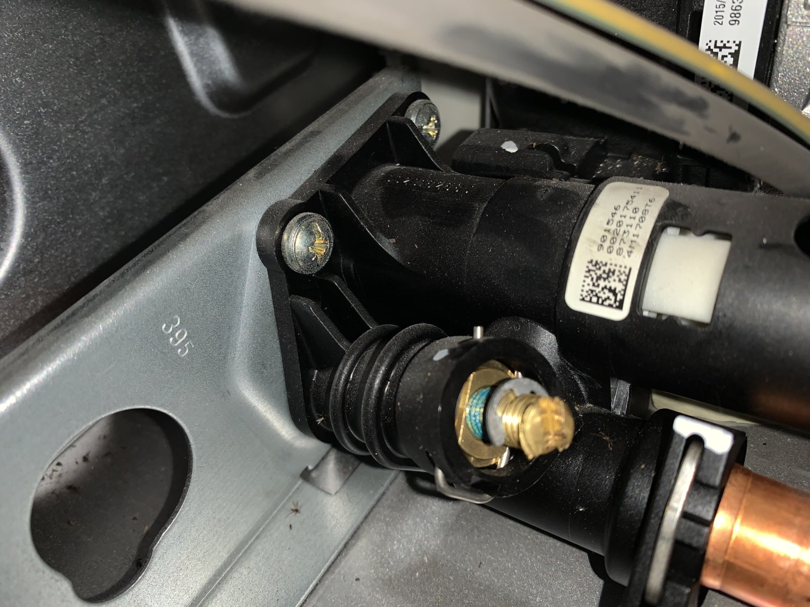

At the same time as putting the pump of the speed up I looked at the internal bypass valve and did go to adjust it as per the engineers instructions but unfortunately the brass bit of the screw snapped as I tried to turn it (yes I was using the correct sized flat head). It seemed unusually tight and there was the green lock paste on the thread.

Just out of interest, does the position of the adjustment screw look okay to you?
It looks to be wound out but then has the green locktite around the base of the screw.

Looks to be around the default position...have a look on the web at brand new valves.
