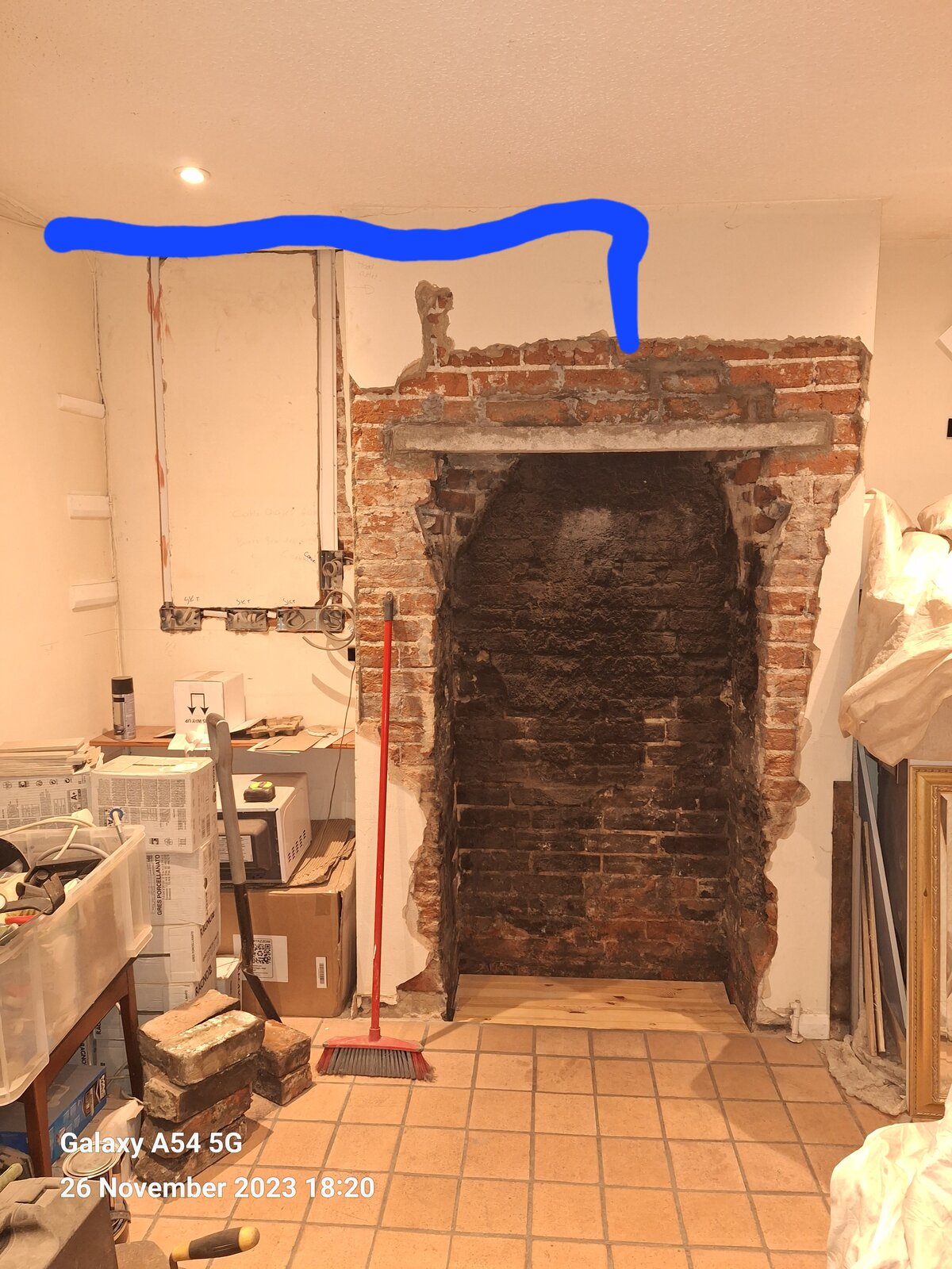

nada75 why dont you post a pic of the side of the chimney and mark where you will have to core drill through? Why must the hole be exactly where you are saying?
And why cant you use a flue liner to take the extraction fumes up the flue? How many floors does the house have?
Basically, the original chimney flue going up to the roof is to the right but was closed way back whenever. I can't open it because there is parquet on the ground floor. This is basement level and there are 3 floors above.

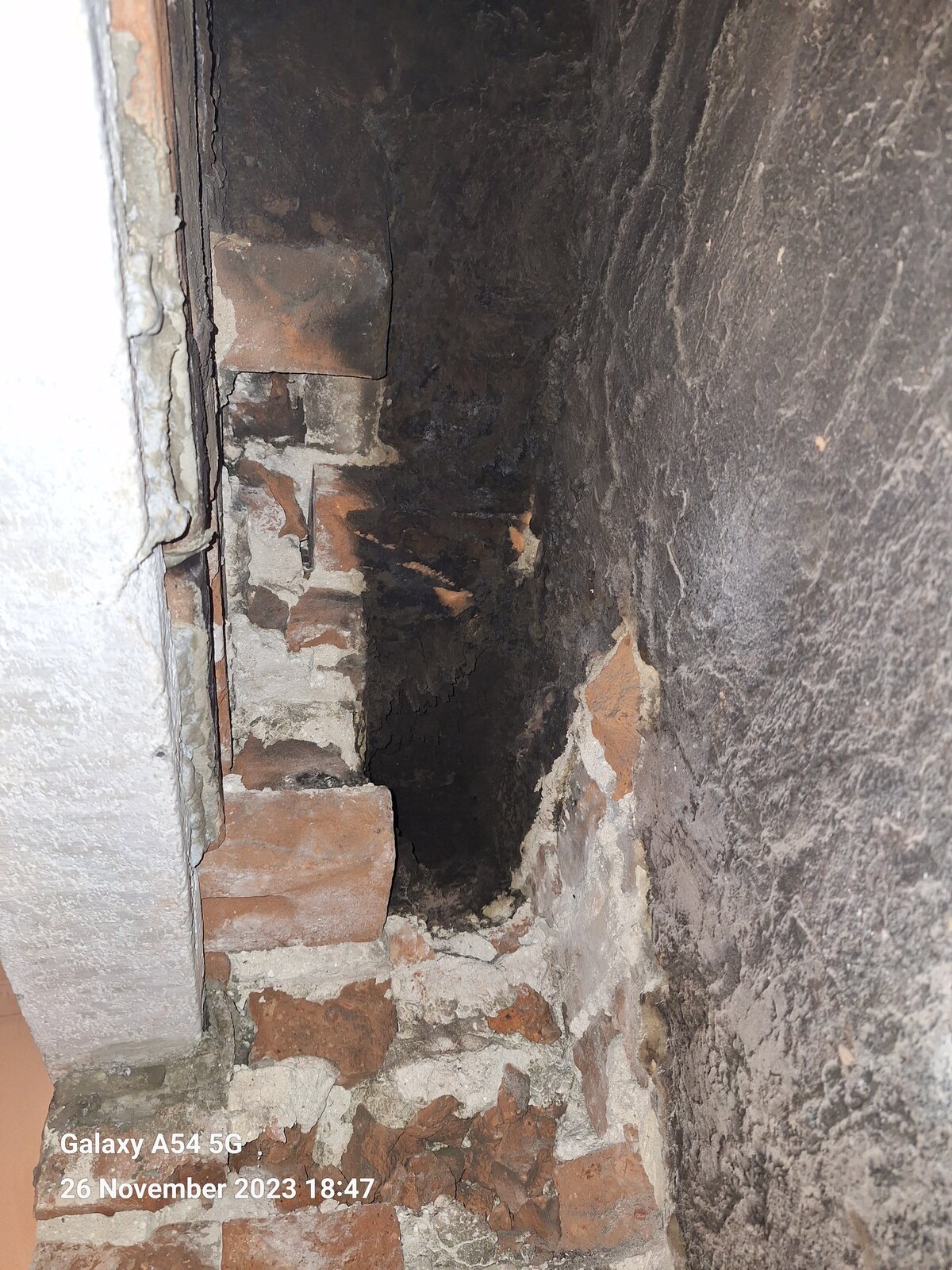

The wall to the left in this pic is an external wall, so quickest route is to duct out through side, or up into floor joists and then out to the side.

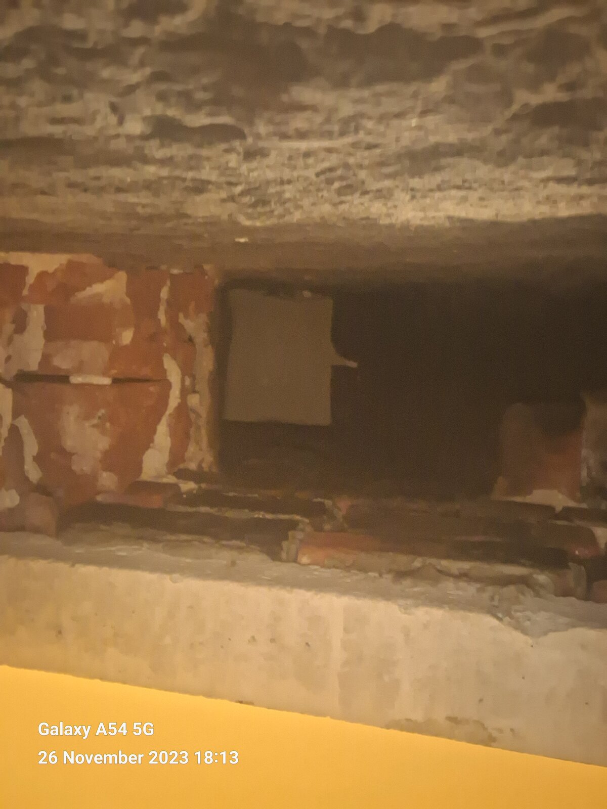

But inside the chimney above the lintel is the smoke stack (or whatever its called)- basically the brickwork that guided the smoke and we're not sure about drilling through there. We have sort of decided to drill rather than core..but not sure whats best!
The pic with grey square shows the flue which is blocked. The next photo shows the existing brickwork above the lintel (all due to be swept next week!)

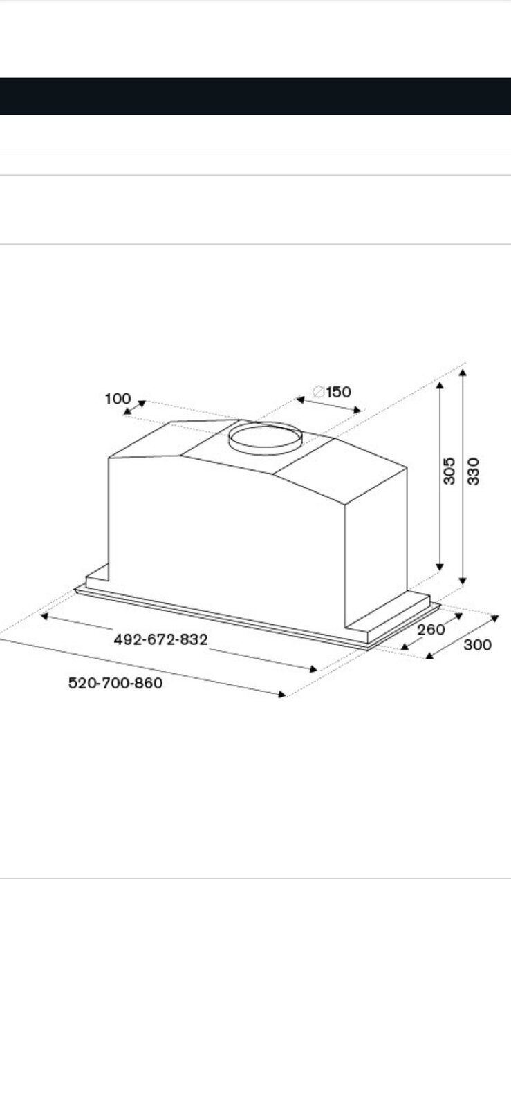

This is my extractor model. Ducting is dictated by the hole in the top...
There doesn't seem to be enough height and width to fit the extractor in. The corbelled brick above the lintel seems to be supporting the flue, so maybe better to take liner straight up and out from the ground floor and disguise it where it hits the parquet floor. Or get a made to measure plate and put flue through it so it fits the existing opening and can exit left as planned. Probably requires HETAS/BC approval

The extractor itself fits, we have enough height and width. The ducting would need room made for it. I will share your comment with my partner. Thank you.
If the liner goes up the flue there's probably no need to alter anything.
If you end up piercing the side of the chimney breast then no need to drill, just knock a few side bricks out.

The little grey square in the second photo is where this flue is blocked up from above, the grey tile sits above the brick. All of the chimneys above are in tact, nothing has been removed. I've seen lots of advice not to duct extractors up a chimney flue due to water condensation running back down. The shortest route is through the side of the chimney to the outside wall, versus going up about 11m to the roof.
I think we will start at the top left side, remove the plaster and see about removing a few bricks to make an opening for ducting.
