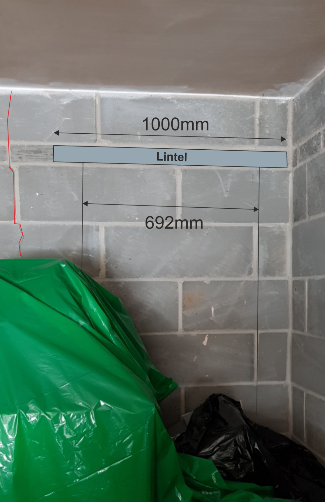

You're making a doorway anyway, so just cut out a block and have a look. It will be a 100mm block on the garage side.
If the wall is 100mm block/100mm cavity/100mm block would I use one 300mm wide lintel (if they exist) or do I install 2 x 100mm lintels?

Hi guys,
my plans have changed. I'm moving the location of the door. With this in mind, is there anything different I should be doing considering how close the new doorway will be to the corner (see pics)? The wall directly above seems to be a stud wall so the block wall doesn't continue upwards (I'm hoping there isn't a load bearing issue being as it's so close to a corner).
The lintel will have a 15mm bearing on each side. Also I'm going to use acrows with strongboys but unsure of the placement. What would you suggest? I'm thinking two underneath the one central block of the hole however the red line in the pic shows where there are some settling cracks (I can't get a £1 coin in them), should one strongboy maybe hold up the end of the block on that side? Would I also possibly need a prop for the ceiling or is this overkill?
I think this wall could be block/cavity/timberframe as the wall itself is only around 26mm thick (could it be block/cavity/block but with a small cavity area?). If it does consist of two blockwork walls, do I install two separate 100mm lintels for each wall or source one wide concrete lintel?
All/any info is helpful.
