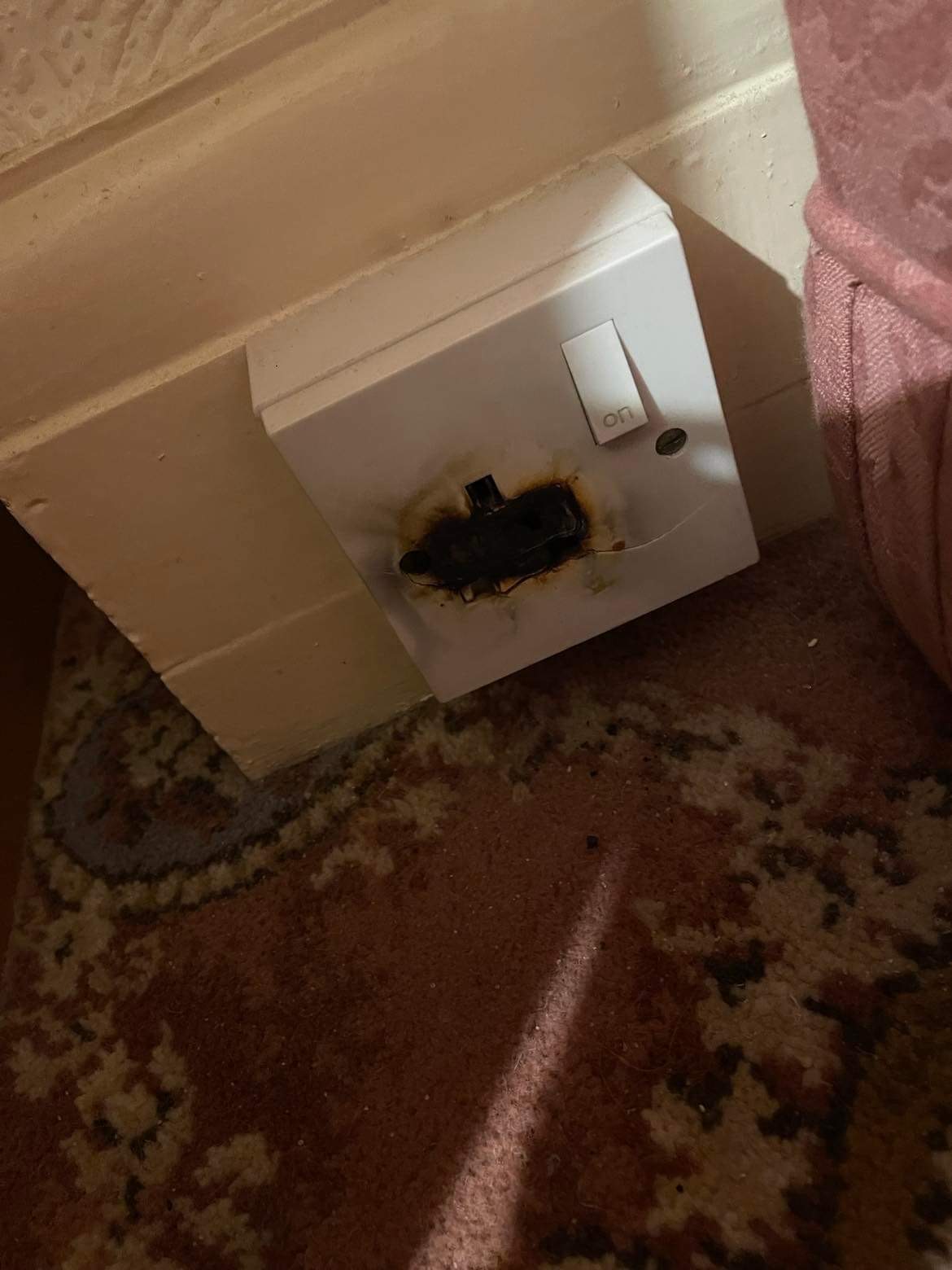

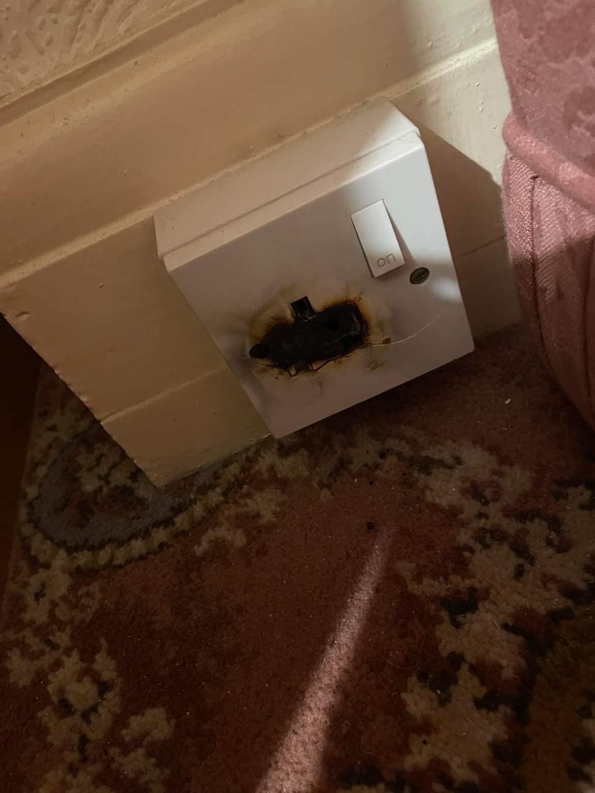

This is what the plug on a cheap Tesco 2kW fan heater did to a socket in my mum's house. Previously, a 3kW heater had been plugged into it for years with no problem at all.
Before you do anything, I'd follow @flameport's advice and try it in a number of sockets. If they all heat up, then it's the plug that's at fault. A lot of these moulded on plugs have crimp/solder connections inside which are liable to fail under a high current draw, such as with a fan heater.
This is what the plug on a cheap Tesco 2kW fan heater did to a socket in my mum's house. Previously, a 3kW heater had been plugged into it for years with no problem at all.View attachment 296132
Out of general interest, did you continue using the same 2kW heater, with a new plug and socket?
Yep, still in use with no further problem. I put an MK toughplug onto it, as I've used them for the same issue with tumble dryers, and they don't heat up even slightly.
