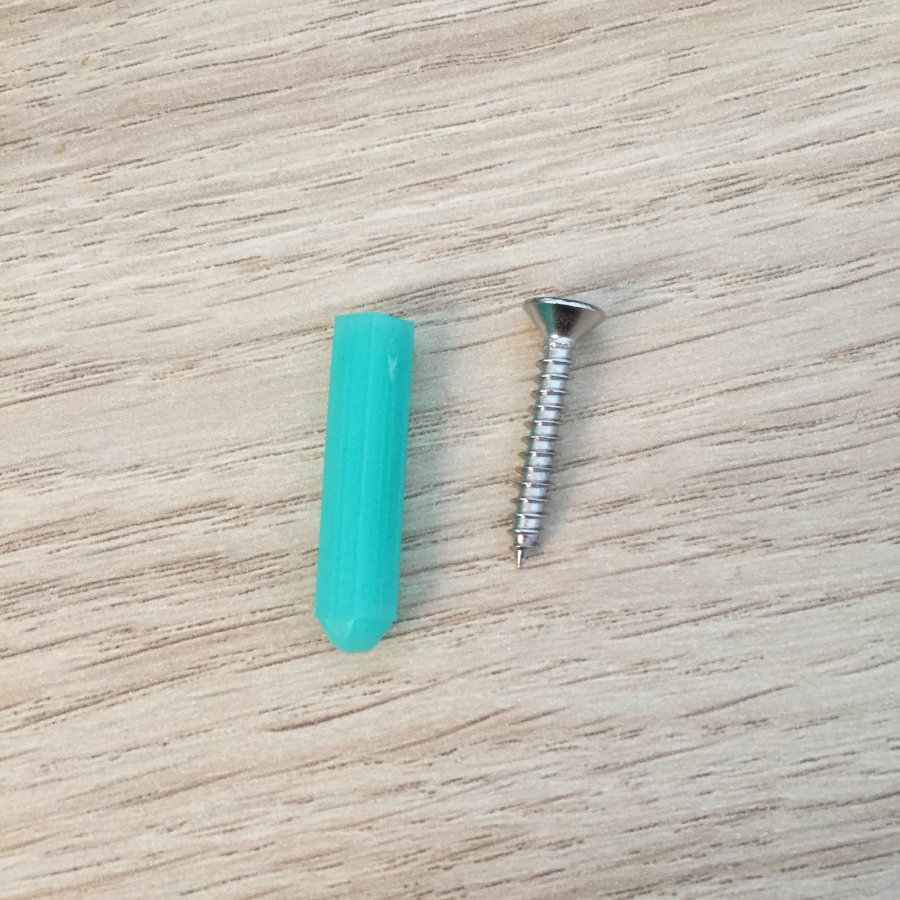

Hello,
Super newb question... But I have some wall plugs that have come with a towel rail and toilet roll holder (please see attached). Are they crappy cheapo things and am I best getying something proper from the DIY shop, or are they very specific ones not to be substituted ever?
Also, it's a modern house where everything is made from plasterboard.
Thanks,
James
You will need nylon self tapping plugs , use you own screws, toggle fixings have huge flat heads and won't fit you towel/toilet roll holders.If you are going thru tile then you can use conventional wall plugs.

I've always had a bit of a disaster with those type of fittings. I used them somewhere else and the screw wouldn't screw all the way in and then snapped! :eek:

Wrong size screw, has to be matched to plug, there is also a smaller variety for smaller fixings.
get some rawlplug unos. Or as foxhole says you need the right size screws for spiral fixings. 4 guage. But even the wrong sized screws shouldn't snap off in the nylon ones
If your house is dot and dab then you need to use conventional plugs, another reason for snapping plugs is it striking the wall and not having the required depth behind the plasterboard.
