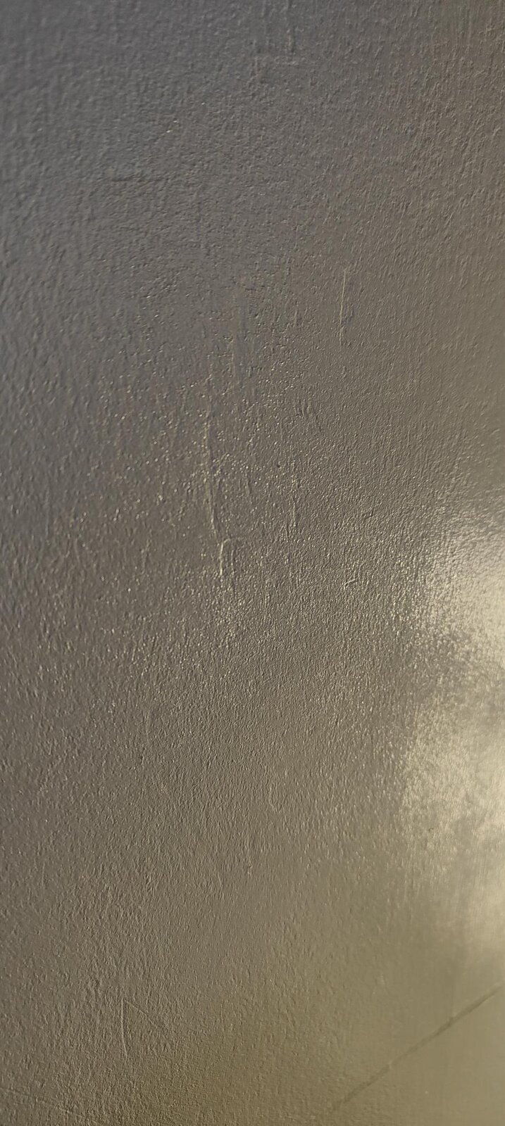

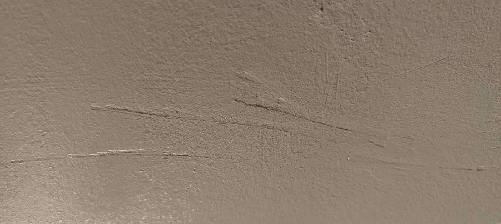

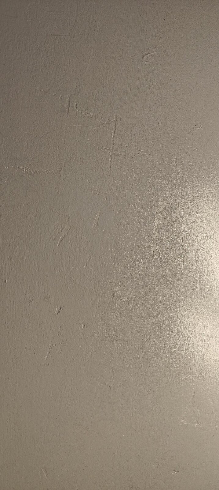

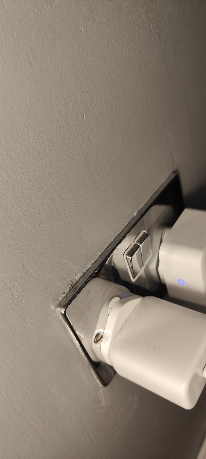

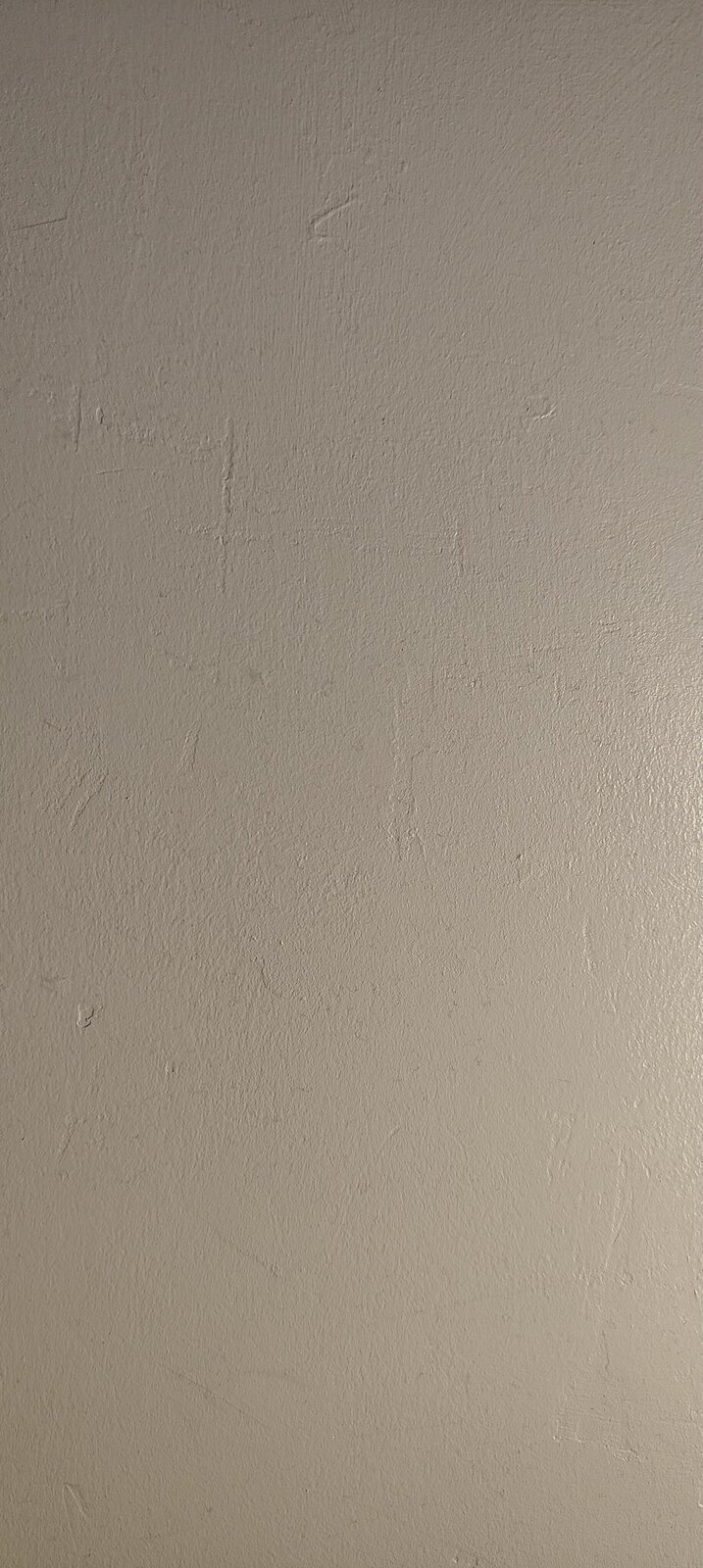

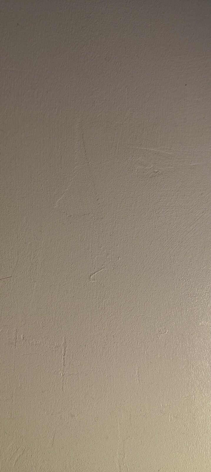

Hi all,
This wall had wall paper on, but it was scraped off and ended up marked (See Picture) Then it was just painted over in silk..
I'm planning on wallpapering it again, I know I'll have to sand the silk down.. But will the wall paper be okay the way the wall is and around the sockets?
TIA

High spots will be more of an issue than the gouges.
Deep gouges may need filling.
If the new wallpaper is particular thin, you could line the walls first (with 1000- 1200 grade lining paper).
Strictly speaking, sanding the silk is not necessary. You, can, for example, paper over glass. However in your case, you have a number of high spots that will need sanding back.

I would prefer not to line if I can get away with it
So you think sand where needed & fill where needed and crack on ( If the wall paper is thick enough) Would you sizing paste the wall?

Anywhere that you fill will need to be sized to reduce the level of suction. Vinyl silk is not porous and does not need sizing. If there are only small areas of filler, I just use full fat paste rather than size.
It may however be prudent to paste where the joins are going to be. It will compensate for the possibility of too little paste being used on the paper's edges.
I would recommend that you use a roller rather than a brush to apply the paste. It is much faster and gives an even coverage. I mix up the paste in a paint scuttle.
Are you using a paste the wall paper or regular paste the paper wallpaper? If the former, paste any filler and let it dry before you start to paper.

I only use scissors for internal corners that are overlapped and curves or sockets (tucking the excess behind the face plate- best to do that with the power turned off).
