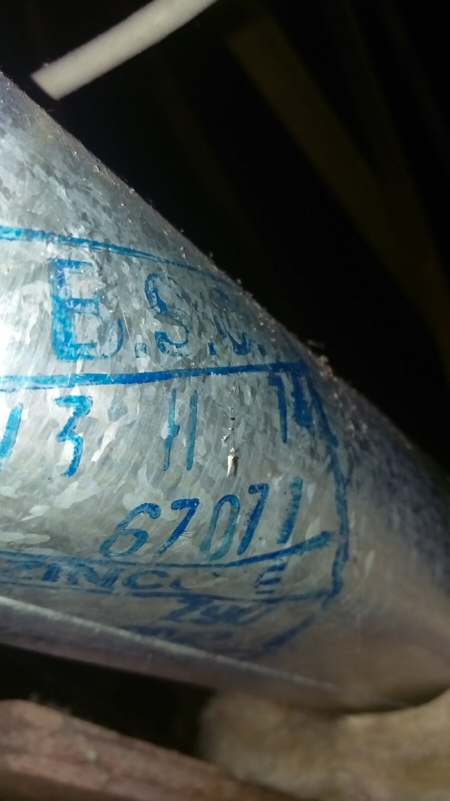

Continuing the talk of asbestos and warm air ducting... my (mid-1970s) warm air system was ripped out some years ago, but a long zinc duct pipe was left behind in the loft.
I'd like to remove it now as part of a general tidy prior to putting in another layer of loft insulation - but am wondering if there is any risk of asbestos being present... I will have to break it into pieces to get it down through the hatch, and don't want to disturb anything nasty. How can one tell for sure?
If I unpeel the tape around the joins in the duct, will it pull apart easily?
I'm fairly sure there was a small asbestos sheet in the old warm air unit before it was removed. The company that removed the old system never made any mention of asbestos though, and removed and disposed of everything - the flue (which was also zinc I think) and the cupboard surrounding the unit - apart from that remaining duct pipe, so if they disturbed a lot of asbestos it's too late to worry :( :)
perfectly ok to take that apart there is no asbestos in it joints will separate quite easily with a quarter turn
