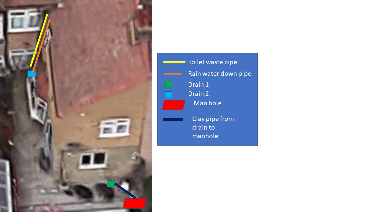

Thank you for your replies.
I was thinking of a dye but I didn't realise I could pick one up from Screwfix - will get that tomorrow, saw this one (https://www.screwfix.com/p/monument-tools-flourescein-drain-dye-133g/31595). Ideally I would need a couple of different colours but they only seem to have the one green one.
I opened up the manhole in the garden and it was trickling so no major blockage.
I could see two clay exit points. I know one of them is directly from the back of the house where the kitchen/dishwasher and washing machine run into and this goes directly to the manhole.
The other exit point is connected to, I am assuming, the side of the house where the bath and rain water exit into a drain - I don't know where the run of this pipe would go - under the house diagonally to the manhole or following the wall boundary?
I've uploaded the ariel view which might help.
This only happened on the continuous downpour otherwise it's been ok.
I'll put the dye into the drains and see if it comes through.
I'd expect the drains to run around the outside of the house (not under it) until they reach a point where they can run out to the sewer (usually in the road in front, but sometimes to the rear of the houses). In your pic they all seem to be at the back, and probably join with the adjacent houses (in England, from the point of the join, the shared part is now the responsibility of the water company)
in a terrace the front and back may go in different directions. Even if you have no foul drain at the front, there will be rainwater pipes.
The common sewer to the rear may run forwards to the road between blocks of houses, or it may just run behind them all, especially if there is an alley or lane to the rear. Position of old outdoor WCs may give a clue.
The rainwater drains and the foul sewer may be combined, depending on age and district. Sometimes rainwater goes to a ditch or stream, or to a soakaway. In these cases you are not allowed to put foul water into rainwater drains.
The breakage is most often at the trap or bend where the above-ground vertical pipe turns in the ground to run horizontally. A householder with a spade can dig it out, it is not complicated.
