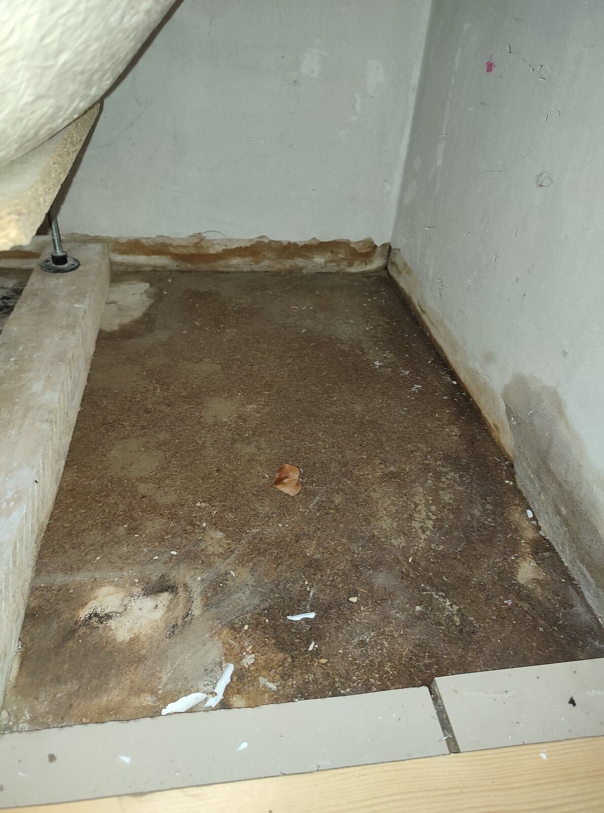

A couple of days back the shower partition leaked and flooded out the bathroom floor. Last night, the kitchen light underneath the bathroom tripped.

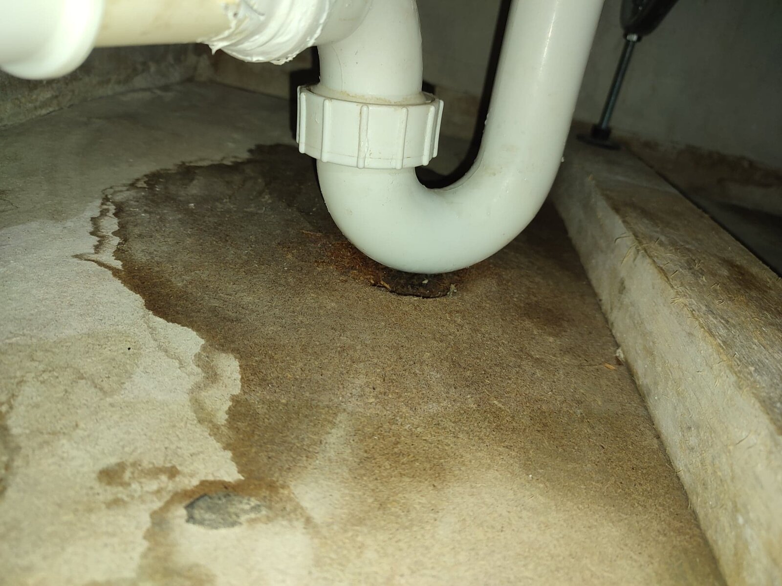

Took the bath panel off to have a look, and found damp floorboards. Also the baths overflow drain had been leaking beneath the U bend (second picture.)
Can't see any signs of a leak downstairs, and have turned off downstairs lights from breaker. Am running a dehumidifier next to damp area in bathroom.
Have spoken with electrician, he said that he could look at it today but replacing the fixture might not be done until the area is dry next week. He'd charge me an hourly rate for any visit. So I'm thinking might be better to wait a few days until dry, to keep costs down to one visit.
My concern in the immediate moment is electrical safety, if there's anything more that I should do?

Image number 2- why is the join covered with silicone?
I think you need a plumber, and not an electrician. Once the leak has been fixed, it is likely that the lights (once dry) will be fine.
Yes, good point re silicone. U bend doesn't seem to be leaking though, its the overflow. I wont use the bath/shower until all sorted.
Electrician recommended replacing whole light fitting, I'd like him to do a safety check just for my piece of mind. Then I'll get a plumber on the case.
Should I be concerned about the integrity of the floorboards?
The water took the path of least resistance, ie it followed gravity and leaked out of the light fitting. I wouldn't be overly concerned about the flooring at this point.
Not the floorboards. More likely for a plasterboard ceiling to fail if it has had a soaking.

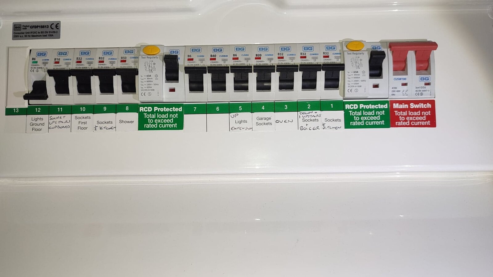

You still havent said what is tripping? MCB, RCD, RCBO, ???

I'll have a look at the breaker when I get home re what is tripping.

The RCD on the left tripped. As you can see I presently have the downstairs lights off, until electrician gets round.

After a day with the dehumidifier, the boards looks a lot dryer. No sign on ingress downstairs. I'll get the electrician in next week to put new fittings in, just to be safe.
I'll try and sort out the baths overflow drain myself, fix the shower partition so that it doesn't week, then keep an eye on it. If all good I'll seal the panel back with CT1.
Only concern is the chipboard, its a little bit 'bumpy,' where its been damp. Also, the section under the U bend is a little swollen, though that might have been like that previously. The 'crater,' beneath the U bend is a little crumbly.
