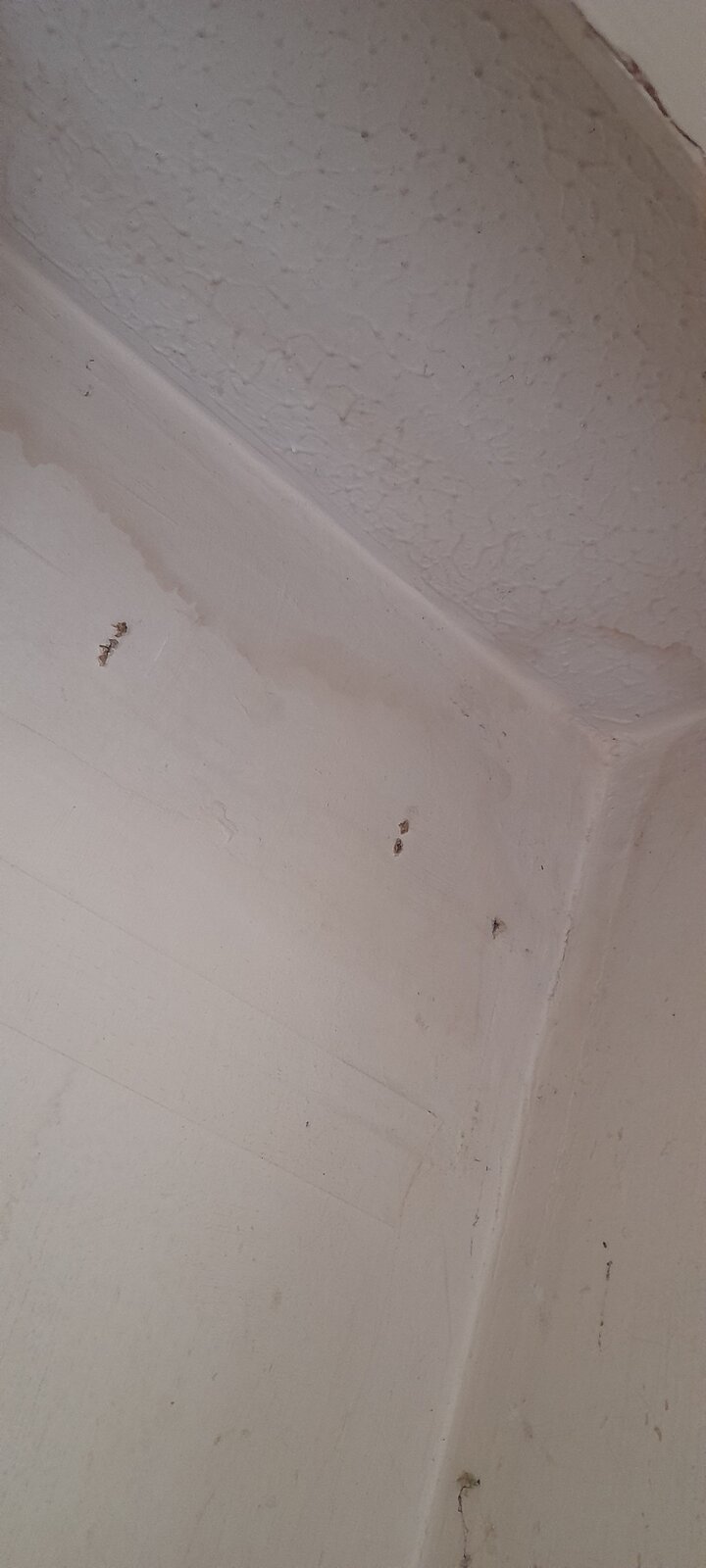

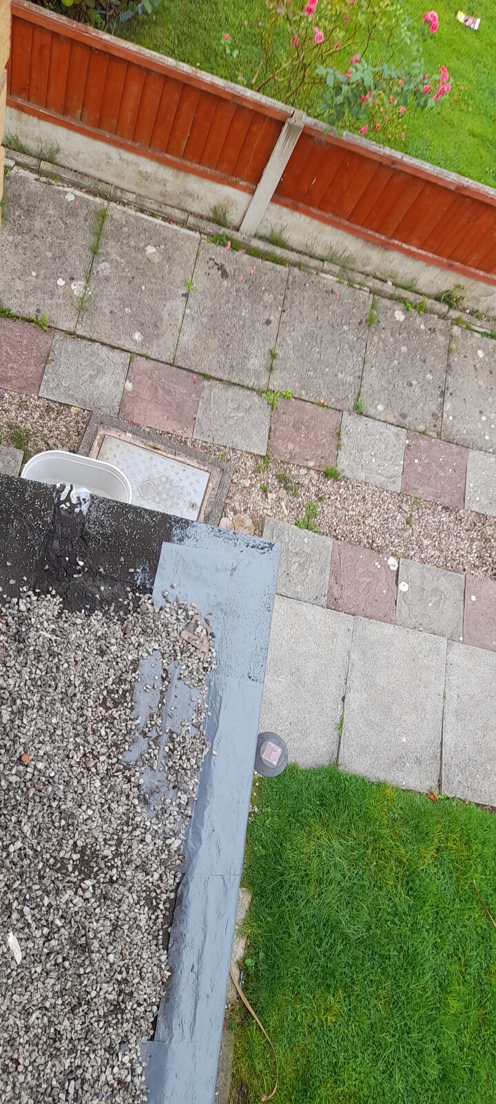

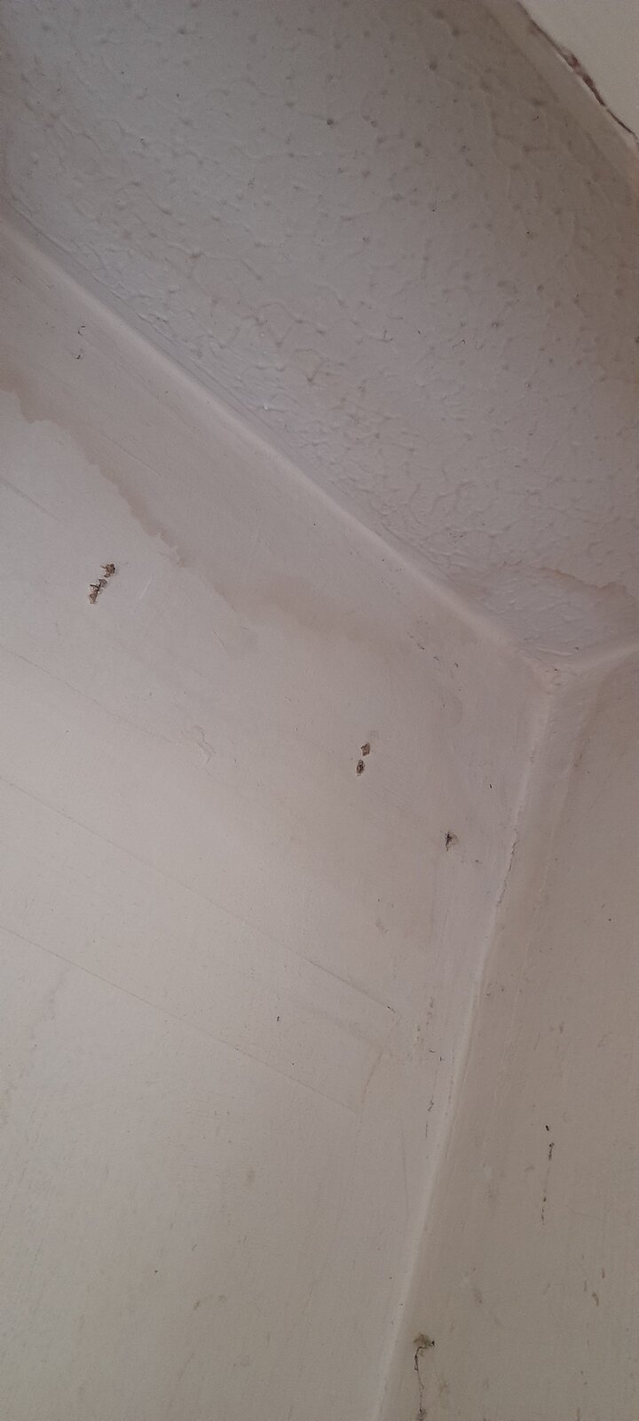

What are these stains in ceiling and walls of porch cupboard?
21 Feb 2021
379
Cupboard in porch.

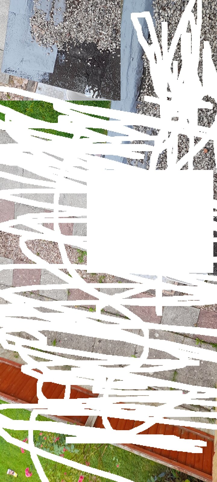

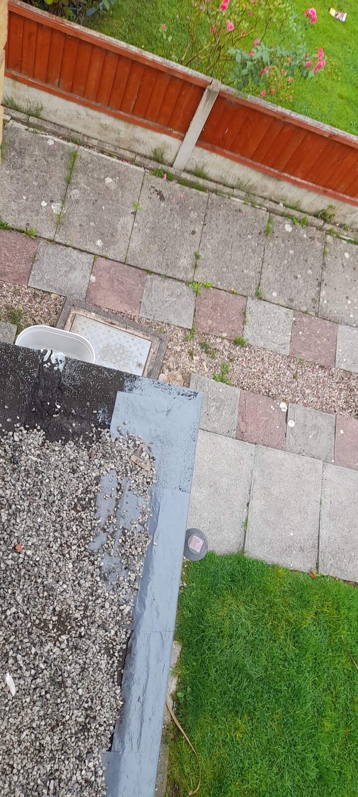

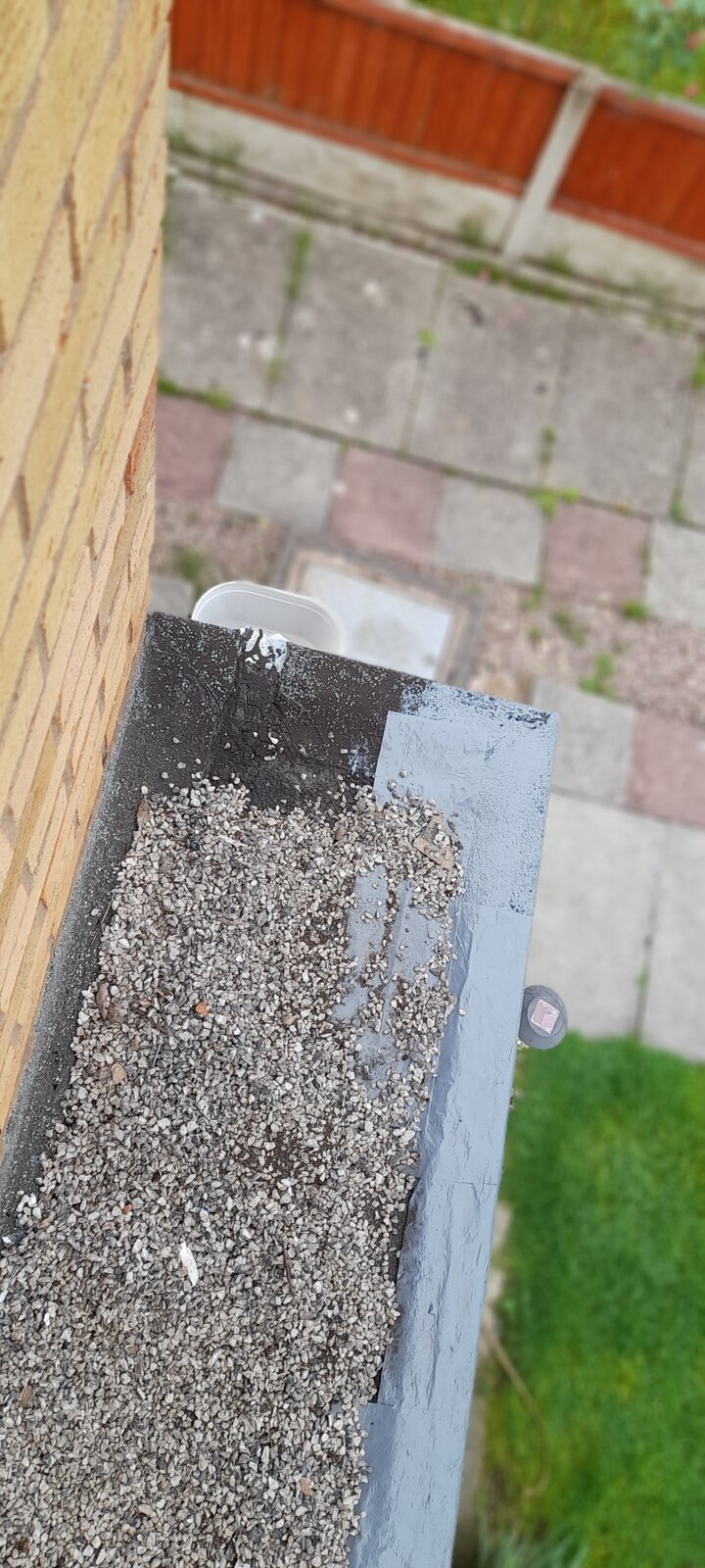

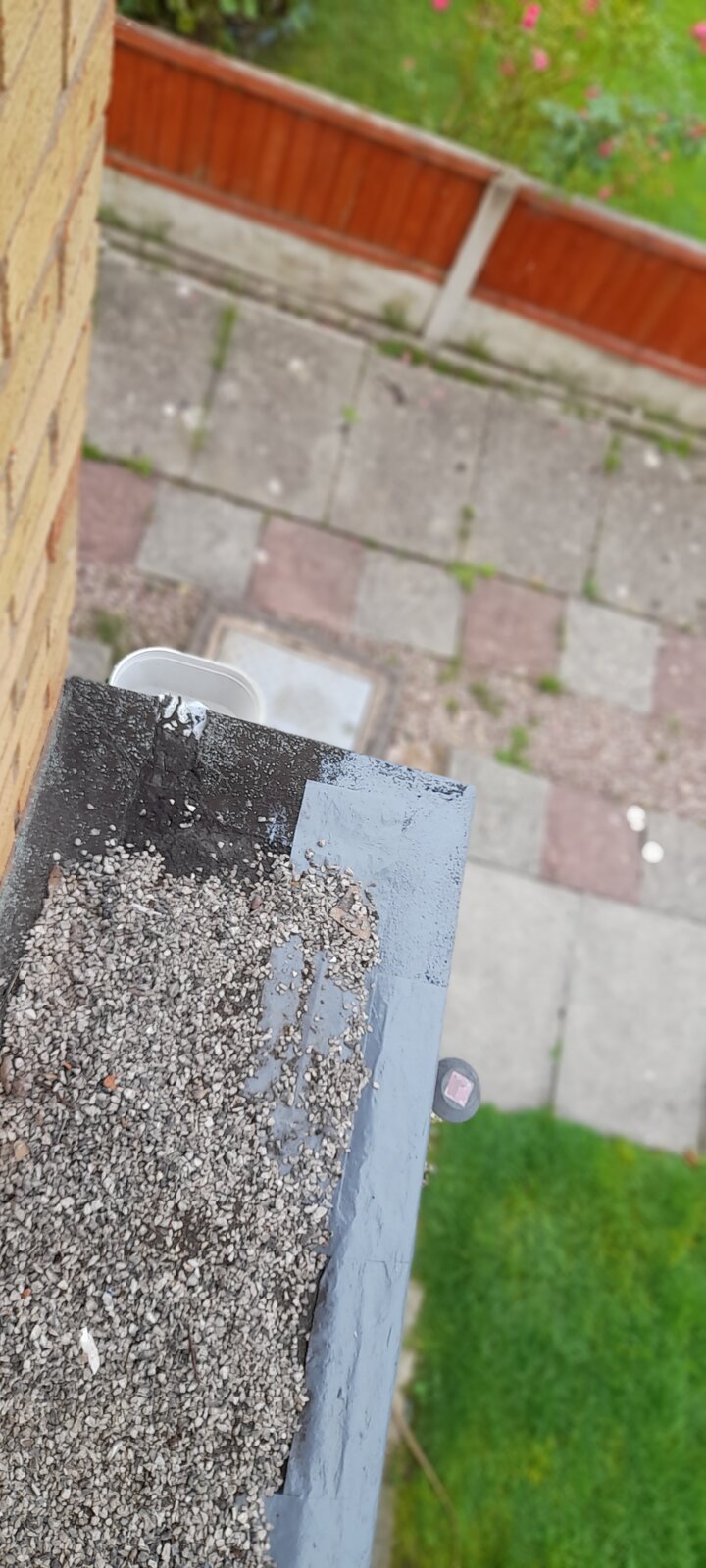

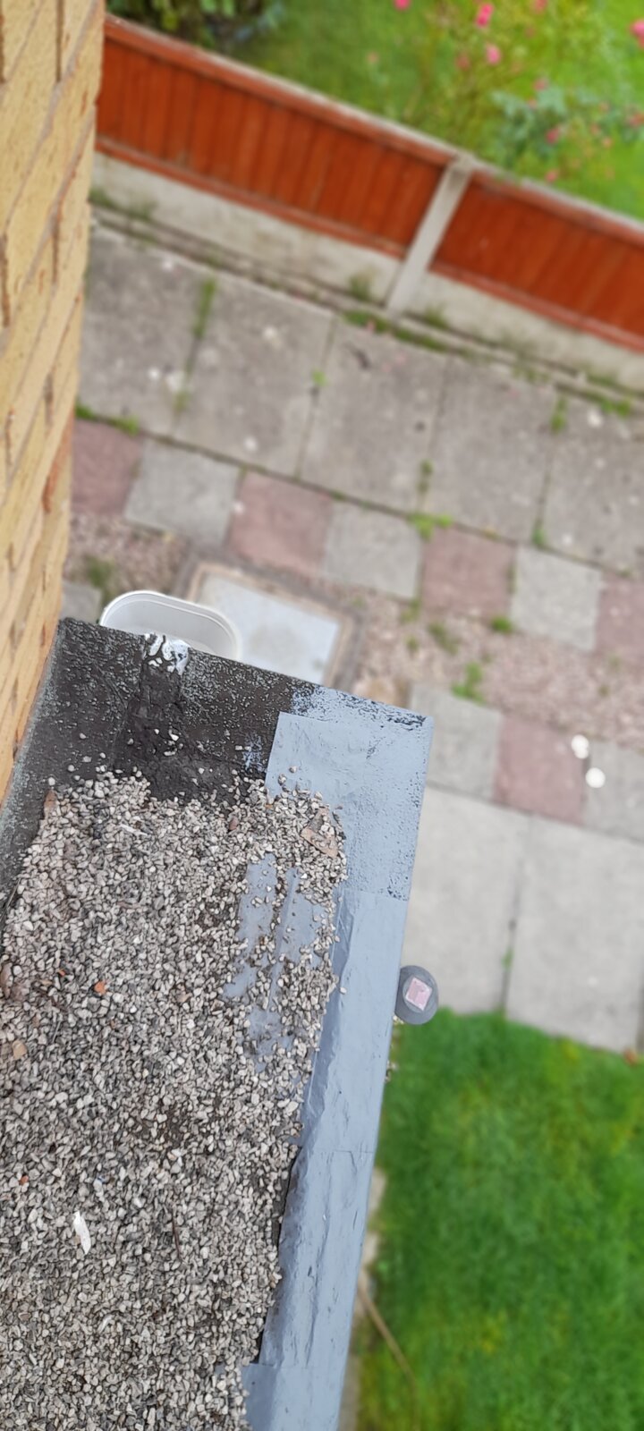

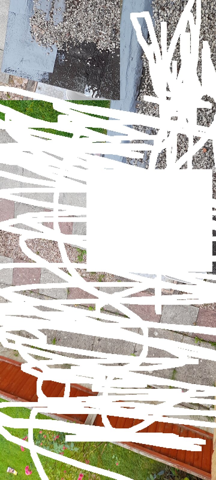

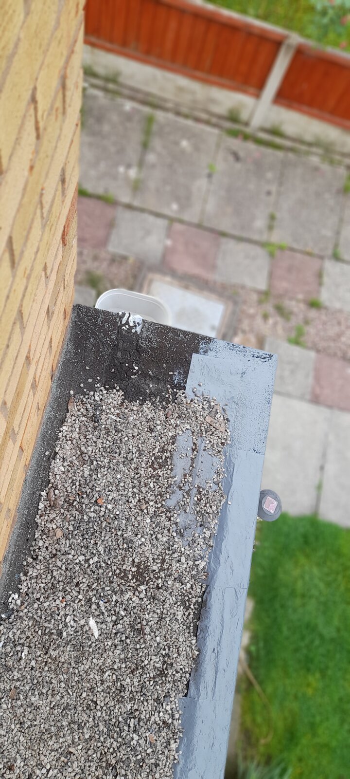

Here some more outside- aerial photos and a close up of porch roof above stains.
Have you tried paint? Maybe a bit of stain block?
Andy
No mate, if the water is getting through that felt (and looking like it must be) I'll do more Acrypol-Flashband and Acrypol.
Water will often travel after it gets through whatever is retaining it, so stains on ceilings and walls are not necessarily caused by leaks directly above where the stains are
Edit- so those stains were probably caused by the rotten felt and huge holes you posted about a few days ago
