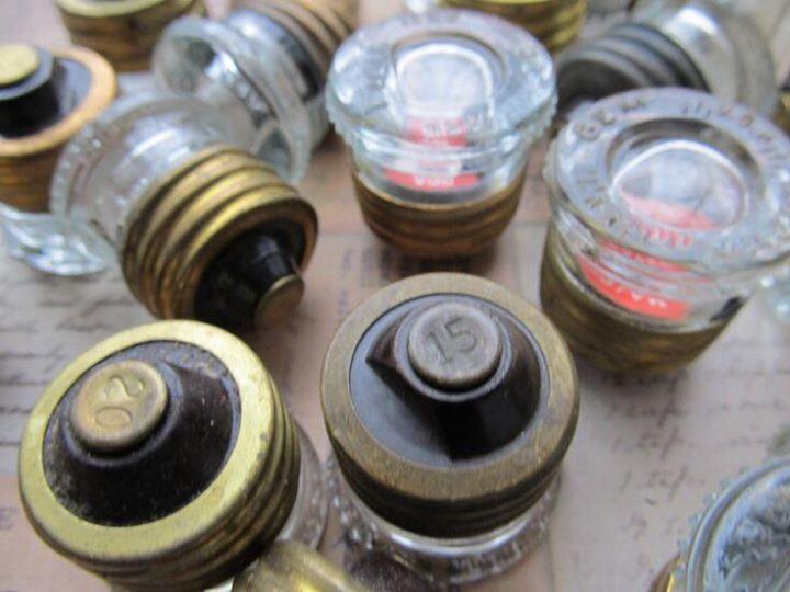

what are these
They look like old glass fuses.

Not seen them in glass before but i think theres porcelain versions still about, sure ive seen them in old lift motor panels, think RF lighting has a pic somewhere
From http://en.wikipedia.org/wiki/Fuse_(electrical)
In North America, fuses were used in buildings wired before 1960. These Edison Base fuses would screw into a fuse socket similar to Edison-base incandescent lamps. Ratings were 5, 10, 15, 20, 25, and 30 amperes. To prevent installation of fuses with an excessive current rating, later fuse boxes included rejection features in the fuse-holder socket, commonly known as Rejection Base (Type S fuses) which have smaller diameters and vary, depending on the rating of the fuse. This means that fuses can only be replaced by the preset (Type S) fuse rating. This is a North American, tri-national standard (UL 4248-11; CAN/CSA-C22.2 NO. 4248.11-07 (R2012); and, NMX-J-009/4248/11-ANCE). Existing Edison fuse boards can easily be converted to only accept Rejection Base (Type S) fuses, by screwing-in a tamper-proof adapter. This adapter screws into the existing Edison fuse holder, and has a smaller diameter threaded hole to accept the designated Type S rated fuse.[10]
http://homerepair.about.com/od/electricalrepair/ss/fuse_types_2.htm
