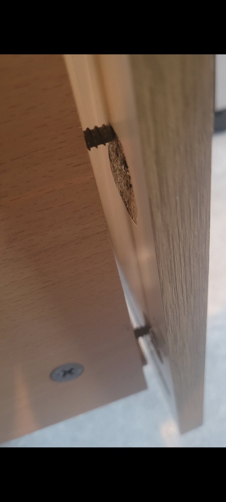

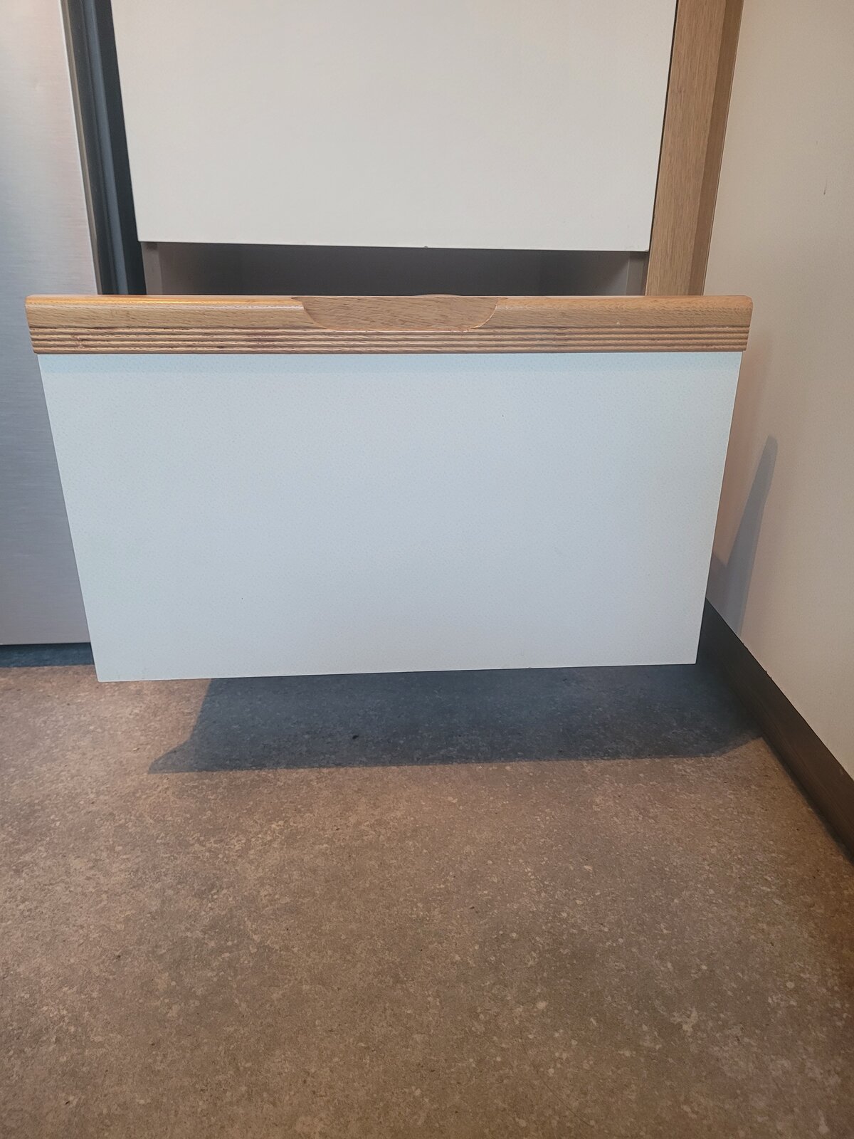

Hi can anyone tell how I can fix this drawer? I am thinking just a really strong glue. Has anyone any other idea?

The problem is that glue isn't a gap filler, which is also needed. You could try a 2-pack filler (wood filler or car body filler) to fill the damaged areas, but I'm not sure how long that fix alone would work, especially if the drawer is heavily laden. Were it me I'd use the 2-pack to fill the holes (push the fixings intonthe 2-pack whilst it is soft) PLUS add a couple of angle repair plates between the drawer sides and the drawer front on the inside of the drawer
And then see if you can fit a soft close; the weight of the drawer base and the things in the drawer will constantly strive to wrench the base off the front (as it has done here) when it bangs shut. The more you can make it slow to a stop before the face comes into contact with the cabinet the less likely that will happen.
Stixall clear polymer.
Go along with mastic.
Push back.
Wait a few hours for it to dry.
Could add a few L brackets but I think the polymer will hold fine. Put a blob on those plugs.
Toolstation is best place to buy
An alternative would be to use new cam fittings
You would need to ignore the existing ones and fit new ones.
