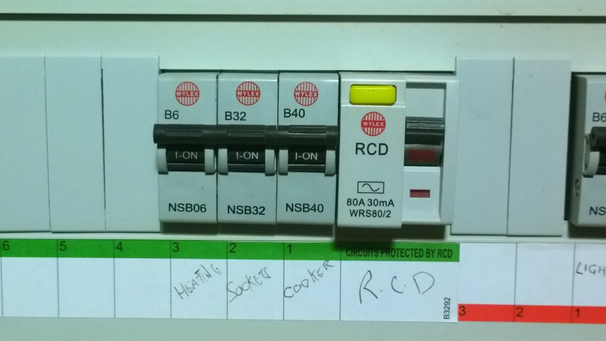

Great, thanks PrenticeBoyofDerry. I was aware of safe zones but not of min wall thickness, makes sense really.
You mention protection by 30mA RCD, you are referring to main fuse box as pictured:
