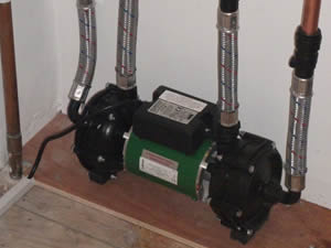

Or do you mean something like this? Which is a shower pump and has nothing to do with the heating system.

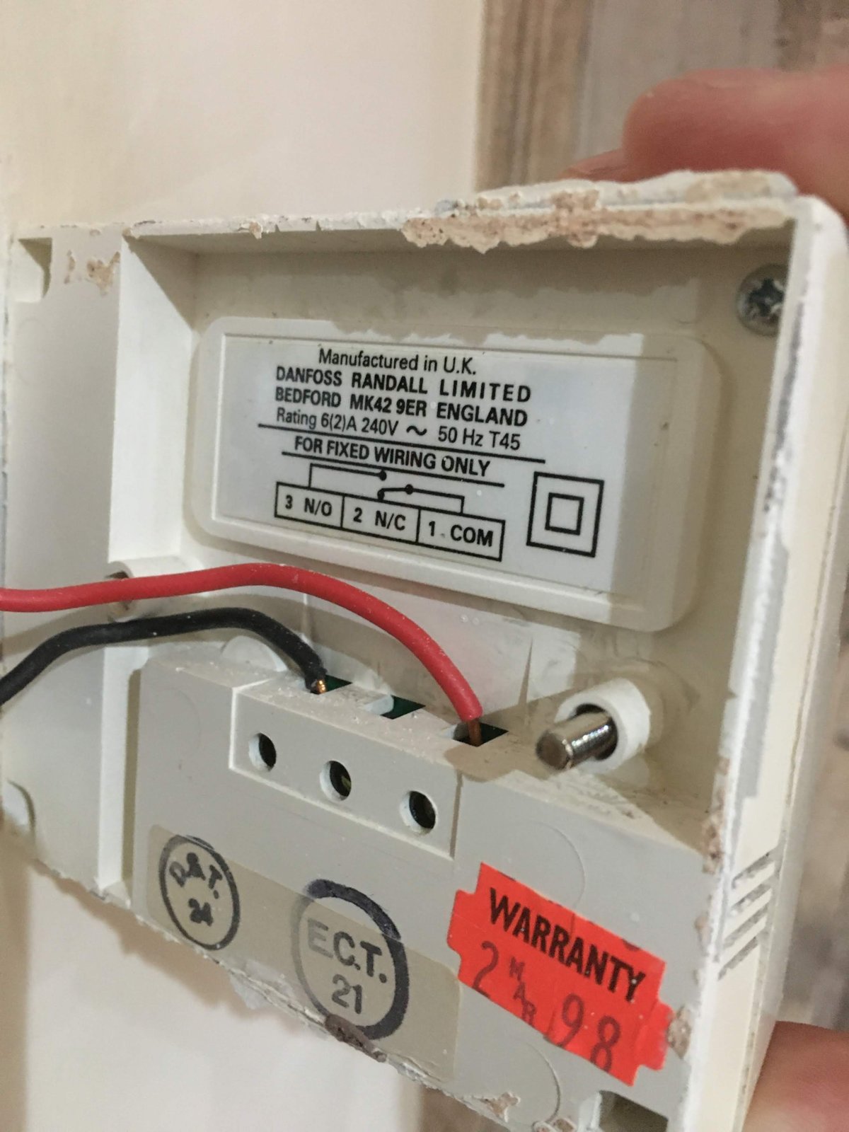

Brill thanks, I whipped the room thermostat off the wall earlier to see the wires, it has 2, is this ok for Hive/Nest?
If I'm not mistaken, that looks like a Danfoss TP4/5 thermostat. It has the switching wires there to control the heating, in 'COM' and 'NO' but it is battery powered. Hive and Nest are mains powered, so they also need a 230V supply to power them connecting to their N & L terminals.
This should come from the same fused spur that supplies the entire heating system. The red wire in 'COM' may be a suitable live, provided it's permanent and not controlled by a timeswitch somewhere, but there isn't a neutral. The easiest way is probably just to run a new N & L to the Hive / Nest and then use the existing wires for switching as they are now.
If you are only going to control the central heating then you need a single channel version of Hive.
if you want the easiest way just replace that thermostat with the nestE it is battery powered and you just connect those two wires to it, but must be NestE not a standard nest
