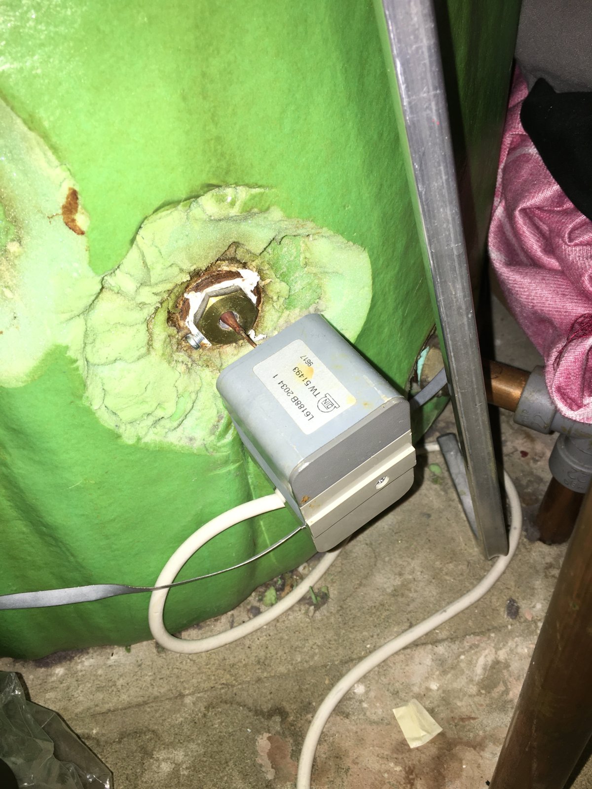

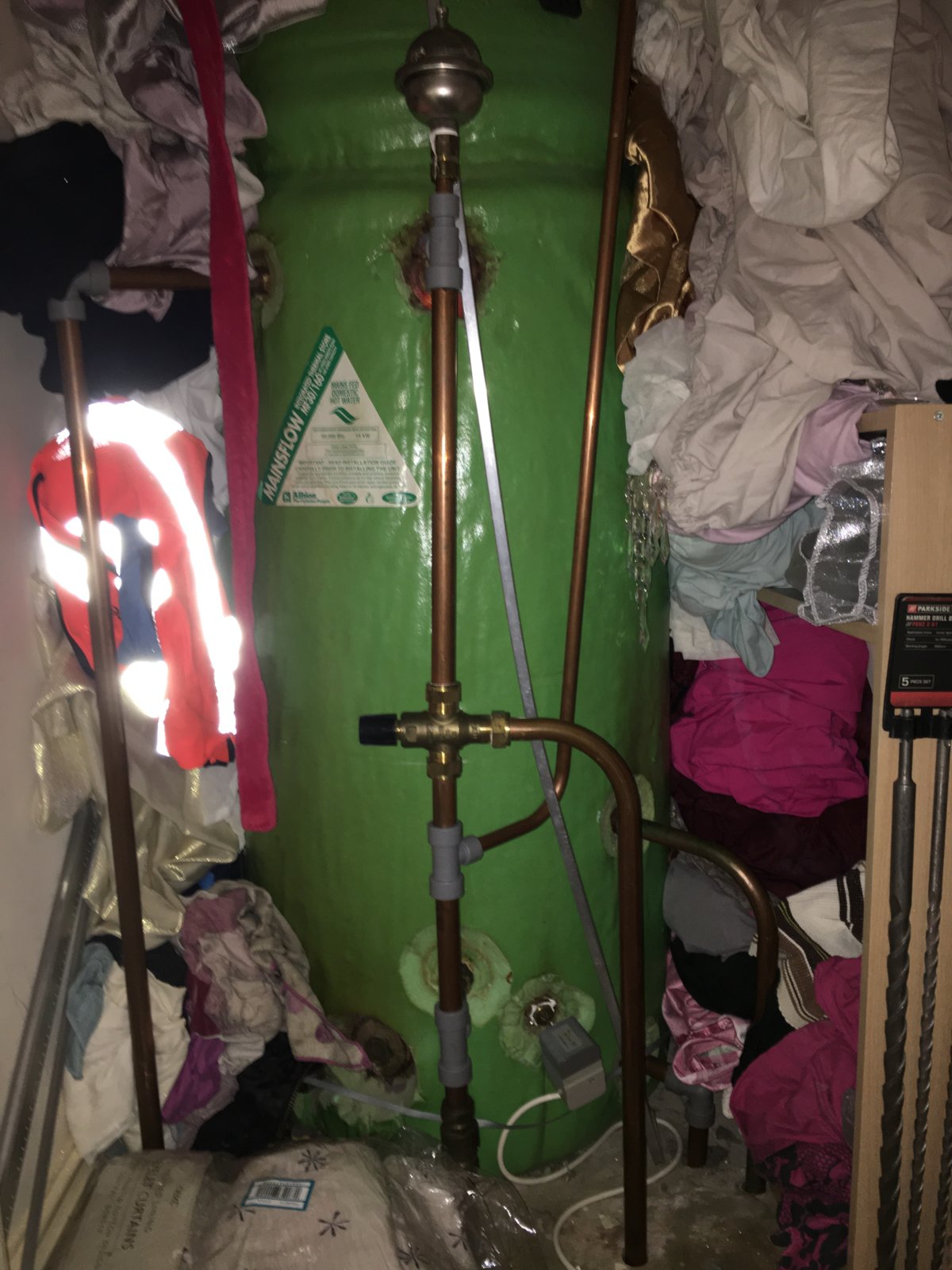

Hi, pictures of my water tank attached

The little box at the bottom is wobbly and seems to be connected to the green tank just by a copper wire, is this a thermostat?
I'm not sure what your problem actually is. Older boilers have a thermostat that simply switch the burner 'on' and 'off' to maintain the temperature of the water leaving it at the level set on the boiler thermostat.

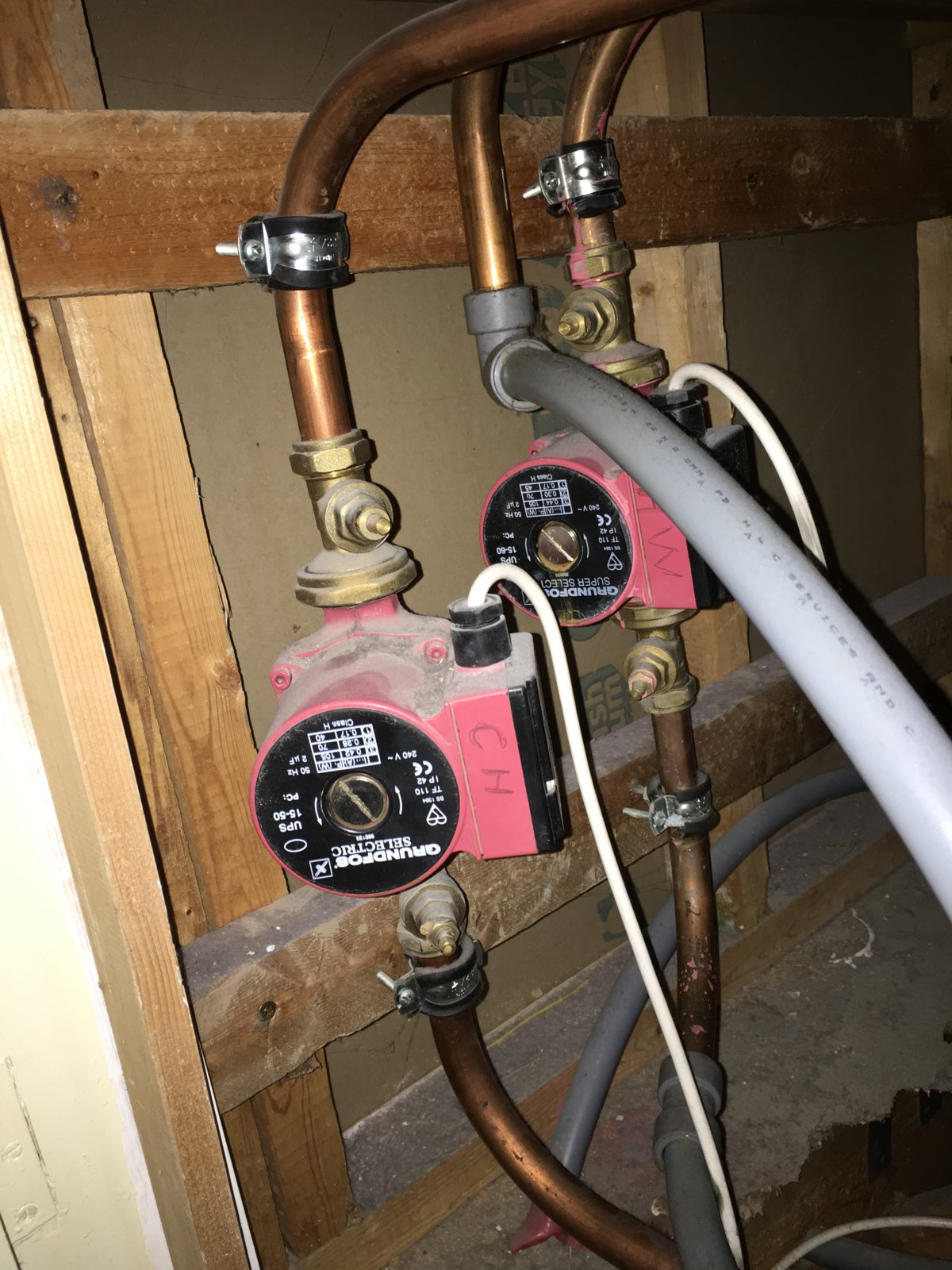

I have uploaded a picture of my pumps also.

Also, is my hot water tank sufficiently insulated? (Apart from all the old curtains...) should it not have a jacket on?
The green foam cover is the insulation, if you look where the pipes enter you will see that it's quite thick. If it didn't have any insulation on, the cylinder would be as hot to the touch as the hot water coming out of your taps.
40 years ago the hot water cylinders didn't come with insulation so then a separate jacket was fitted.
