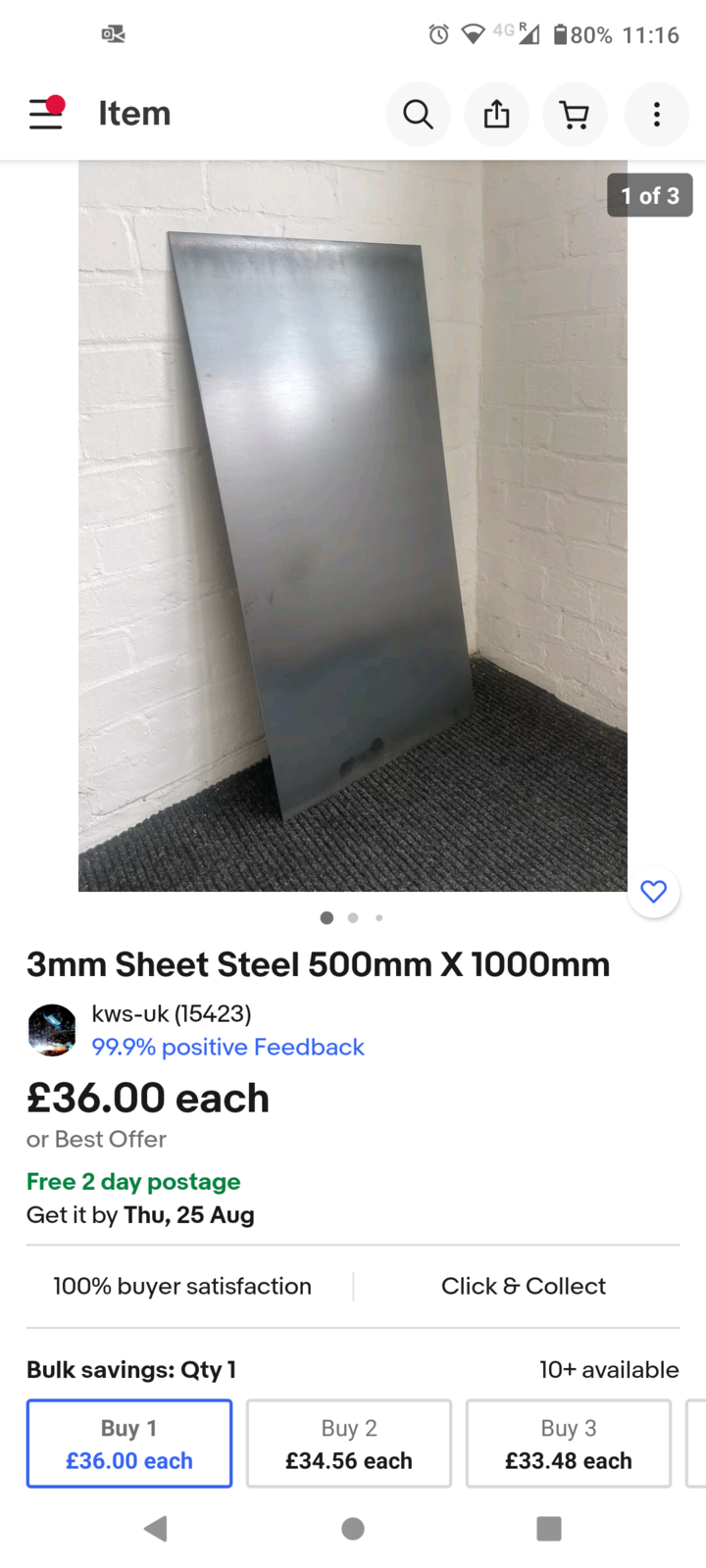

Or eBay, eg:
My local steel stockist (and I presume most others) has a "used" area where all the off cuts are for sale at a discount.
Or eBay, eg:
Wow, that is cheap, thank you very much for that. I did look on ebay but didn't find that one.
AND, the postage is free - can't say better than that.
