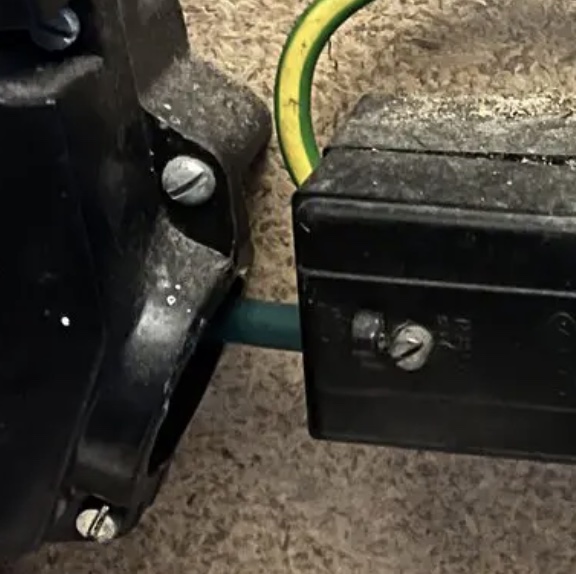

The other long-term reliable company, Wylex, was acquired by Electrium. About ten years ago, some Wylex MCBs started failing (see pic below!) and a huge recall process was launched......
