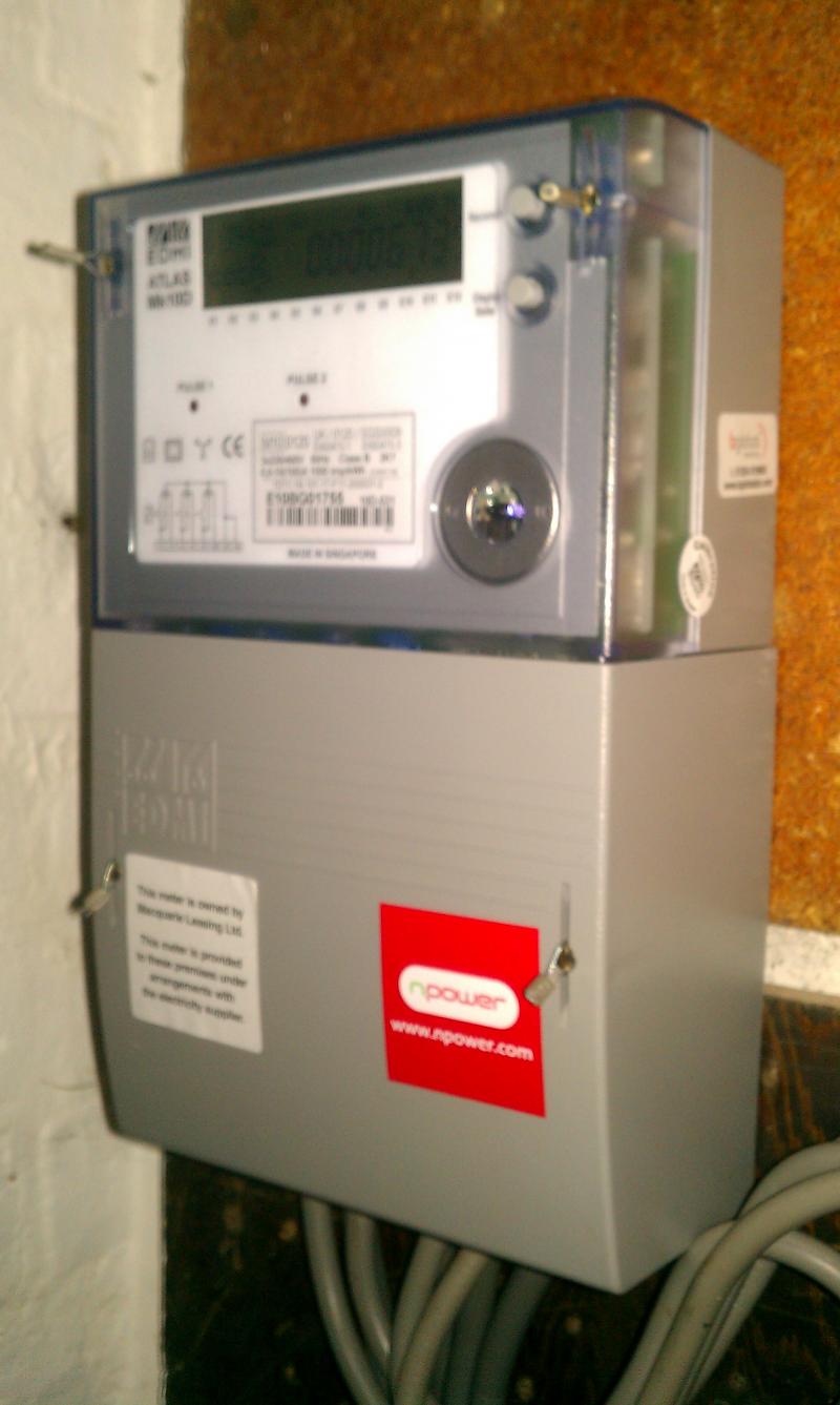

We are a church that has just changed business tariffs from Npower to Eon. We were switched over yesterday and half of our power has gone off!! I have checked all distribution boards and nothing has tripped. However I think I may have found the issue. Our electricity meter is a large dual rate digital one and is branded NPOWER. I have attached a photo of this meter. Is it because the meter still belongs to Npower that our supply is messed up?

It's probably that you were on a dual rate tariff like E10 or E7 (are there storage heaters anywhere?) and someone at your end or Npower or EON dropped a wotsit and you're now on a single-rate tariff.
Much as electricity suppliers might like to be able to do that I'm certain that changing suppliers alone will not be the cause of your problem, even if the meter is marked Npower.
But has anyone been out to inspect or change any of the meter parts or make changes to your electrical circuits?
If not then maybe you should ring your energy supplier and check with them.
If the installation uses a teleswitch and the new supplier does not have the customer as a dual-tariff one then they won't be sending the signal to switch the off-peak circuits on.
We were definately on dual rate and I now believe we are on single rate. No one has been out to do any electric works. Lots of stuff is now flashing on the meter that wasn't there a week ago when I had to do the final readings. It is flashing L1 and L2 and reset. Pushing the buttons on it has no effect. I know some dual meters are radio controlled, could this be the problem as it has now lost the signal from Npower?
Another thing i've noticed, there is a smaller old style anologe meter next to this one that was spinning last week, but now is not, no idea what it is for though any ideas?

You say half of your power is off, I would hazard a guess that you have lost a phase, possibly caused by one of the mains fuses blowing

Will call Eon in the morning. They aren't around now though. Currently not working is around 50% of the lighting, 50% of the sockets the fire alarm system has lost power and so has all of the emergency lighting. We have no storage heaters, all central heating.
That sounds more like you've lost one phase of your supply - it's not a dual-rate tariff issue.

Looks like there are more than two cables going in and coming out of the meter. Behind the lighter coloured ones there appear to be more cables.
If it all worked before the changeover then it does sound like Eon's fault. Although you may want to try N Power as well. Perhaps they have made a mistake during the changeover.
