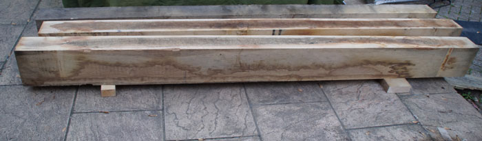

I'm ripping some oak sleepers with a circular saw - cutting from both sides.
Some planks are to be 23mm and some 18mm (20mm and 15mm after putting through a planer/thicknesser).
I'm using a 40 tooth blade which is getting a bit blunt so need to get a replacement.
Would a 12 tooth, 24 tooth or 40 tooth blade be best for this particular application?
If as you say you are "ripping" (which is in fact cutting along the grain of the timber from end to end) then a 40 tooth blade will probably be way too fine, although it does depend on the diameter of the saw blade. Ripping requires large gullets to clear the waste so relatiely fewer teeth are required than for cross cutting. For example a 190mm diameter portable (hand) rip saw will probably require a 12 to 18 tooth blade in order to cut freely, whilst a 230mm saw would be better off with an 18 to 24 tooth blade. Without stating the diameter of the blade it is difficult to give any meaningful answer

Diameter of the blade is 190mm
Before and after images
Wow that's some work for a small diameter blade (fab end result though)......I'd try a 24 tooth blade, wedge the cut open and 'gan canny' with it!

The blade doesn't actually go all the way through from both sides, so I had the option of either getting a heavy 235mm circular saw, or one of these which does the final 10mm http://www.screwfix.com/p/titan-ttb533rsp-reciprocating-saw-240v/17639
The latter means no need for wedging open.
The saw doesn't seem too overworked as the wood seems reasonably well seasoned, but as I have a lot more to 'plank', I want the easiest cut hence the blade question.
Those shown are for a bit of furniture, but I'm planning to make some thinner oak flooring as I can get plenty of sleepers cheaply.
