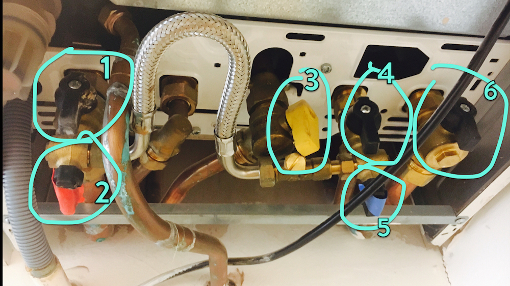

My boiler has dropped below 1 bar, and the pilot light is going out when it hits a certain temperature.
I know I can repressurise the boiler. But I don't know which taps to use.
Please can you help?
Here is a photo of all six of my Ariston ecombi boiler taps. The hot and cold are even colour-coded with tape.
Which taps do I want to be flipping and for how long? (ie. up to 1.5 bar?)
Thanks.
The angle of the picture is awkward, but it looks like number 2 with the red tape on. You will know if you have turned the right one as you will hear water pushing through and the pressure going up. It takes very little time depending on your water pressure if you are just topping up boiler pressure 3 -10 seconds, if you have emptied the system completely by draining the rads down it will take much longer. If you put to much pressure in just bleed a rad off until it drops.
It might be number 1, I can't see where that flexible filling loop is going to, but like I say if nothing happens put the tap back to where it was and try the other.

2+5 as stated above, have you had the boiler serviced recently?? It should be serviced every year by a Gas Safe Registered engineer.
A loss in pressure can mean many things, so if it's doing it regularly, it needs checked.

So, hot and cold?
