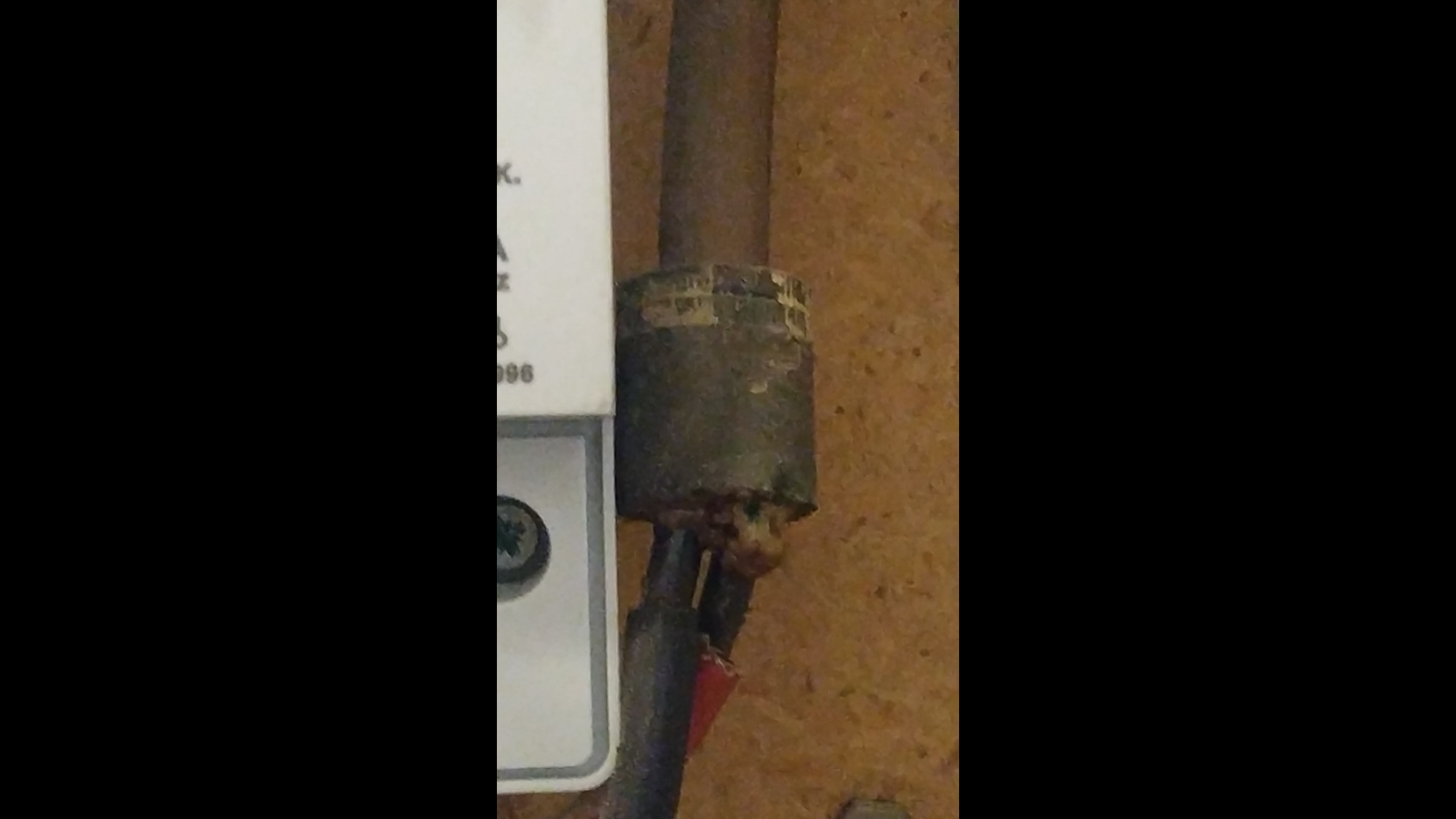

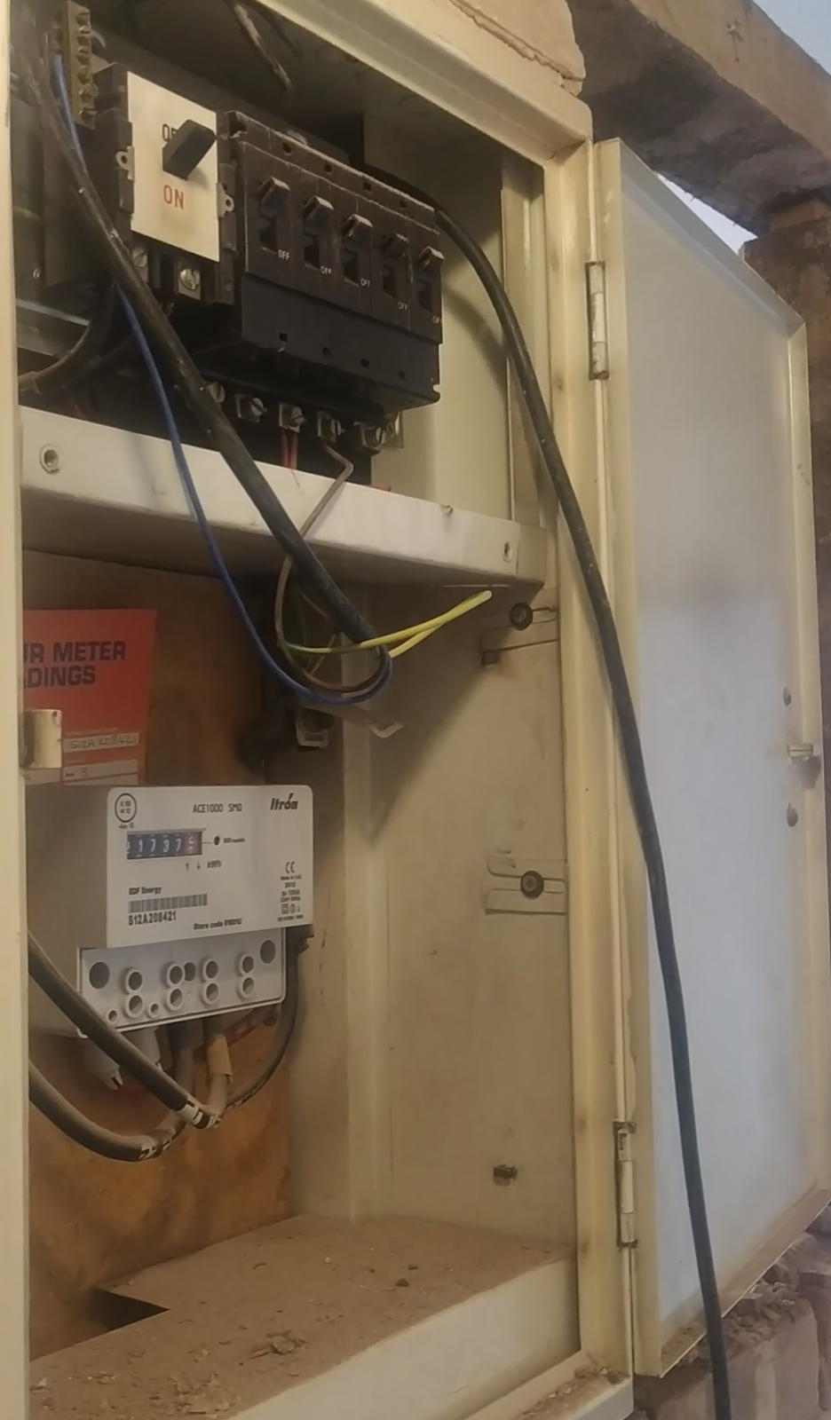

Hello and thanks for everyone's inputs. Apologies in advance for the long post.
The fuse where the service cable starts is located in a cupboard in the building ground hall. My flat is also a ground floor flat and the distance from this cupboard and my flat is only few meters away. Other than the amperage issue I raised earlier, there is a problem with this service cable in that is very old and three electricians have declined the meter repositioning job due to a risk of damaging it, they said the cable will fail when handled. This cable enters my flat above the entry door, it runs through the ceiling joists and has several bending and twists until it descend to the meter (see pictures). The council is opposing the replacement of the cable on cost grounds also claiming that it's inconvenient for other occupants as the power network people need to be involved to disconnect the block (although I spoke to uk power networks twice and twice they told me that's not their job, it's the freehold's job to disconnect the block). The council offered to bring their team to reposition the meter using the same service cable; however, they also said that there may be functionality issues due to the cable not having the right amperage for the flat specifications. The flat is 1 bed and has not electrical UFH. All lighting are downlights 40 in total 30 watts each (not LED - I'm reusing old fittings and I have a stock of old gu 5.3 12v 30w) All the rest is usual domestic appliances. Shower is not electric. I certainly don't want to have functionality issues on a flat i'm renovating! The council ultimately told me that replacing the service cable will cost me 1,5k which is a lot of money for the job. I'd like to hear especially from aptsys where I can learn more about freeholder's responsibility on costs associated to this job. Equally, if I accept the repositioning of the existing cable, will I have functionality problems? Thanks.

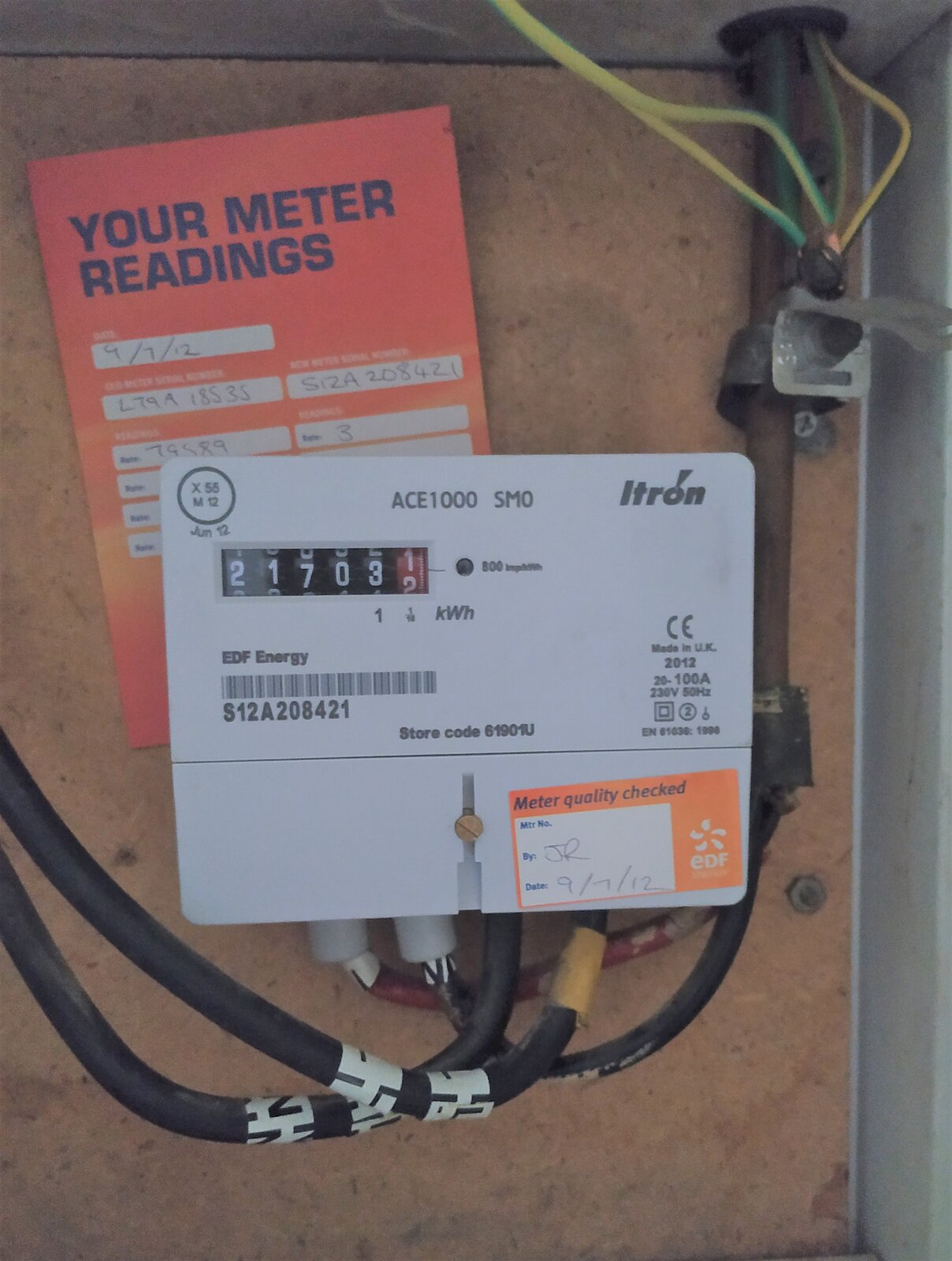

I can't judge the cable condition from the photo, but it's MICC / pyro cable which can run at significantly higher currents for the conductor size compared to PVC insulated cable, provided the terminals can take the higher temperature.
If you can find an electrician with imperial MICC tools and spare fittings it can be reterminated to a proper metal adaptable box and double-insulated meter tails taken to the meter.
The single-insulated cores are not acceptable outside an enclosure and I'm not happy about the earth strap either.

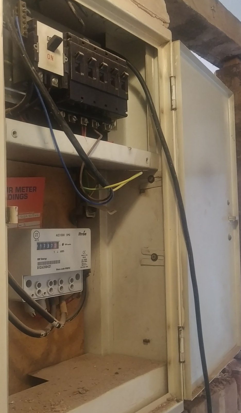

Are there two different meters in the pictures above? One in the "meter room" where the service to all the flats come in, and a second one in your lat immediately before your distribution board? Would it be possible to get a full on picture of the second one above, the one with circuit breakers at the top, and meter (without terminal cover) at the bottom?
I see three pictures of the same meter, 2 of which are without the terminal cover.
Have I missed something else?

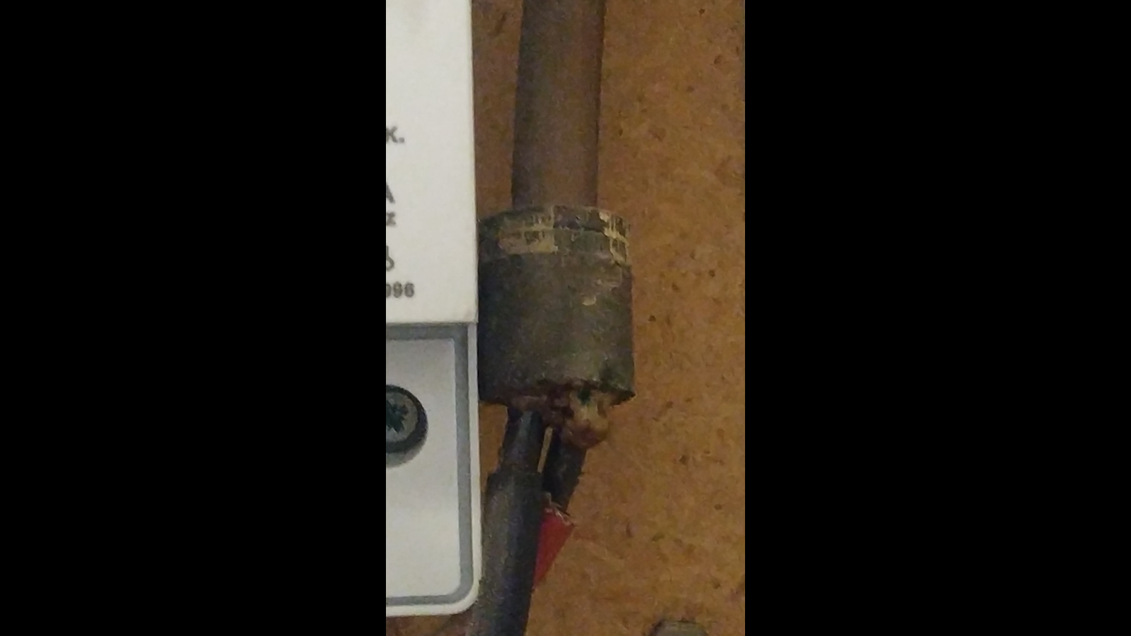

The existing cable is very likely suitable for continued use, provided the ends are reterminated properly.
It won't fail.
The end pot may need to be redone, but the cable itself is pretty much indestructible.
The most suitable fix for what's there is for that cable to be connected into a red link cutout, the meter relocated to the left and new double insulated tails added from the cutout to the meter.
Size of the cable and fuse rating at the other end will also need to be confirmed.
Can you accurately measure the outer diameter of that main copper cable?
