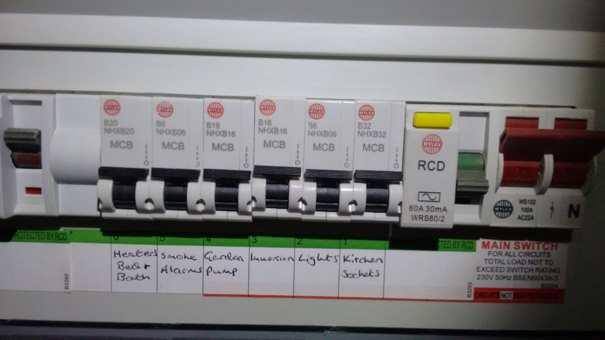

Could you post a photo of your consumer unit clearly showing the circuit breakers and circuit designation labels please.
This is the offending RCD. The only things I know for sure that are working on here are the heaters & the smoke alarms. Not sure about the garden pump as it is for the cess pit & cannot check that.

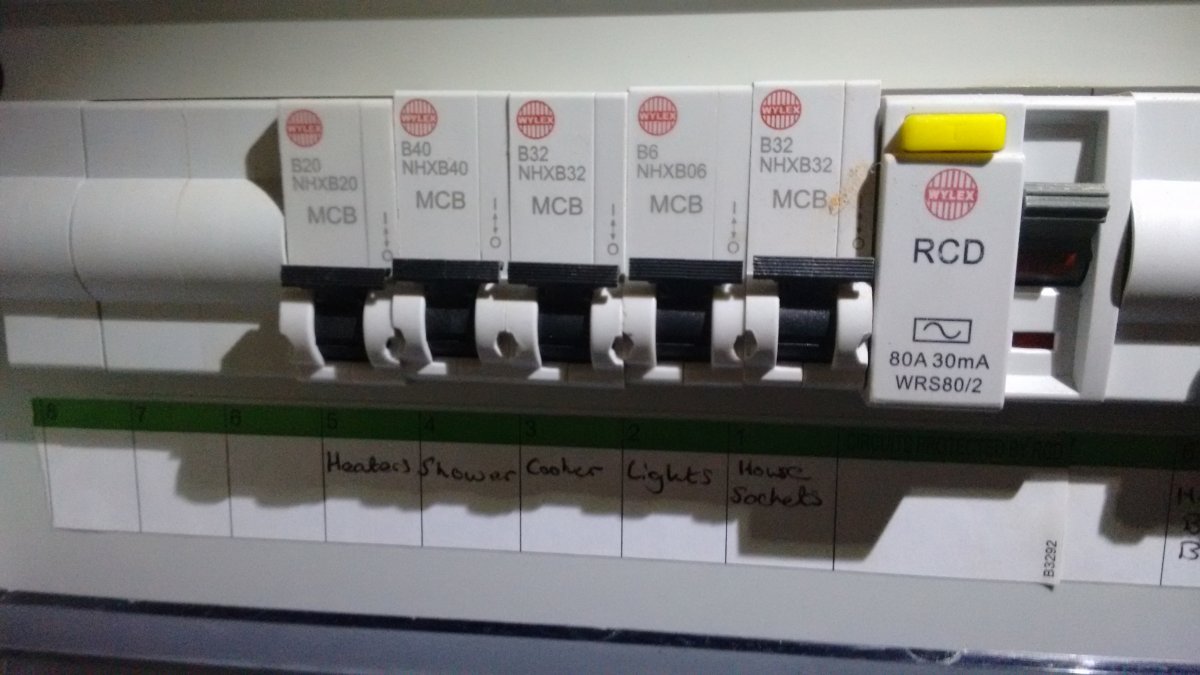

This is the other circuit. This one is not causing any problems & everything on this circuit is working.

Turn rcd back on and see what is working.e.g the lights?
Smoke alarms have batteries too.
And if that doesn't work, turn all the MCB's that are protected by that RCD off.
Turn the RCD on and if that holds then bring your circuits on one at a time to see if they all hold.
If, adopting this approach, the RCD holds then there could be any number of reasons for the trip.
The most to difficult to determine is when a slow build up of earth leakage occurs and something is turned on that sends the RCD over its limit.
One of your bulbs could have blown - so check the lighting circuit for a blown bulb.
I think I would also check the wiring on the outdoor garden pump.
Thanks guys. opened the breakers & flipped the RCD. Flipped each breaker in turn & it is the garden pump (which we cannot get access to as it is for the cess pit) caused it to trip every singe time I put it on!
Problem solved!
