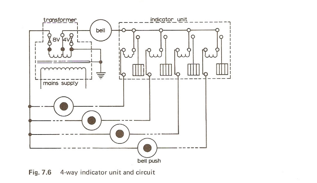

Sorry to 'borrow' this image from another thread which seems to have been locked for some reason, but I'm interested to learn what the purpose is of the 4V tap on the transformer.
Could anyone explain, please?
It's a standard 12 v bell transformer. They have a tap at 4 v so they can be used on 4, 8, or 12v systems. In this case it is used at 8v. Why the earth is on the 0v tap I don't know, it is usually on the 4v tap. There is another type that is 8v with a tap at 3 v enabling its use o 3, 5, or 8v systems.
Very common. Some systems require 8v and some need 12v. These days you often see transformers that have a 24v winding with taps at 8 and 12v.
