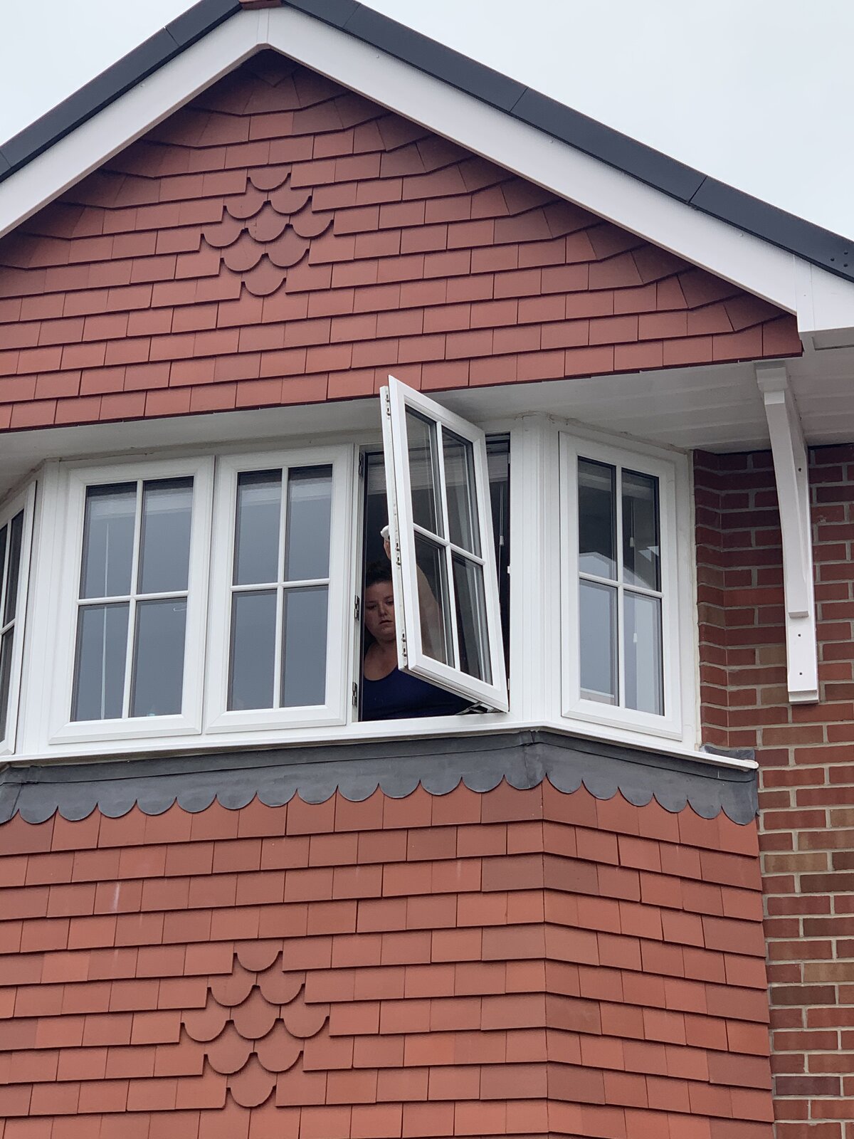

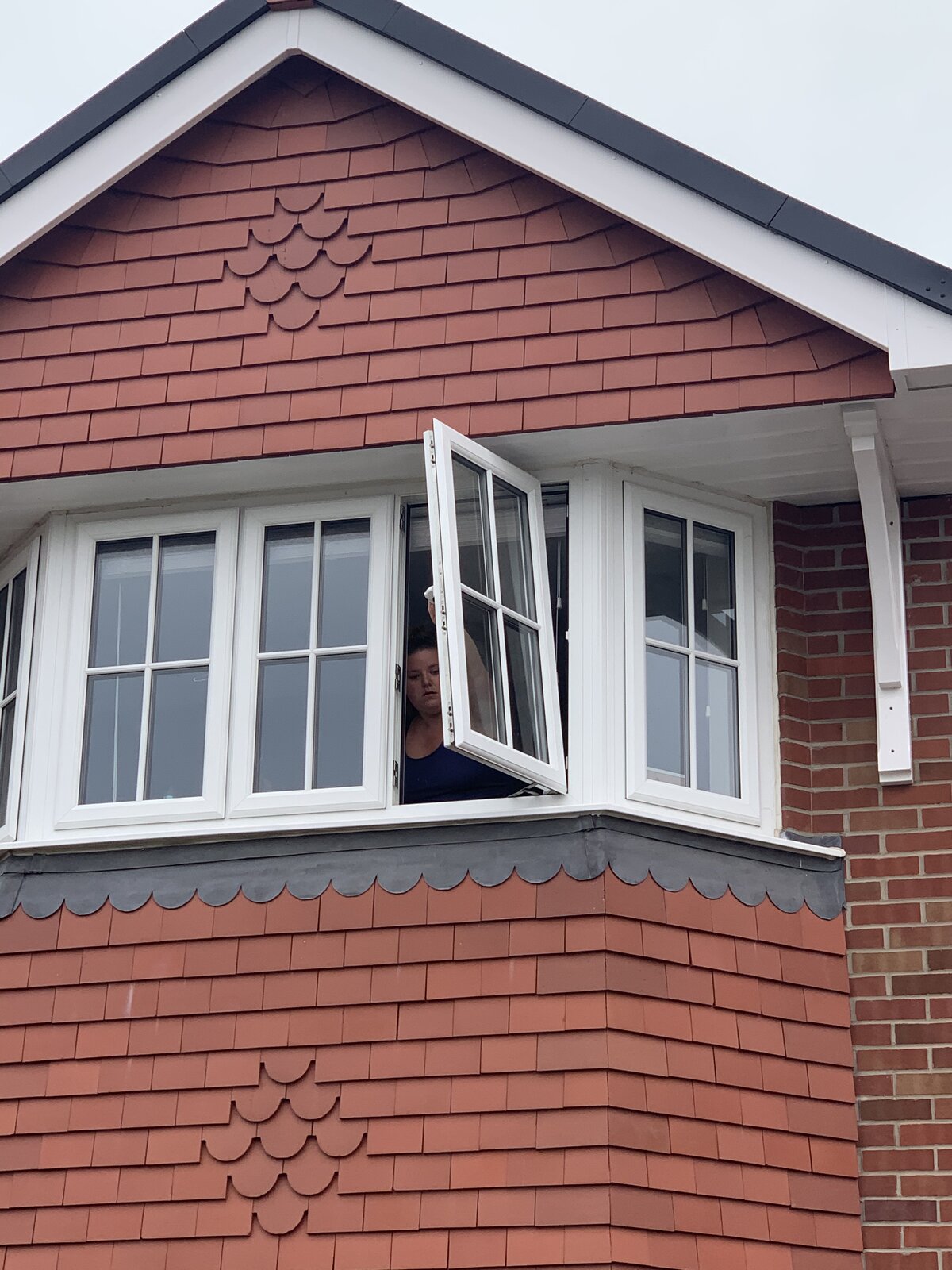

thought the image had attached!
I reckon youve got egress hinges and the top hinge is engaged in its normal place and the other is unclipped moving over
you should be able to unclip the top hinge and slide the window over.
the reason for the 2 positions is it allows the window to slide over so you can reach through for cleaning.
They don’t seem to be clicking back into place
Theres not enough room for me to reset it at the top.
