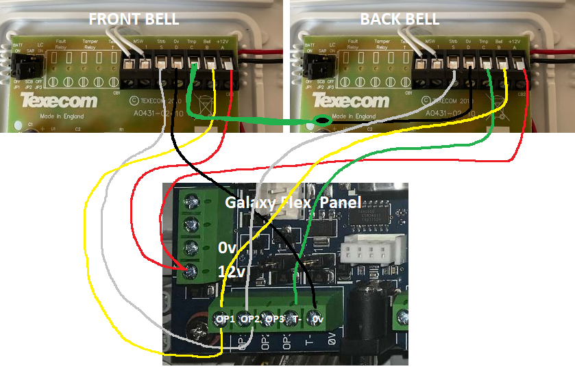

Hi all,
I managed to wire my Galaxy Flex 100 panel to a Texecom Premier Odyssey 1E External Sounder at the front of the house. Have another one for the back to wire. Reading through various old posts I think I have it. Please could some one kindly confirm the wiring for me? Thanks!
Wiring for two bell boxes:

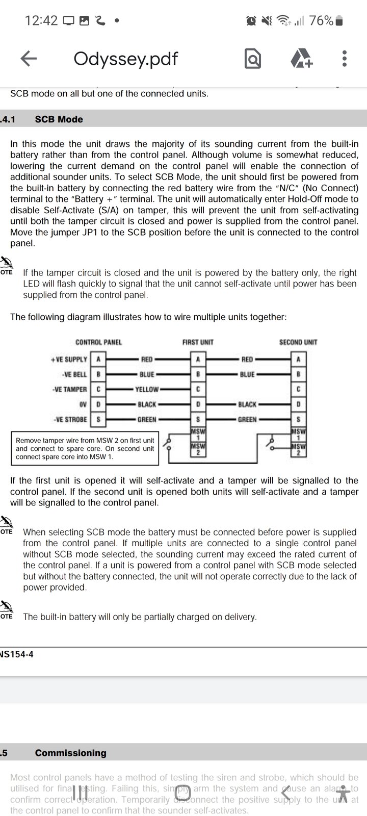

That will work but of first bell tanpers, 2nd bell has no power. Wire as per this picture and set 2nd bell as SCB
