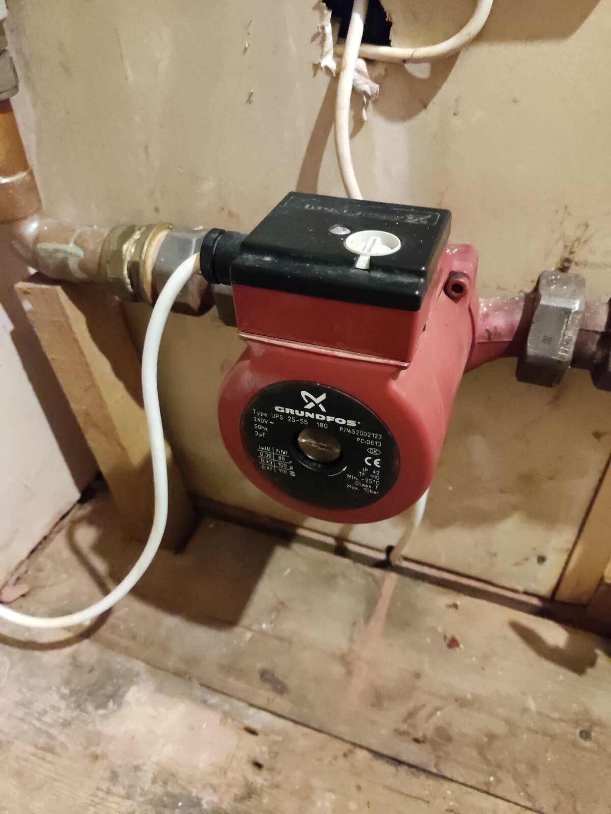

What mode & setting is the circ pump on, if not sure post a photo of the LEDs (if it has them) while running, is it Y or S plan and does it overheat if both DHW and heating are calling?, if the flow temp is rising 30C, from 35C to 65C and the burner is cutting out then looks like a circulation problem.
Hi
The pump doesn't have any LEDs. It's a Grundfos UPS 25-55 180. I'm not at home now but I can send a photo of the switch later.
The boiler does the same cycle with hot water, heating or both on.
Could obviously be the boiler Hx, especially if no magnetic filter installed but you can check out the pump easily enough yourself, even though the impeller is turning the capacitor could be gone weak, it can be checked by using a multimeter if its got the capacitor testing facility or you could simply just renew it. If you have gate type pump isolation valves then (after isolating the boiler/pump) you can shut them and remove the pump head and check the impeller and pump ports for blockage, if the pump isolation valves are the ball valve type then its more than likely that the O rings will leak on reopening which means drain down and isol valve renewal.

Thanks. I think I've added a photo of the pump. I think it's from 2006 so might be worth changing anyway. There's a magna clean on the system but I appreciate what you say about the Hx. Someone is coming to take a look on Wednesday.
