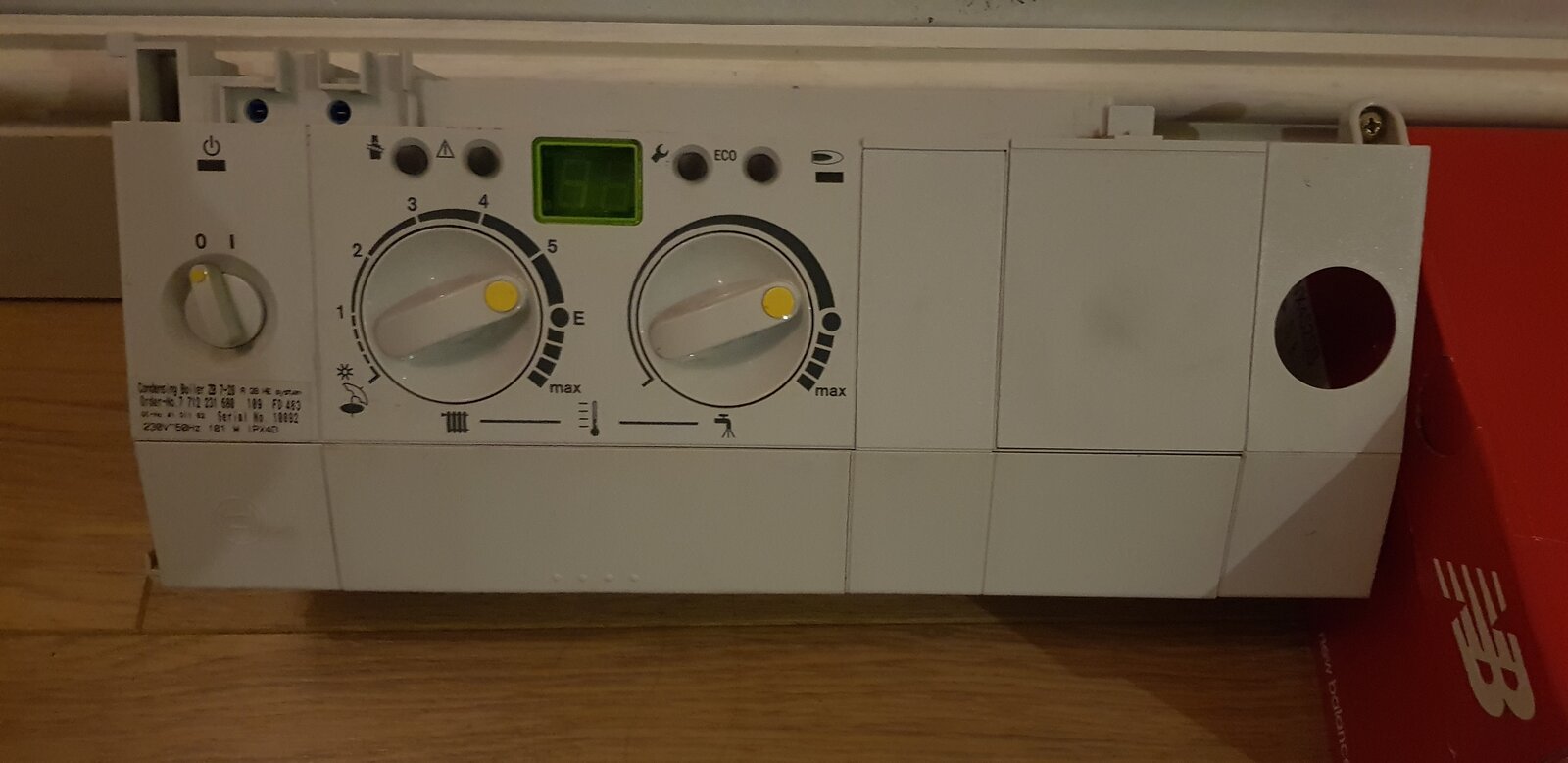

Got hold an a 2nd PCB complete with the dials and everything which I'll swap out as the connectors are spade / slide on. It the whole front panel. Job for next week as want to see how the weekend goes again.

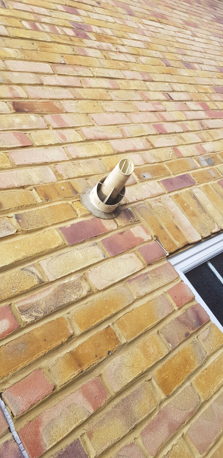

Boiler still showing EA after being on for around 2hrs every morning this week. In the afternoon/ evening had to reset around 10 times most days before it stayed on. Could see the boiler trying to ignite a few times before giving the EA error. BG coming next week for service and mentioned checking gas valve. Also noticed flue is broken - inner part slides out - I slid it back in
Inner flue will give you combustion related issues - EA being one of them
Stop messing about with it and do not even think about BG they are useless, get Worcester out on a fixed price repair, they will sort it and you will get a guarentee with it
