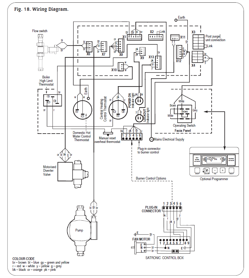

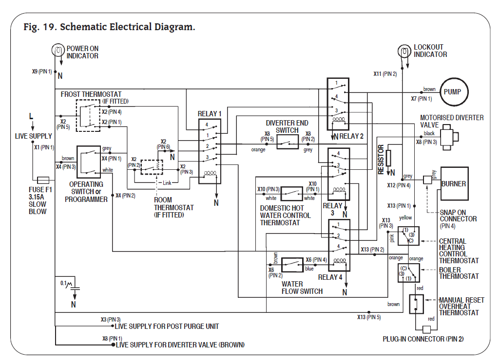

I've got these in the installation manual that came with it:
...if those shed any light on it? I can see they refer to something called a "Post Purge Unit"?
Yes, you have a post purge unit. The motor feed from the control box (pink wire) feeds this unit. This unit then puts a feed back to the motor to run the burner, and this unit also keeps the burner motor running for a period after extinguising. This is what has failed, but at £120 + vat, I would by pass this altogether . Many boilers run quite happily without a post purge and they can in fact be counter productive by cooling down the boiler.

Brilliant! Thanks ever so much for all the help on this! I'll have a look at it at the weekend. Do I just disconnect the pink wire from Pin 3 in terminal X3?
The difficulty with the Worcester unit is that all the connections are multi plug, and without the unit to look at physically, I can't be sure how to overide it. Basically the burner motor is driven from terminal 4 in the base, but this goes into the PPU and drives the motor from the yellow wire, so you need to disconnect terminals 4 and the yellow wire from the ppu, and put the feed from 4 into spare connect in the base, making safe the yellow wire from the ppu as I think it could still be live from an internal connection in the ppu. What confuses me is that the wiring diagram does nt show the photocell or transformer or solenoid coil, but you will be able to see these physically.

The easy way to isolate the post purge is to simply put the motor wire into the satronic base motor terminal and connect the wires to PPU together in the now free connector. Live feed to PPU should be made safe.
