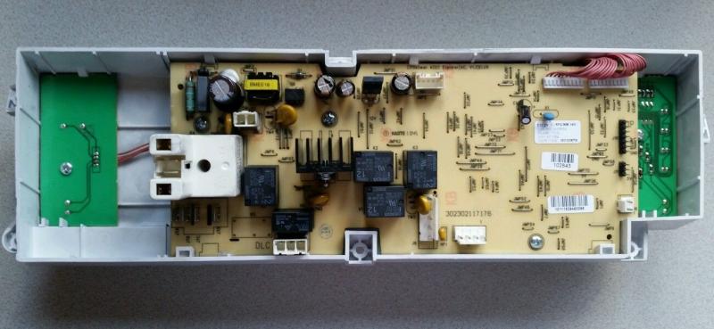

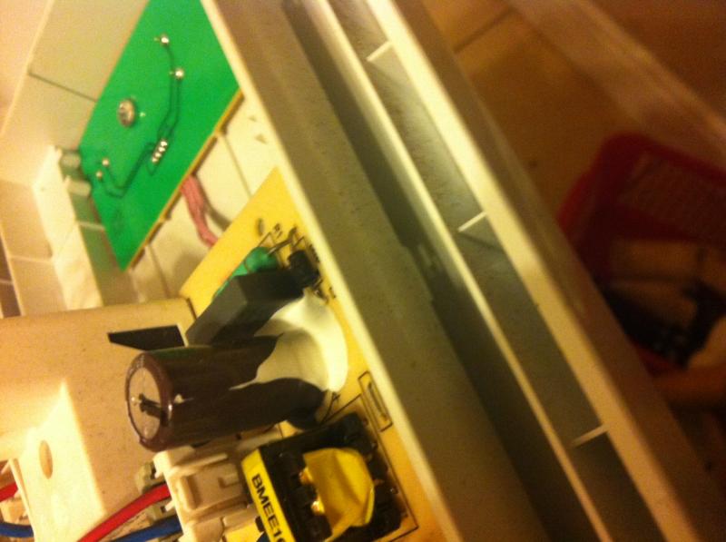

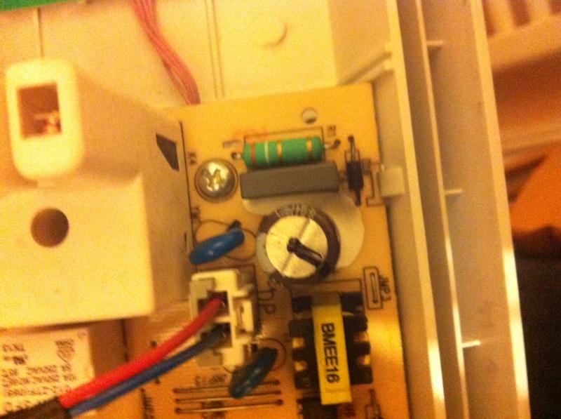

I took the main control board out to look for any bulging capacitors. I couldn't find any with bulging tops but I did find one with white on it and around the bottom.
I'm fairly sure it isn't glue it is a very thin layer and not rubbery.
The spread looks consistent with it leaking whilst in its mounted position.
I've hopefully attached a few pictures. Does it look like it has failed?
Would that be likely to be the cause?
If it has failed can anyone point me to a replacement?
I found the original is made by Lelon.

I also found a picture of the same control board on ebay:
http://i.ebayimg.com/00/s/MTA2NlgxNjAw/z/8bwAAOSwEeFVCXZd/$_57.JPG
Difficult to see but the capacitor in question is the top left one. I can't see any white round that one.
*Update* - Managed to find another picture of the control board which does show some white - is it some sort of glue or is this one failing too:
Does look like glue, quite common to prevent resonant vibrations usually on coils, xfrms etc..
If you want to change it for your piece of mind and cap of the same voltage rating and uF rating will suffice. You can replace with a slightly higher volt i.e if its 16v go up to 25v, the physical size of the cap will be slightly bigger so be sure it will fit, the legs aren't really an issue just diameter and height.
