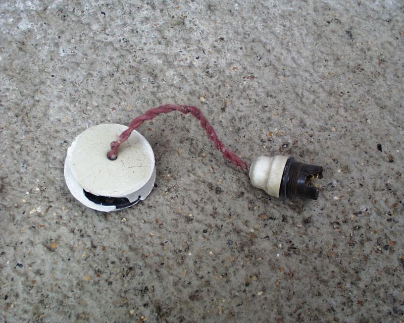

Old pendant set with cotton covered twisted rubber flex. The supply cable to this was white PVC - so this has been removed in the past, and someone just put this 40+ year old fitting back, rather than spend £3 on a new pendant set.
