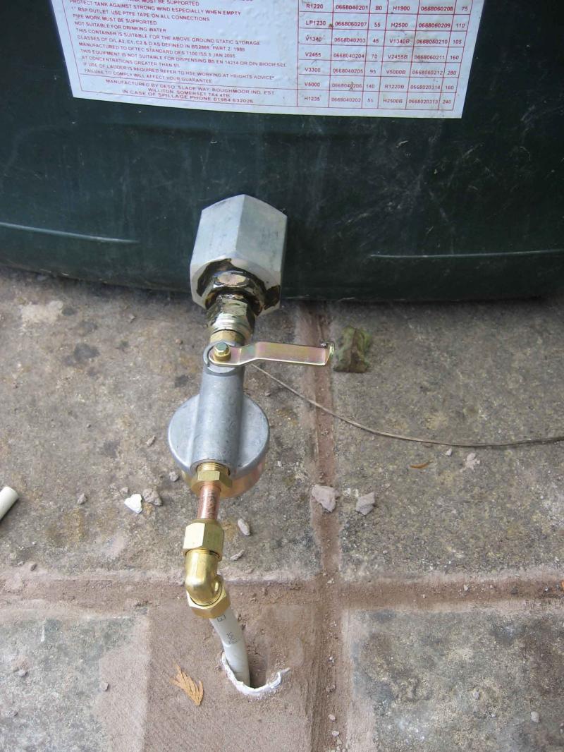

Hi - would appreciate some thoughts/suggestions here.
ordered 2000l of oil for an empty, new 3500l tank - delivery driver turned up on weekend when property unoccupied, and during filling has obviously bodged the empty tank slightly creating a bend on pipework (see photo)
the tank is now too heavy to rotate back the 1/2" or so it needs to be aligned
the guy who fitted it is coming back to have a look, but though I'd post here to get some initial thoughts.

It is possible that the tank may have moved as it was filled with around two tonnes of fuel, plastic tanks can settle in all kinds of unexpected ways.
Are you sure thats not the installers "kick" in the pipe as it enters the hole which seems to veer sideways.

Can you use a level ?.
Stick it on the vertical piece of pipework and see is it plum from the kick up to the compression fitting.

Given a SG of 817.15 @ 60ºf you have had 1634.3 KG of liquid poured into a tank which although fairly robust is not inflexible under the duress of such a weight. This tank is held to the floor with what appears to be 10mm copper pipe and you expect the pipe to remain perfectly square during the operation!
