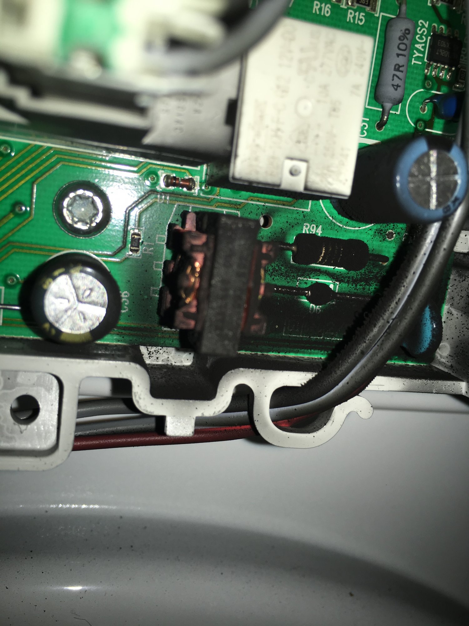

Sorry for rebooting this post but I've recently suffered this issue.
Our washing machine stopped working in that the start button would not start the run but all the lights were working. Having reviewed many howto's I found the error code E51 and decided to purchase new carbon brushes for the motor.
Once they had arrived I started the task of changing these brushes. Just a little help if anyone does want to hear it: the various bolts to undo varied from 8mm to 7mm then came the removal of the brushes. These were crazily 5.5mm and it took me some time to find the right socket. Also the bits I had ordered were shaped slightly different but they still fitted well.
So it was all back together and still the same error. At this point my wife decides to inform me that when it had stopped there was a burning electrical smell. Dah. Now she tells me.
So my attention moved to the PCB. Taking the top off revealed the PCB at the back of the controls and there it be.
It appears a diode has fizzled away and left soot in its place. I was toying with the idea of replacing the diode although I wouldn't know what rating it needed. I then thought maybe the diode was fried for a reason so perhaps best to replace the PCB.
£143 from AEG??? Off to online auction site and second hand one for £30. Here's to hoping this works.
