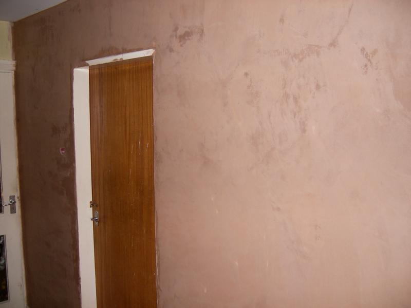

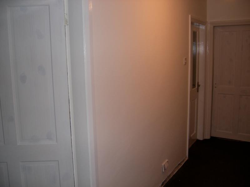

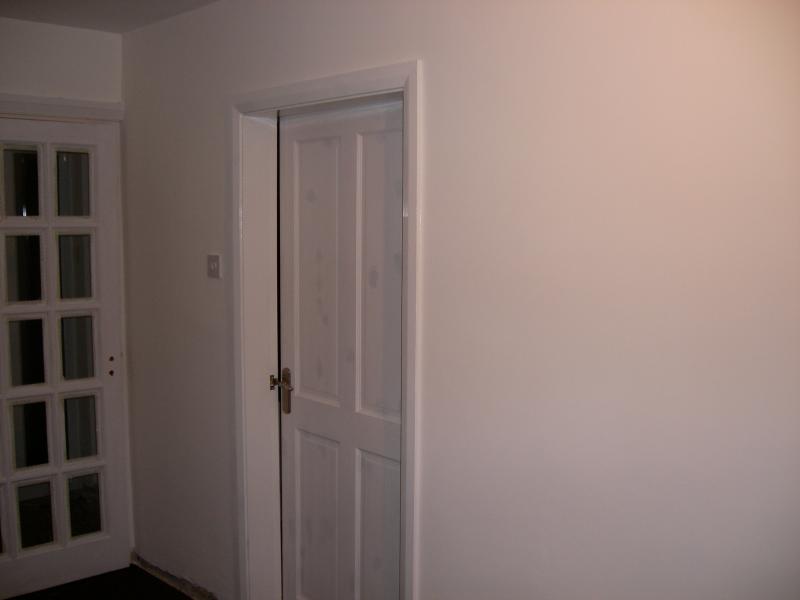

JR's post the other day prompted me I'd not posted anything in a while ;)

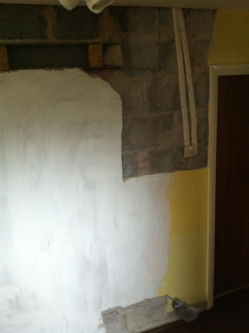

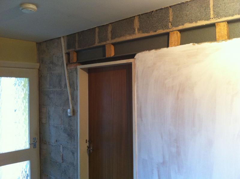

Just finishing the hall, and whilst it is not a massive achievement by pro standards, I am pleased with it because it had a mixture of things to consider, and techniques I've learnt over my time on the forum from you guys.
With the steel beam in there, there was some work with plasterboard.
I filled with float & set the bare block areas, and the whitewashed area on the left of the 2nd pic was new plaster - but about 3/4" inch out from plumb (where the builder had blocked up the old internal window) so I built it back level with the rest.
The yellow paint areas were old plaster underneath and a nasty shiny emulsion from eons ago, which is not fun to skim over.
Finally the reskim after taping all the joins brought it all together. :D

Nice work there.

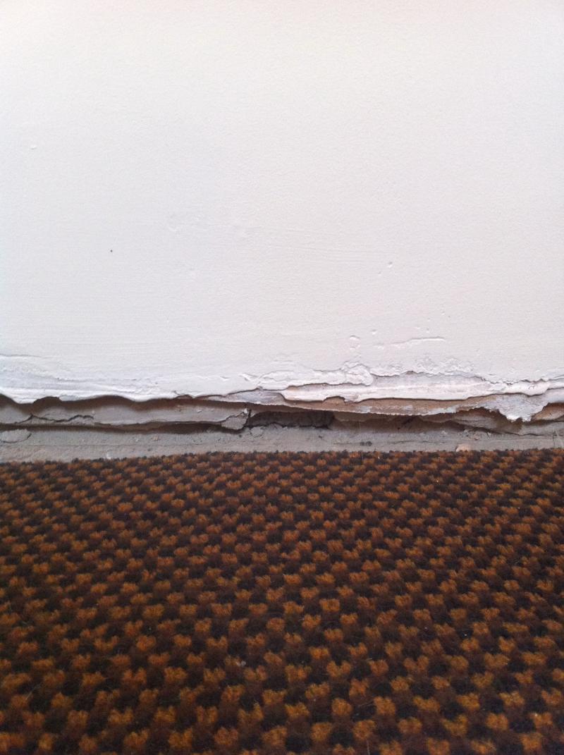

I have got one question I found when I was doing this bit of wall.
Still struggling to get a tidy finish at the bottom and still leave a gap to the floor.
I think on a previous post a long time ago someone suggested fitting a strip of wood and work to this, which can also help fitting skirting later.
However, in this case, I was only doing a short length and building on top of previous layers (not starting from brickwork).
I know it will be hidden by skirting, but I'd like to improve technique.
looks fine to me mate aslong as you ran the trowel accross is (from side to side) as to make sure theres not a ramp at the bottom and flatten off any snots (obviously you do this while the plasters wet still)
