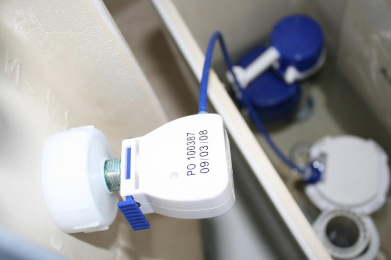

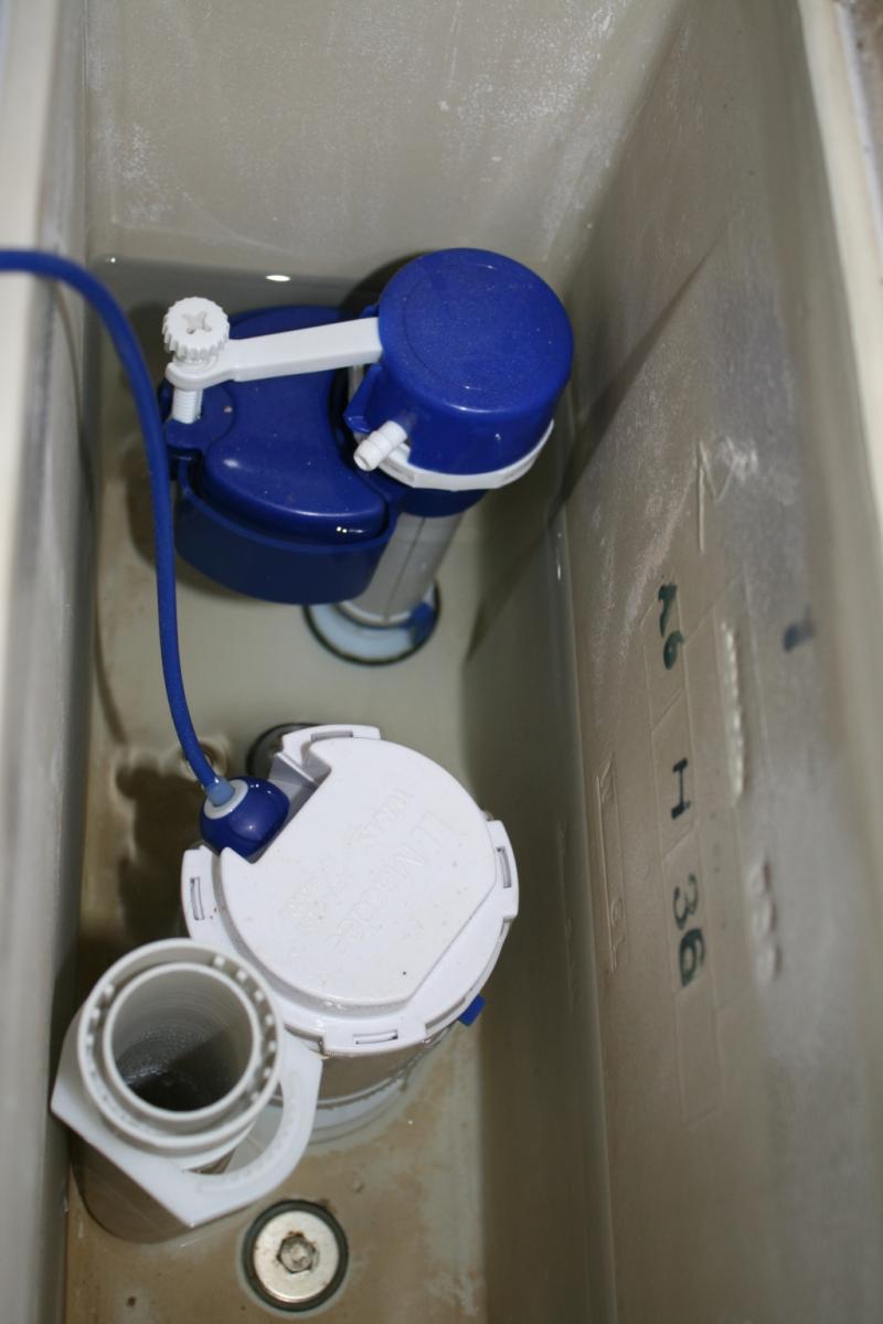

Hi folks, I hope you can help.
I've been noticing a constant trickle of water running down the back of the toilet bowl for the last month or so, it comes down in four separate places along the back.
I've enclosed shots of the cistern and the "plunger" part attached to the lid via the blue tube and was wondering if you kind folks wouldn't mind taking a stab at what the problem might be and how to solve it. I've heard this could be something to do with the tube or a washer somewhere on the assembly, but I've no idea really :(
When I leave in the morning the cistern is at the max fill (6L) marker, however when I get home it's sat at the minimum marker (4.5L), what I find a bit odd is the fact that the plunger doesn't kick in to fill it back up as on the old "ball" cisterns the more the level dropped the more it would put back in....
Ordinarily I wouldn't bother about it as it's not doing any harm (leaking inside or overflowing outside etc) but I wonder how much this constant stream is costing us given that we're on a metered system!
In your first picture there is a big white bit and a big blue bit, you need to replace the big white bit, there is a seal at the bottom which has perished.
Not the best description i grant you, but i hope it makes sense.

That's the macdee arcadia DVA series flush valve.
Check the seal at the bottom of the valve sometimes cleaning them of scale can stop them passing water into the bowl.
turn the valve 1/4 of a turn will dismantle the top of the valve from the base so you can gain access to the seal at the base.
The reason it is not refilling is that, possibly, the inlet valve is one of the new generation of eco-friendly valves that is designed not to open until the water drops to a certain level.
The Torbeck Eco-fill is one such valve.

seco services - I was hoping it would be something like you've suggested. Unfortunately some moron has completely blocked in the back of the toilet (as it looks good, until something goes wrong...) so I can't get under the cistern to replace any of the "uprights" without breaking away all the tiles :( Would I have to turn off the water before I turned the "lid" and removed the valve?

Isolate the water supply.
flush toilet.
then hold the flush valve at the top near the cable and twist 1/4 of a turn,
that will dismantle the top part from the bottom.
then you beable to see the rubber seal.
Just for clarification that is the big white thingy

Mystery solved I think, but it has now revealed a new problem!
When I came to take off the Macdee AFV40100 flush valve (which I thought separated at the top not the bottom, took me a while to figure that out!) I noticed some sealant had been applied near the bottom of the valve casing.
When I got the valve off I looked at the seal itself which seemed to be very clean and pliable but it was covered in bubbles which I thought was a bit odd. When I came to put the valve back on I sussed out why there was sealant, as with everything else in this house a bodge has taken place due to them breaking a lug off one side.... :rolleyes:
I can only guess this is where the water is coming from, I saw a whole replacement unit in B&Q for £15.99 which looked to have identical fittings, could I replace just the valve that I removed with another version (rather than the base as well, as if that needed replacing I wouldn't bother), are the bases on them a universal fit?
Any help much appreciated, I looked for an identical Macdee unit online but had no success.

Here is what to do:
Remove the whole MacDee unit with a quarter turn anti-clockwise as described earlier in the thread. You will notice 4 backets on the top of the big white sealed cyliner. You can carefully pop this open with the base of a tea spoon (being careful not to crack the unit).
Inside you will see its a very, very basic design with what is effectively a bicycle brake cable from the push button unit, pulling on a little pully device which lifts the plunger at the base. The trouble is that the pully /plunger assembly is on 2 guide rails on the inside of the unit and it gets stuck and gravity can't pull it closed after you press the button.
Here's what I did:
I cleaned the guide rails with some tissue and smoothed them down so any limscale residue and gunk was gone. I then sprayed a load of WD40 onto the guide rails and the pully mechanism and then pulled on the cable repeatidly to get the WD40 to move around and do its buisness.
(Maybe this bit was overkill but I also disconnected the cable on both ends and cleaned the visible parts - the was some gunk and, after taking the spray diffuser off the WD40 can I forced a whole load of WD40 down inside the cable sheath - again pulling the cable a couple of dozen times to move the WD40 around.)
It has been perfect ever since.
I fully expect it to go wrong again in a few months but 5 minutes of diy and a couple of squirts of WD40 later it will be sorted, and that's better than spending £15.99 on another piece of potentially defective plastic.
