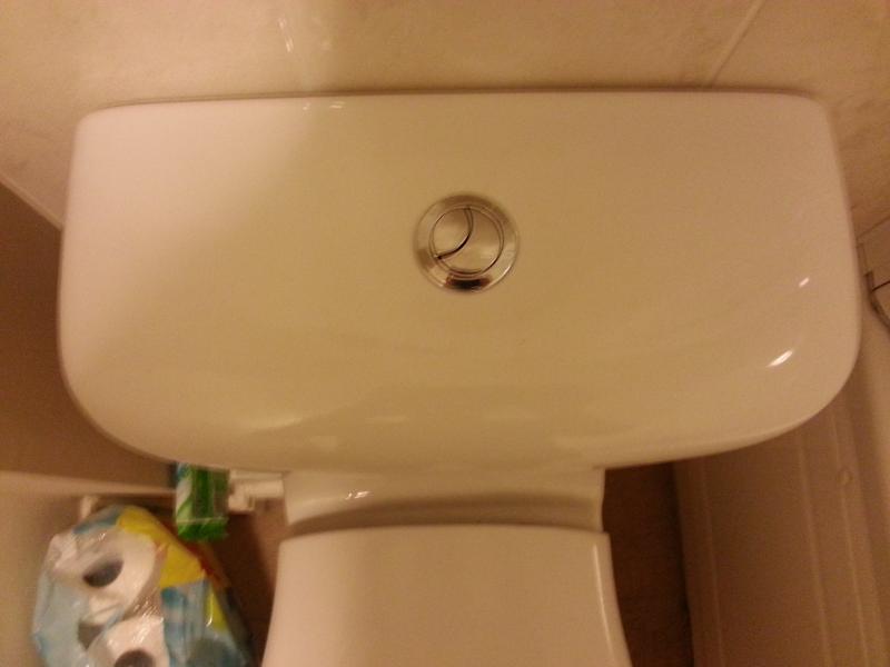

A homeowner with a push-button Ideal Standard toilet noticed that after a routine flush, water kept running steadily into the bowl. It wasn’t a full-flow gush – more a constant trickle, loud enough to hear from outside the bathroom. The toilet had worked fine for years with no issues, and this started out of nowhere. No one had touched the internals or changed anything.

Ideal Standard cistern showing fill valve and push-button flush mechanism

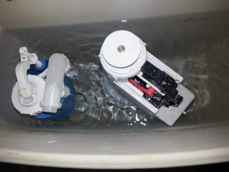

  • Lift the float by hand. Take the cistern lid off, flush, and as the cistern refills, gently lift the float arm or cup all the way to the top. If the water stops flowing in, your fill valve is basically working but the float may not be rising high enough or the water level is set too high. If the water keeps running even with the float fully raised, the fill valve diaphragm or washer has failed – it physically can’t shut off the supply. That’s your answer right there.
  • Check the cistern water level. There’s usually a moulded line on the inside wall of the cistern or on the flush valve body itself. If the water is sitting above that line or pouring into the top of the flush valve overflow tube, the fill valve is overfilling the cistern. The flush valve is just dumping the excess.
  • Look at the flush valve seal. With the cistern lid off and everything settled after a fill, watch the water surface. If it’s slowly dropping even though the fill valve has shut off, water is creeping past the flush valve seal. You can sometimes hear it – a faint hiss or see a slight ripple at the base of the flush valve.
  • Check for debris. Especially in hard water areas or after any mains work, a tiny grain of grit can lodge under the fill valve diaphragm and hold it open. Sometimes just dismantling the top of the fill valve, rinsing the diaphragm under the tap, and refitting it clears the problem completely. Costs nothing.
Close-up of Ideal Standard cistern fill valve and float mechanism
The Proper Fix – Good, Better, Best
Good – replace the diaphragm or washer. The fill valve has a rubber diaphragm or washer that sits under a large plastic cap on top of the valve body. Unscrew that cap, pull the diaphragm out, and take it to a plumbing merchant to match it up. This is the cheapest fix – a couple of quid at most – and works well if the valve body itself is still in decent nick. The catch: on older cisterns, the exact diaphragm can be discontinued, and a near-match often doesn’t seal properly. If you can get the right one, it’s a five-minute job.
Better – fit a complete replacement fill valve (like-for-like type). If the diaphragm isn’t available or the valve body is scored or calcified inside, swap the whole fill valve. Isolate the water supply to the cistern (there’s usually a small isolation valve on the feed pipe beneath or behind the toilet), flush to empty the cistern, disconnect the supply, unscrew the back nut, and swap the valve. A replacement bottom-entry fill valve runs around ten to fifteen pounds. Make sure you match the entry point – bottom entry or side entry – to your cistern.
Best – fit a quality universal fill valve with a brass shank. Something like a Fluidmaster bottom-entry fill valve with a brass thread is the go-to for most plumbers. The brass shank gives you a more reliable seal against the cistern body and is less prone to cracking or cross-threading than an all-plastic version. It’s adjustable for height, the diaphragm is a standard replaceable part, and it’ll outlast most budget alternatives. Around twelve to eighteen pounds from any plumbing supplier. If you’re already under the cistern with a spanner, it’s worth the extra few quid for something that’ll last.
If the problem turns out to be the flush valve seal rather than the fill valve, you can usually just replace the doughnut washer on the flush valve – lift the valve out (quarter-turn on most modern types), peel off the old seal, fit the new one. A couple of pounds and ten minutes.
