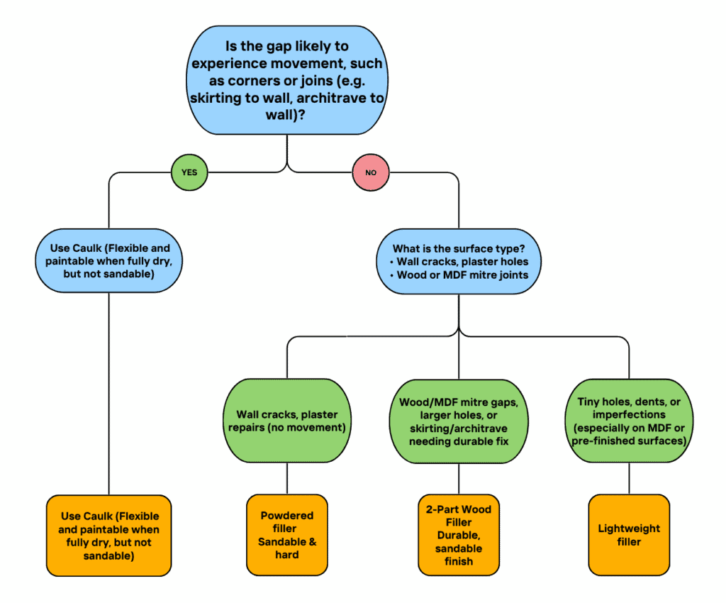

Key features of Caulk and Filler
- Filler: Filler sets hard, ideal for static repairs like cracks in walls or dents in woodwork. Filler can be sanded smooth and painted once dried.
- Caulk: Caulk remains flexible, so it is best for areas where some movement can be expected, e.g. along skirting boards or around architraves. Caulk can be painted (once fully dry), but not sanded.
Filler is better for repairs, and caulk is best for finishing.

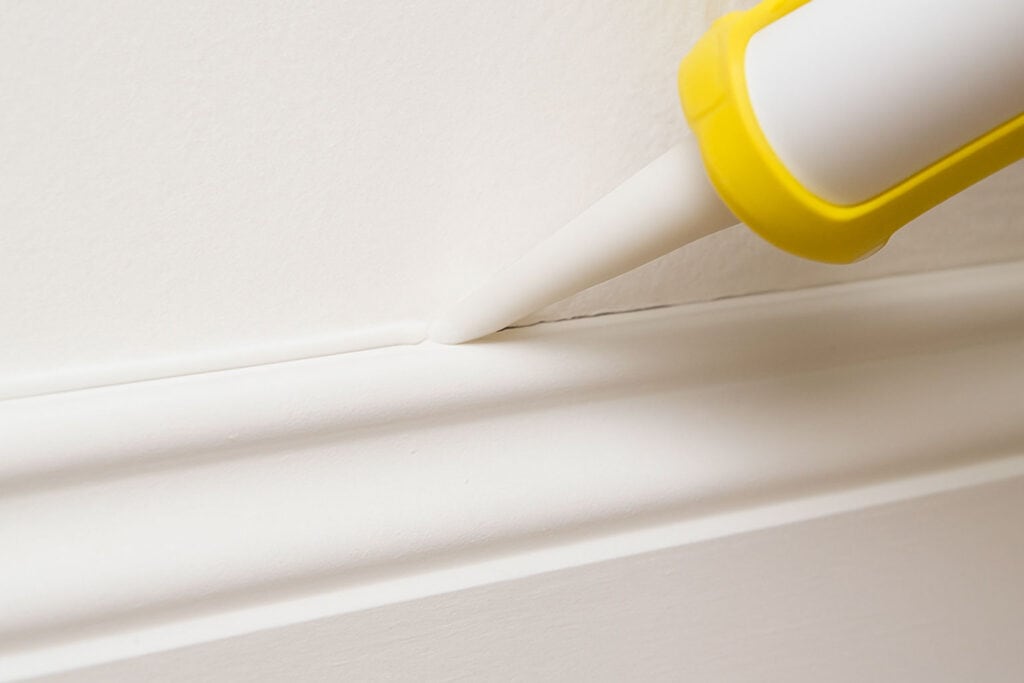

When to Use Caulk
Caulk is ideal for sealing thin gaps, like those between a wall and a skirting board or architrave, where slight movement occurs over time. It’s also suitable for corners, ceiling coves, or between stair stringers and walls. Decorators’ caulk is designed for interior use and is overpaintable when fully dry.
That said, decorator’s caulk does shrink slightly and can’t be sanded. If you paint it too soon, the paint won’t adhere properly and may crack; therefore, it’s essential to allow it time to dry thoroughly. Everbuild 125 is a solid, reliable option for this type of work.

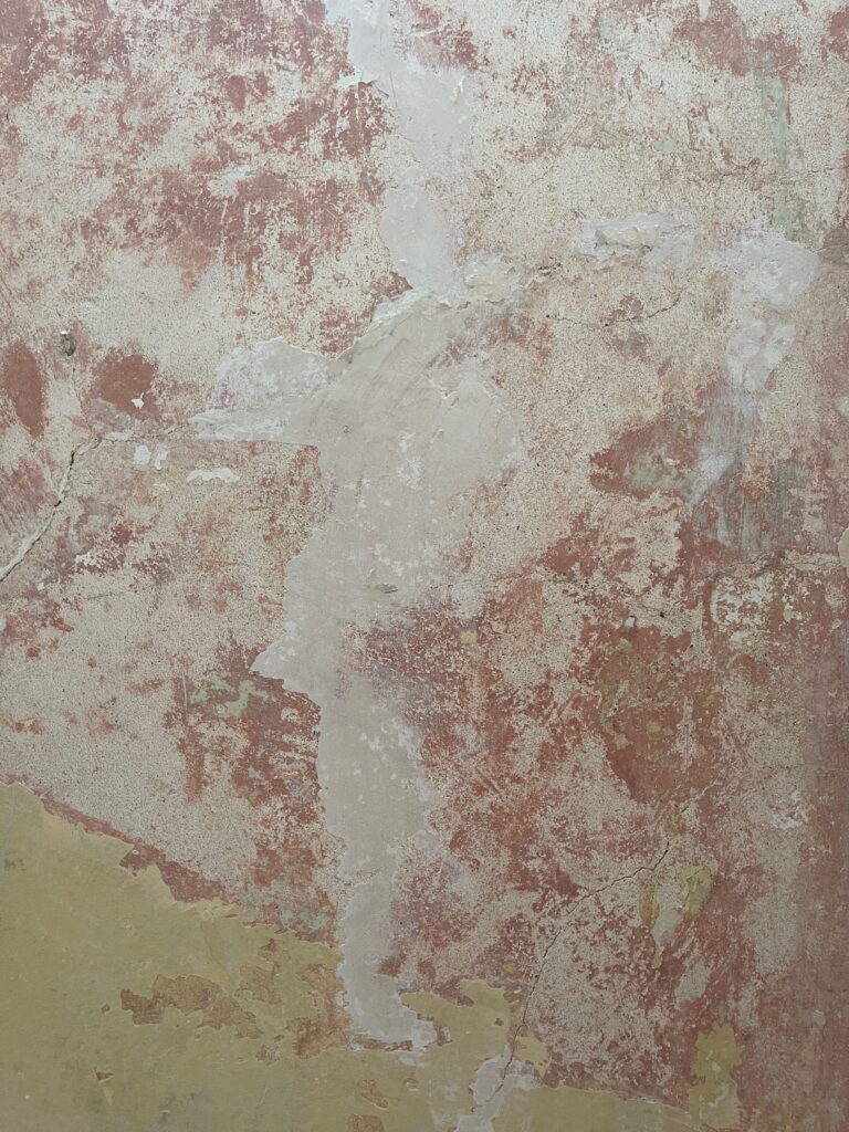

When to Use Filler
If you’re fixing dents, gouges, or cracks in plaster, wood, or MDF, then filler is the best thing to use. Unlike caulk, it hardens and can be sanded to a flush finish. For deeper cracks in walls or ceilings, a powdered filler, such as Polyfilla or Tetrion All Purpose, can be used. This type of filler should be pressed into the gap and sanded flat after it has dried.

Caulk or Filler for Skirting Boards?
- Top edge gap to the wall: Use caulk.
- Dings or dents in the board: Use filler.
- Mitre joints at corners: Use a two-part wood filler for larger gaps. For finer cracks, it’s best to use a lightweight filler.
