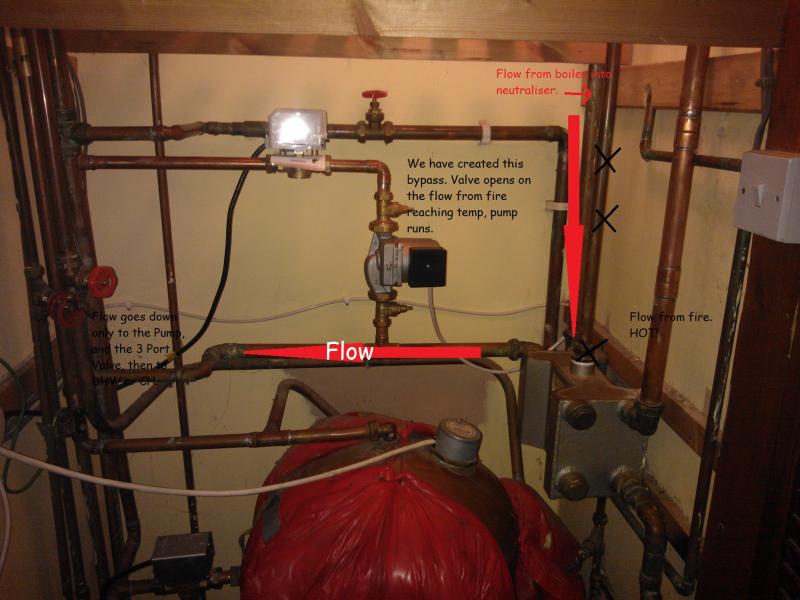

The flow comes into the neutraliser at the back from the boiler and leaves on the left hand side at the back. We installed the boiler and the new system was upsetting the way the pump and valve operated, causing water to kettle as the Stat on the pipe for the Wood Burner shut down the pump for some reason. Problem is rectified with this bypass.
Dunsley Baker Neutralizer
