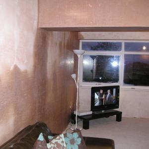

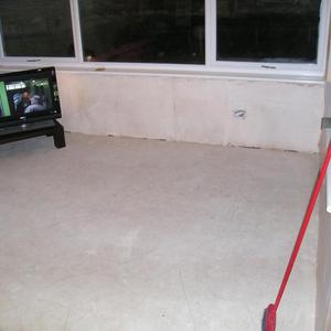

walls in and their telly lol

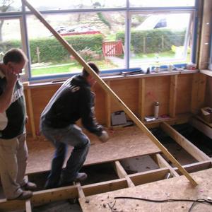

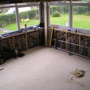

floor in and walls insulated

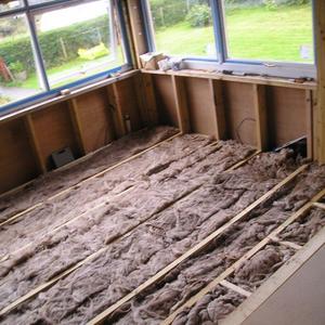

floor insulated
floor insulated

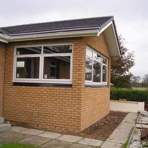

windows in ready for cills

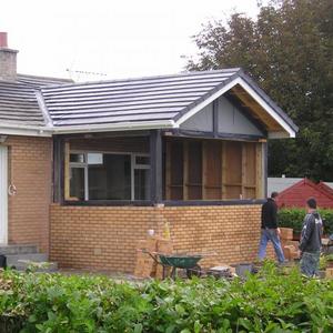

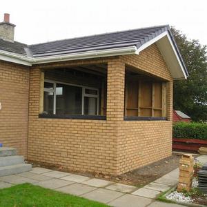

  • Reaction score 0
  • Comments 2

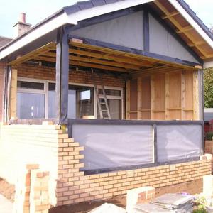

brick work complete
brick work complete

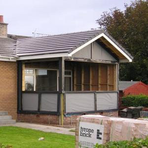

nearly ready for windows

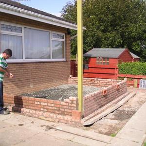

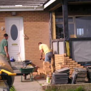

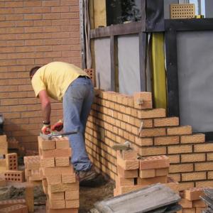

brickwork started
brickwork started

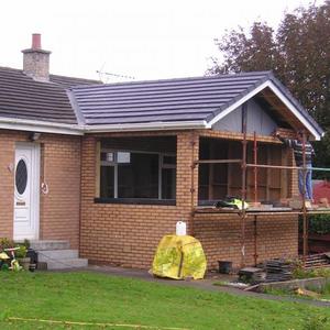

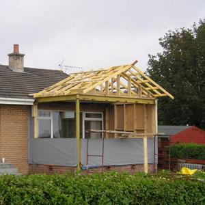

roof tiled, facings and barges
  • Reaction score 0
  • Comments 1

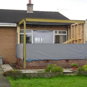

roof trusses up
roof trusses up

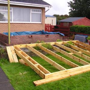

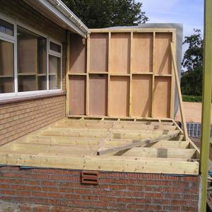

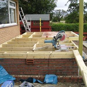

147x47mm framing
147x47mm framing

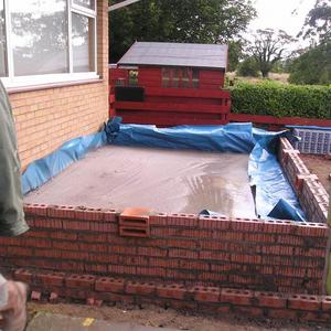

100mm concrete solum,1200 guage dpm

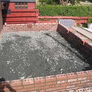

150mm hardcore
150mm hardcore

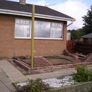

found walls
found walls
  • Reaction score 0
  • Comments 1
start of found walls and steel post

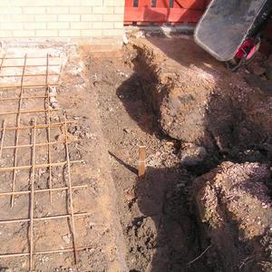

a193 hys steel mesh
a193 hys steel mesh
