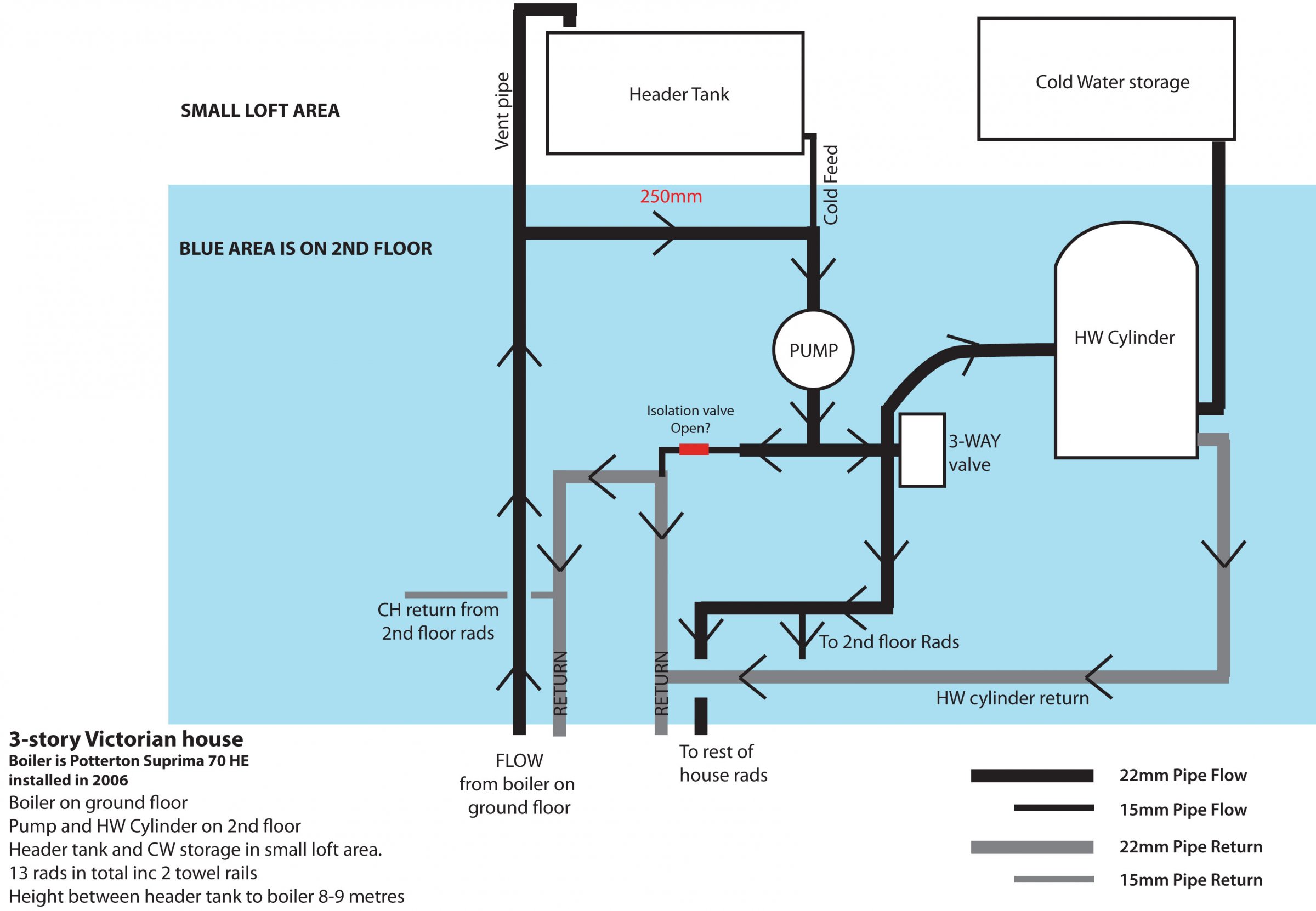

It use to be 150mm between vent and cold feed
D
Id also probably just combine the cold feed and vent and take a 22mm pipe into the bottom of the tank. This prevents pumping over etc. But bare in mind, this can only be done if the boiler has an overheat stat.
