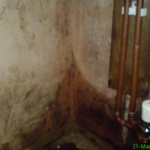

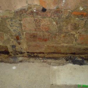

The lower black line is the pitch DPM. As you can see, the screed here caused a bridge.<br>The damp line rose to just under a metre but is now reducing in height to approx 600mm over the past two weeks.
