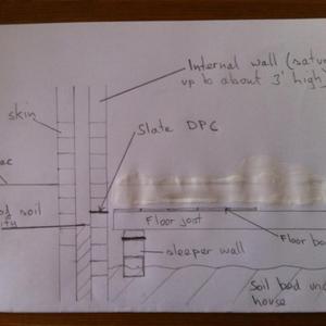

Hi,
Did you ever managed yo sorg out you damp issues? looking at the picture attached it appears that your external ground level are too high and that it should be at least 150mm below the damp course.
i have a similar problem and i think thats the root of the problem.
Anyone got any further advice on this?
