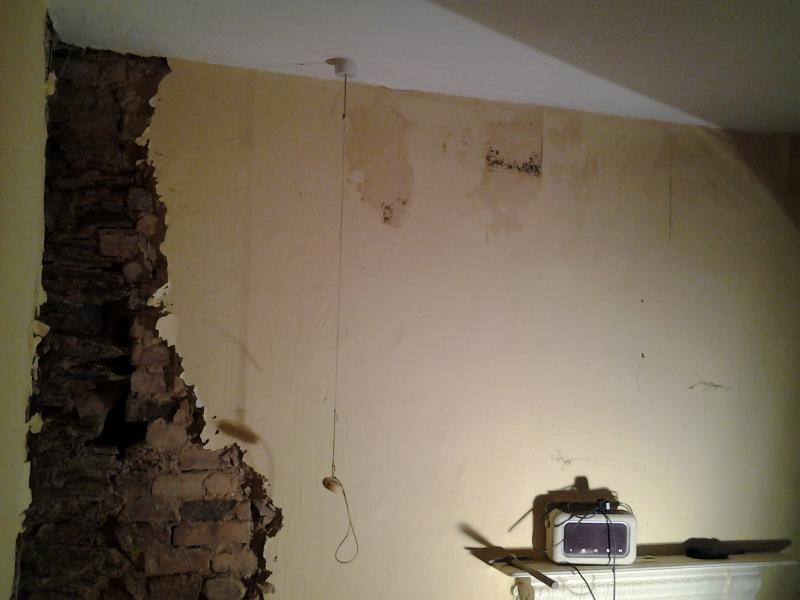

This is where the lath and plaster wall meets the gable wall .So the lath and plaster wall is getting damp aswell. My plan was to hack the olaster off the back wall and cut the laths that hung over the last stud, and run my poly sheet thru till it met up with the stuff I put into the back bedroom .
