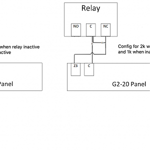

Showing options for a relay driven input for galaxy G2 panels. This zone can be configured to keyswitch type. 2k when set 1k when unset. The option for both active relay set or active relay unset are shown.
