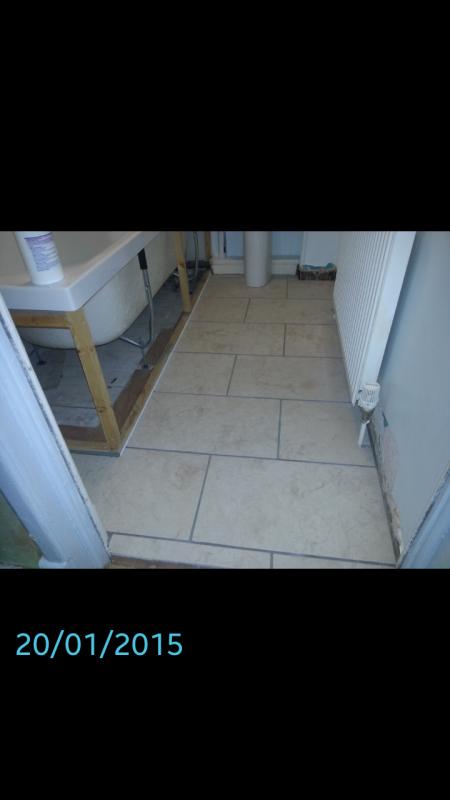

this is my finished job after laying 6mm no more ply cement boards with the adhesive and screwed to the floor with a LOT of screws just to be sure then i layed the tiles with flexible tile adhesive and finished with some mapei grout... not bad for an amateur
