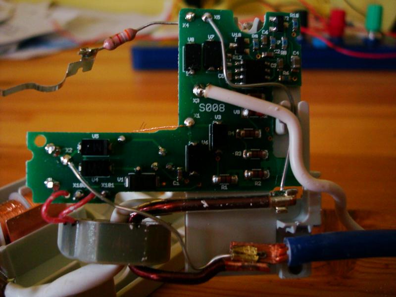

potential for dead short ?
Yes that is the phase (white sleeved conductor) and neutral (lacquered copper conductor) squeezed into a current transformer. <br>The white sleeving on the phase looks like it might be thermally robust.
RCBO AUTOPSY
