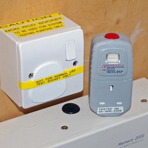

Tst socket.
I wanted a dedicated test socket. This one is located just above the main CU and is connected to the non RCD side of my split load CU. I can use this to test any RCD adpators.
